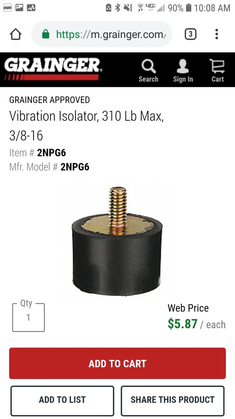

Swapped a rubicon 241 transfer case and had to use spacers to raise the trans up for the mount to clear the tcase. Was thinking of putting in a Barnes 4wd 2inch drop skid plate and bolting the trans directly to it using insulators like these.
Any experience or thoughts with something like this?

They are typically fairly robust without much isolation. Won't hurt to try. The only thing I know about isolators based on how many different versions I've built over the years is I don't know shit about isolators.
I see the have compression weight ratings and lateral weight ratings. The one I posted is similar in specs to the ones that Nth degree use in their lopro mount. I was thinking I could use either 2 or all 4 mounting holes in the trans with these. Having trouble finding them in 7/16 though
