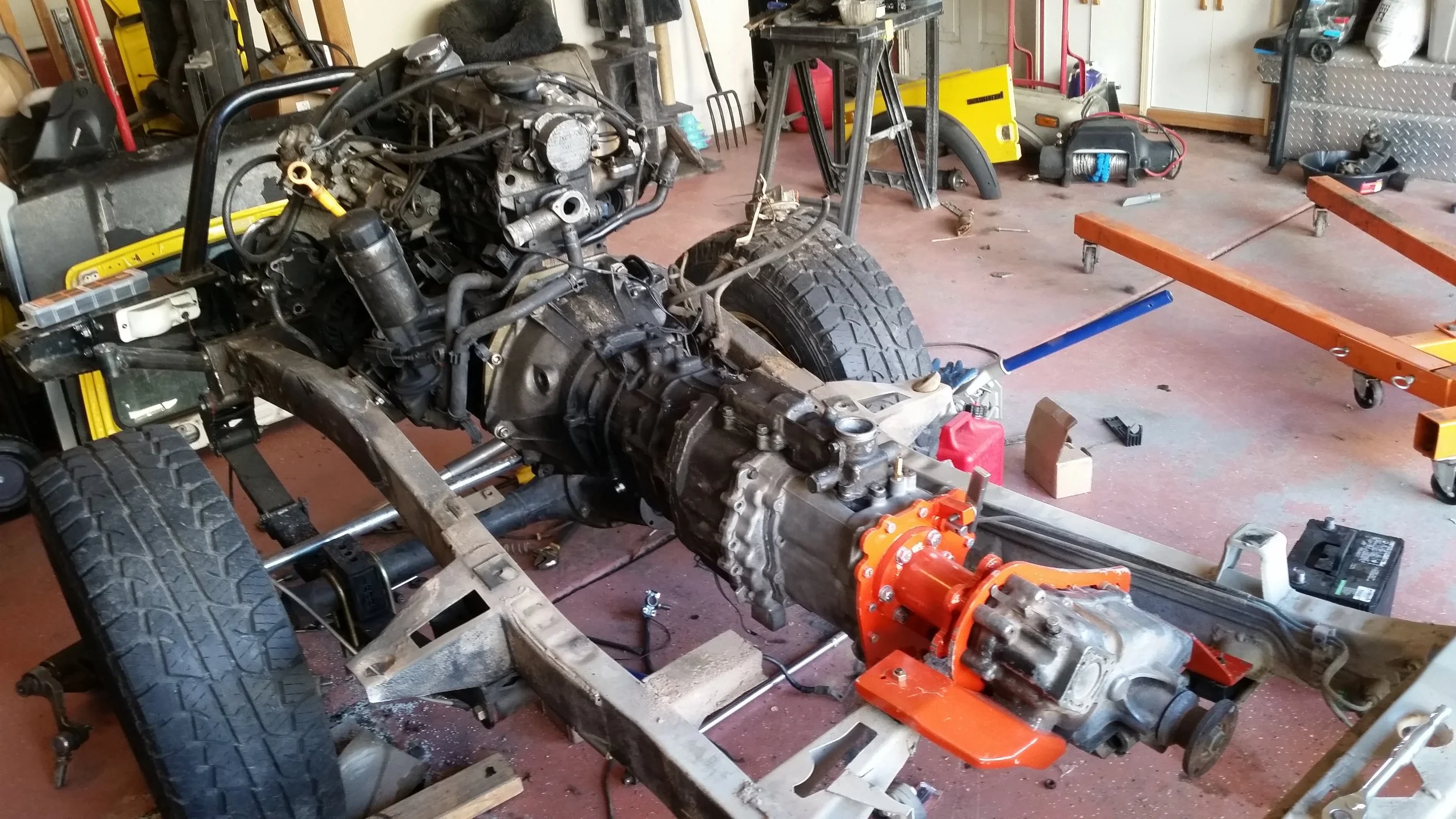

I've done worse, I've built the transmission once, then built the vehicle around that. Layers of bad ideas.
That thing ended up as such a hodgepodge. VW TDI, adapter plate, Suzuki Sidekick trans, Sidekick T-case chopped into a doubler, then married the divorced Samurai transfer case to that. I was hoping to be able to keep a high enough final gear ratio in high range that the TDI was happy while getting a better crawl ratio. In hindsight, should have just used a Toyota drivetrain. The Samurai t-case has a high range reduction, and lower gears make it much worse. IIRC the 6.5:1 gears give it around a 1.8:1 high range.

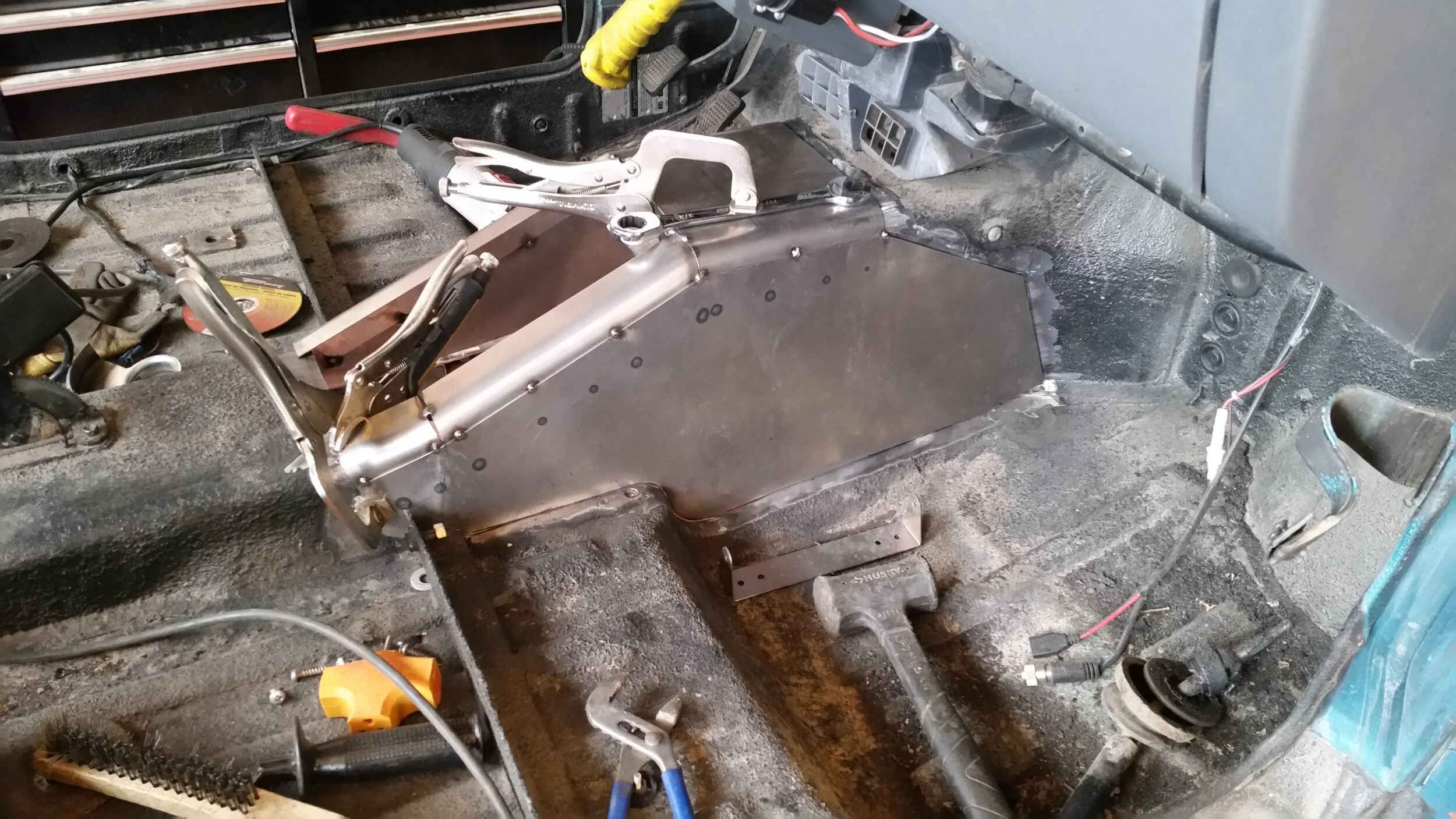

Then I still had to build a new tunnel, t-case mounts, rebuild a interfering crossmember....
At the end of the day, I'm thinking an AX 15 may just end up in it. The NV4500 is a heavy bitch that doesn't fit well, and the TR4050 is a nice trans, but still isn't a good size either. After seeing the install require belly pan dropped an inch and still having to be chopped to make the TR4050 fit, I'm less than pleased with that. I wouldn't mind a little sheetmetal work, but to raise the belly 2" and fit one of those two transmissions in, it would end up as extensive rework of the tunnel... Doable, but then adding in a custom belly pan and all the other associated BS, the cost of the kit, and all of the other surprises.... Just not worth it.
