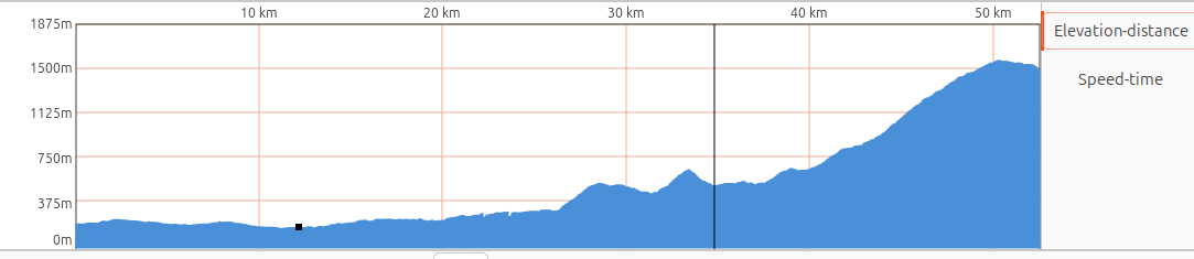

In the first half of the trip, there is a long, steep climb over some real rough road (rocks-some big, some deep washouts, lots of curves). That part of the road goes from about 450m to over 1500m in less than 20km, so we're talking a climb of well over 3000 feet in less than 12 miles.
This shows my elevation over distance. The steep climb started at about 32km.

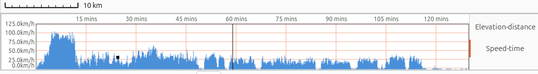

This is speed over time (km/h); over two hours to make the 50km (30 miles). The first fifteen minutes were on pavement, then we jumped off. The road was pretty good for the first 40 minutes or so, was able to haul ass. The dirt got rough after the 45 minute mark. I was seldom doing 30kph (shy of 20mph) once I got into the ugly stuff, then I slowed down at the top as we got close to the town. [A trick for converting km to mi: divide by half then add 10% of the original. So, 60kph is (30+6)mph. 50kph is (25+5)mph.]
