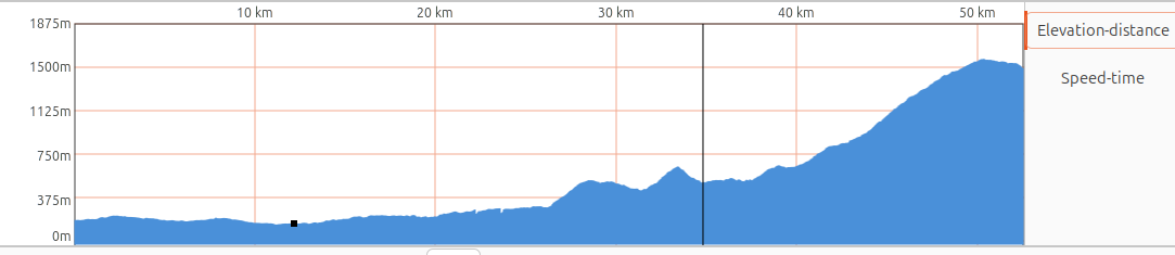

I posted back on August 15 (here...) about a trip that I am now making regularly. I posted this elevation/distance graphic to explain where my issue was:
That climb from the 40km to the 50km mark is brutal. The road is steep, very curvy and littered with rocks and washouts/gullies. I have been doing in mostly in 4hi and drive with O/D turned off, shifting down to 2nd or 1st gear or even 4lo when it feels like the tranny is straining.
First time I did it, the tranny really overheated and when we stopped at the top for a rest and a visit in a village, the transmission would make a loud but short clicking sound (maybe a little less than one second) when I put it into gear (forward or reverse) right after we had stopped. After sitting for about half and hour and letting the drive-train cool down a bit, we got back on the road and it didn't do that any more. Initially scared the hell out of me!
Previous trip I didn't notice that happening.
This past trip, it happened again, but the drive-train/tranny did not heat up nearly as much. The sound was not nearly as loud as the first time and maybe even shorter, and after sitting for a few minutes and cooling down it went away again.
