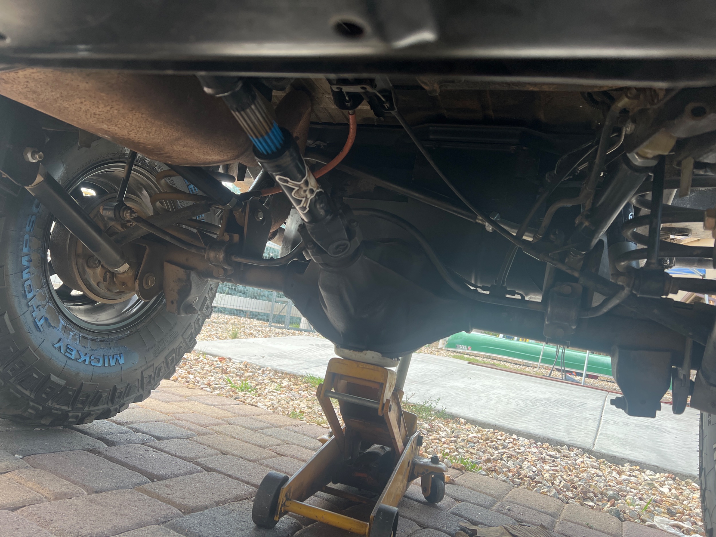

Where the heck did you get that??? I need me one

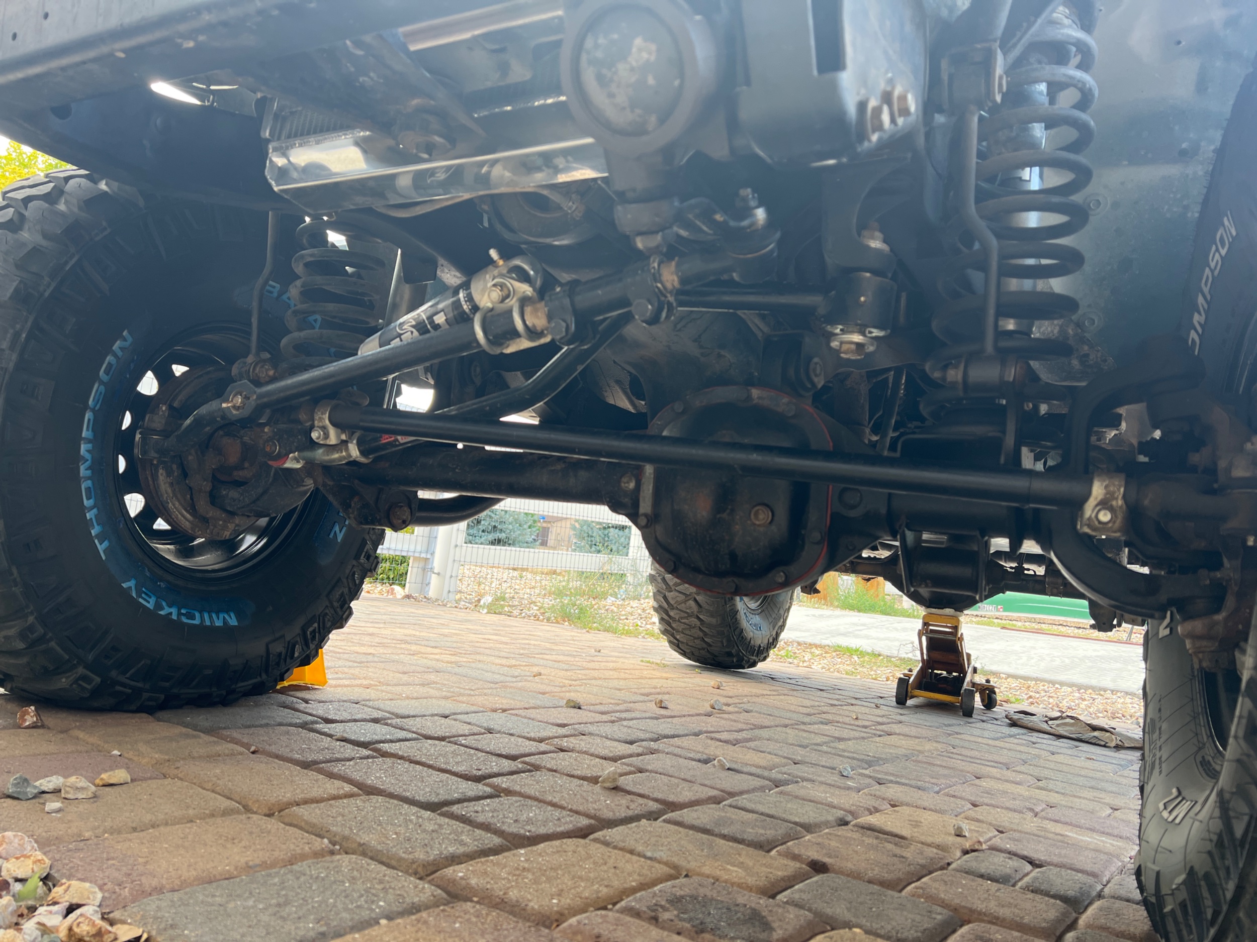

Amazon i believe it’s labeled like a dirt bike lift or something but just because i have that, it helped me with so much, lowering and raising the gas tank for new fuel pump, t-case, shoot I’ve even used it to hold my rear bumper while I drill holes it’s great, I believe I payed 100$ maybe 150$ on amazon

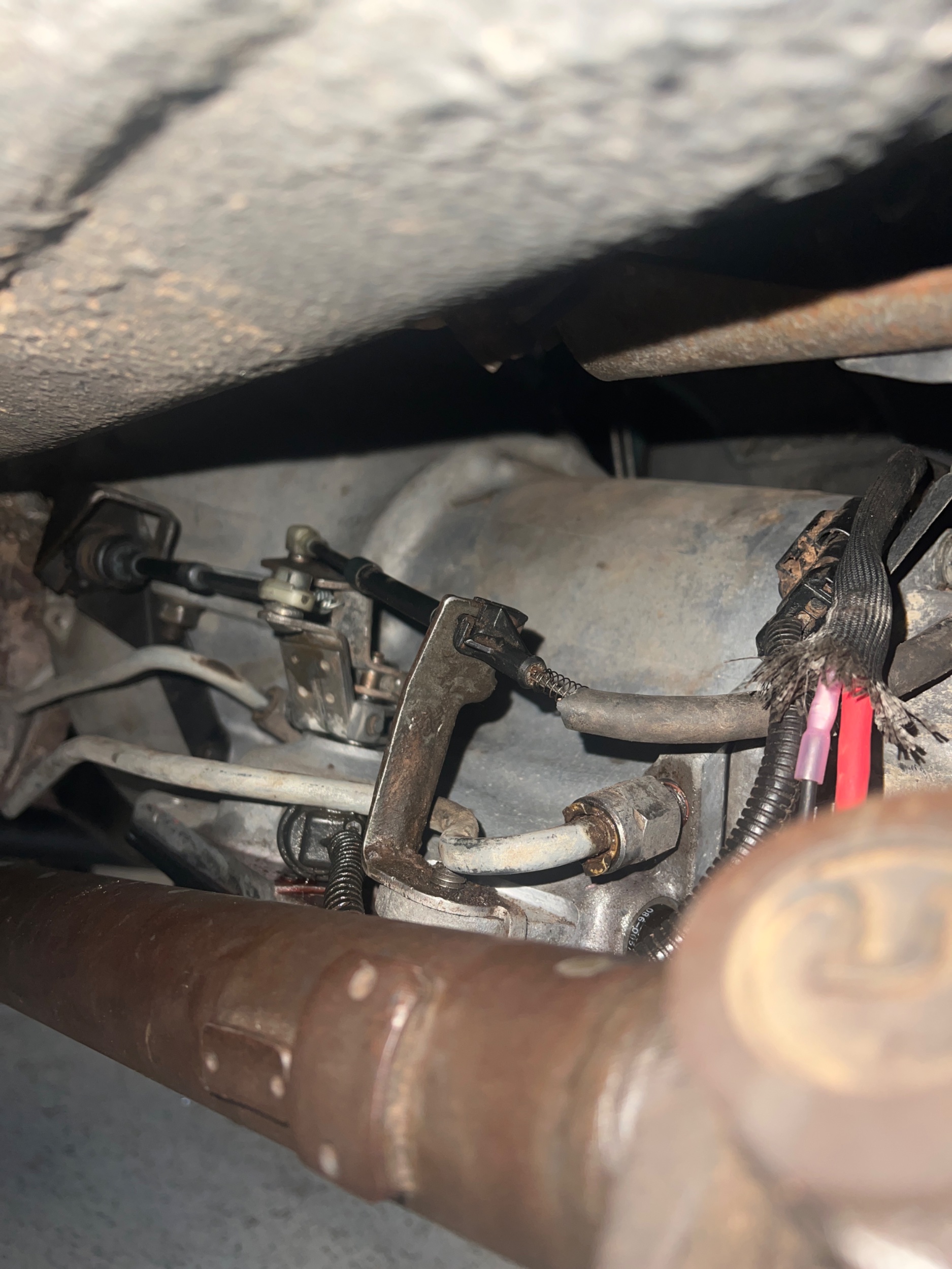

Okay that will be my next test. I’ll leave the linkage removed and shift it by hand. And get more info on the rpm limit before it starts moving in both drive and reverse, The transmission was rebuilt because I found a very big amount of metal shavings in the pan and burnt smell of oil and and leaks from the bell housing, which may have just been a valve cover leak but either way I just know the jeeps old and I wanted it to have a fresh transmission so I can have a safe mind (y)
just pop the arm out of the bar and shift it all the way forward by hand....i'm pretty sure that's 2HI. Either way, 2HI, 4HI, 4LO, you should have zero problem climbing your inclined driveway. But if the problems are still there you may need to explain exactly what you get in better detail. Does it rev but not go anywhere? Or does it creep? Or does it only do something after a certain rpm level, that sort of thing.
And did you tell us why it was rebuilt in the first place? I may have missed that.
Hey so quick question I’m about to do the test. If I am looking at the t-case shifter bar on driver side. If my car is in 2hi is the lever all the way left/up or all the way right/down? If that makes sense 😂 @Christian.mers @hear

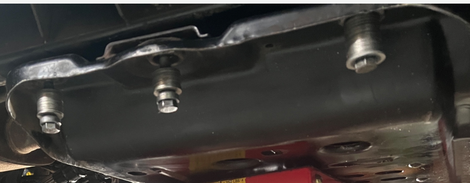

Also, these spacers only exist to go between your skid and the frame, to lower the skid plate if you need it lowered to fix a driveline angle. The bolt heads themselves are chamfered to fit very nicely into the countersunk holes on the skid.
Let's worry about one thing at a time, but having them below your skid is doing nothing other than making it look like you're a real newb. :LOL:
That shit is so funny 😂 the skin plate used to have a drop kit with the one and a half inch bars on each side of the skid plate. I removed those because I got a slipyolk, the bolts were still really long so I had to add washers for now until I cut the bolts shorter I’ll prob do that today since you mentioned it. My transgender shop opens back up Monday, I have today and tomorrow to work on jeep to see if I can fix sluggish acceleration. It was getting late last night and I was in my driveway revving my jeep super loud just trying to backup the smallest inclined driveway😂, so I stopped.

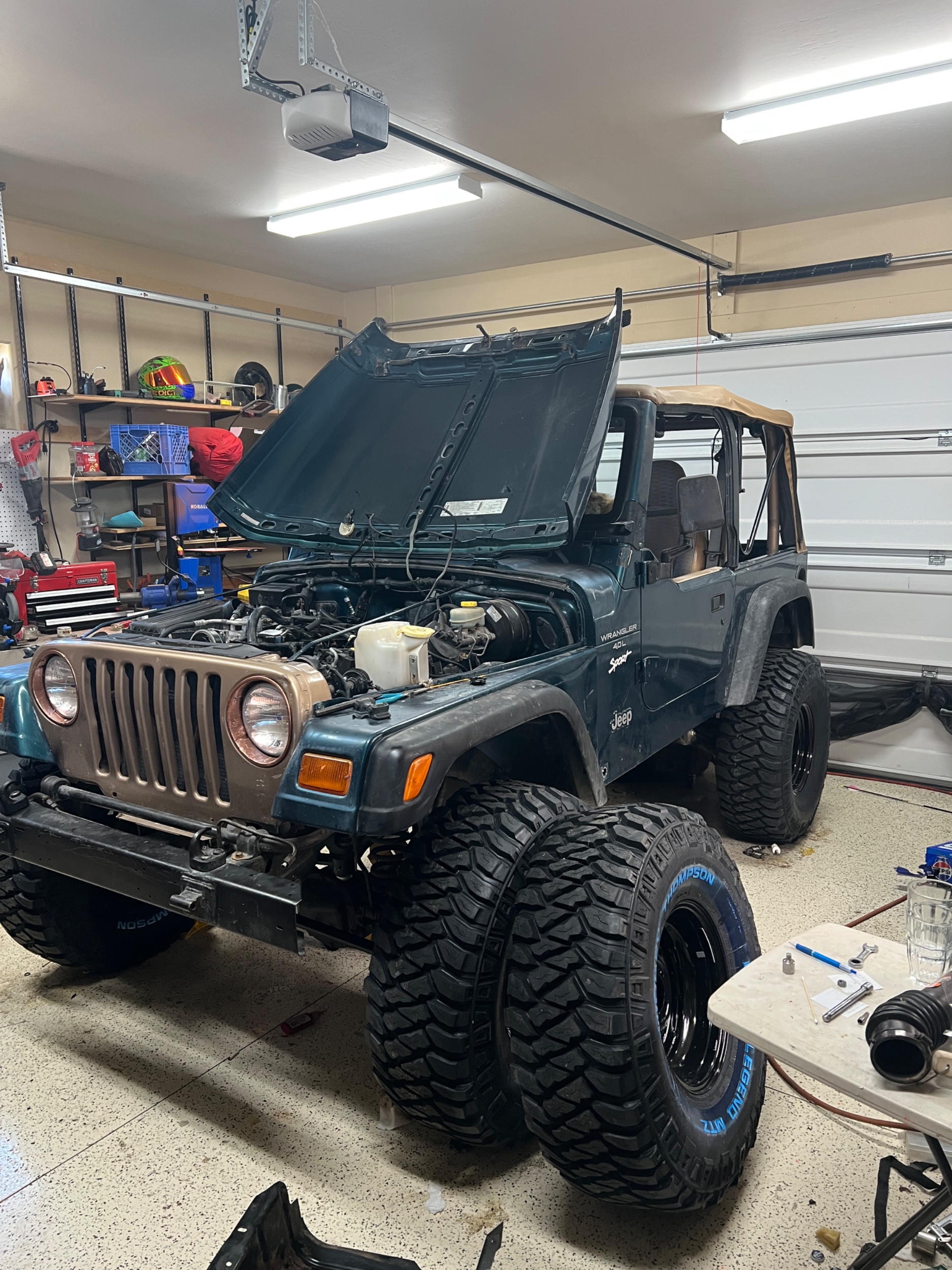

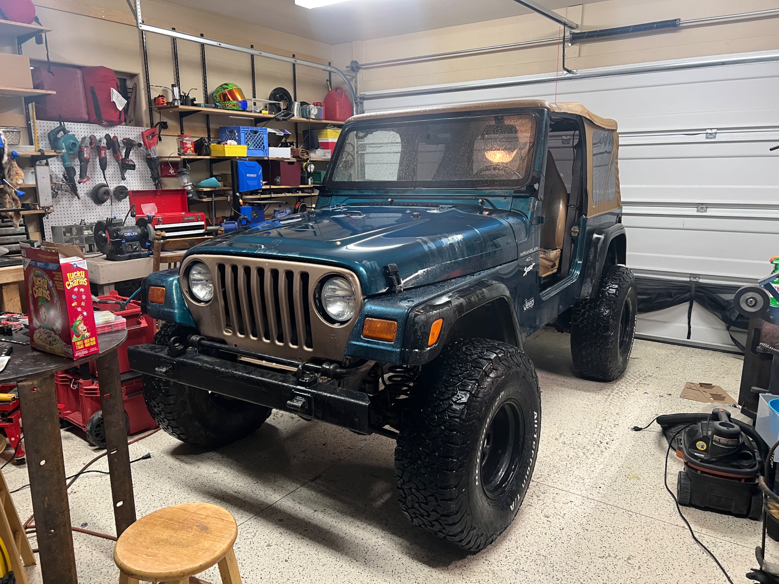

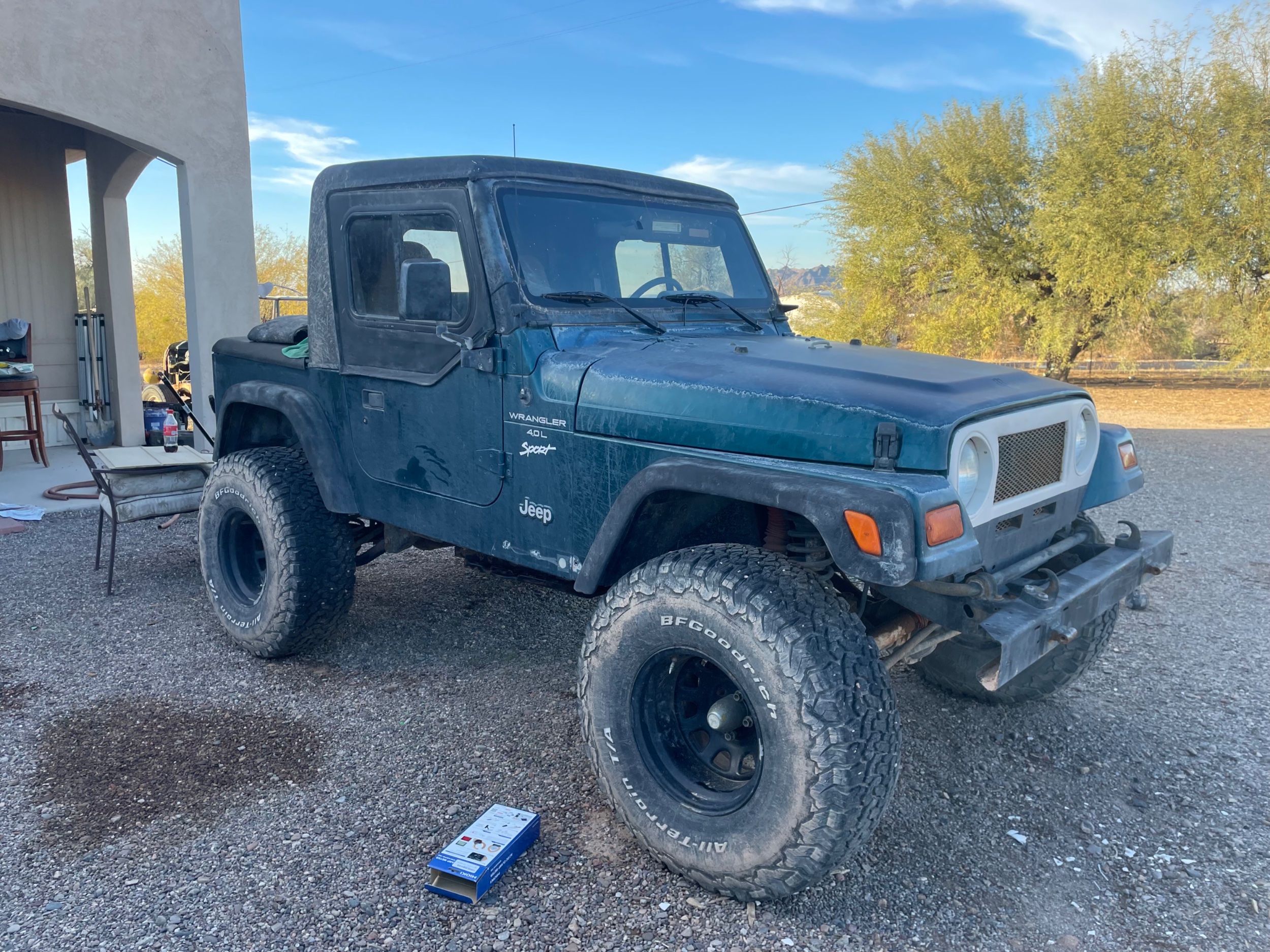

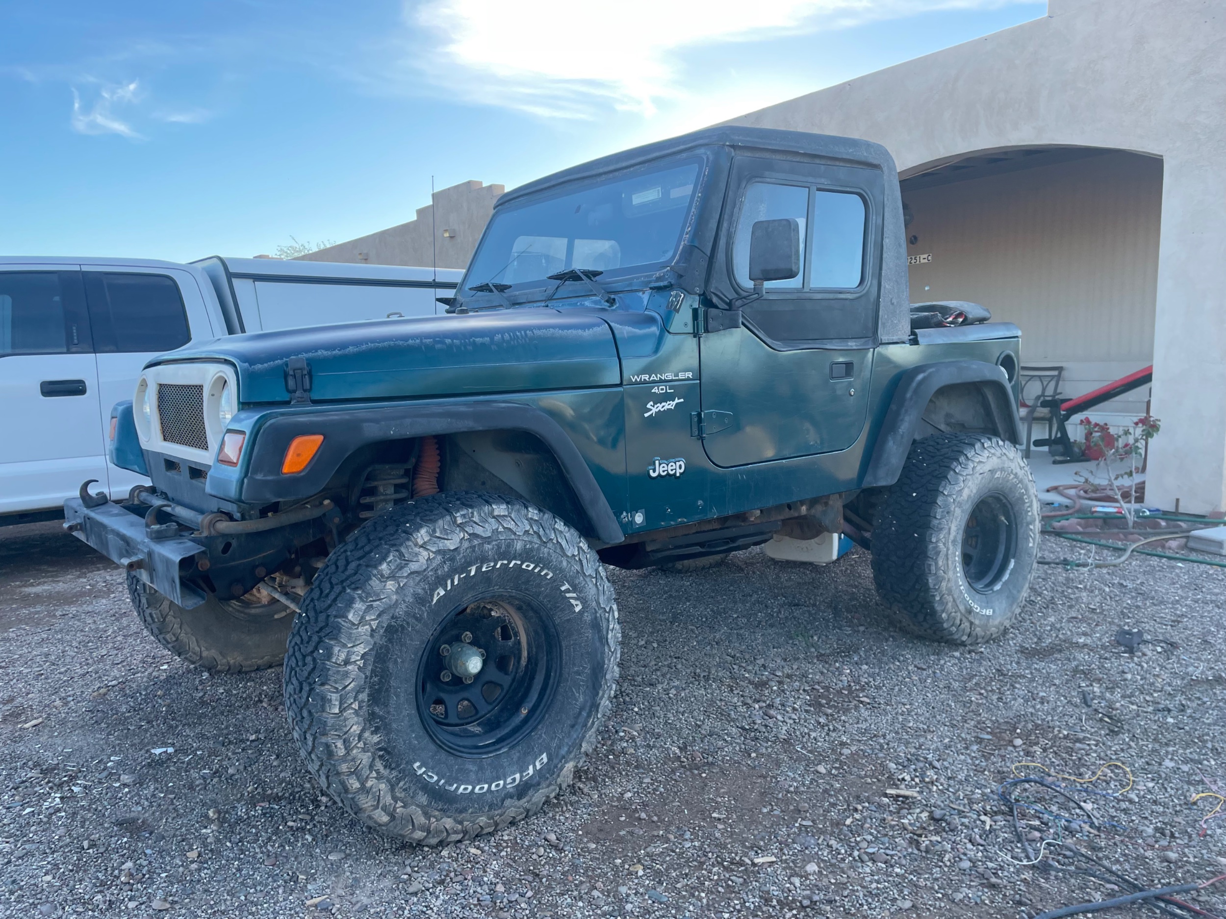

I’m gonna share what the jeep looked like when I first got it
@hear I believe you can see the skid plate drop bars still on, on the old photos. I also just found out right now while I was taking those photos. Is that my rear track bar along with my rear track bar relocation mount that was never welded completely just came off. I really need it welder on because I’ve already bolted it down twice before it coming loose. Might do that today as well

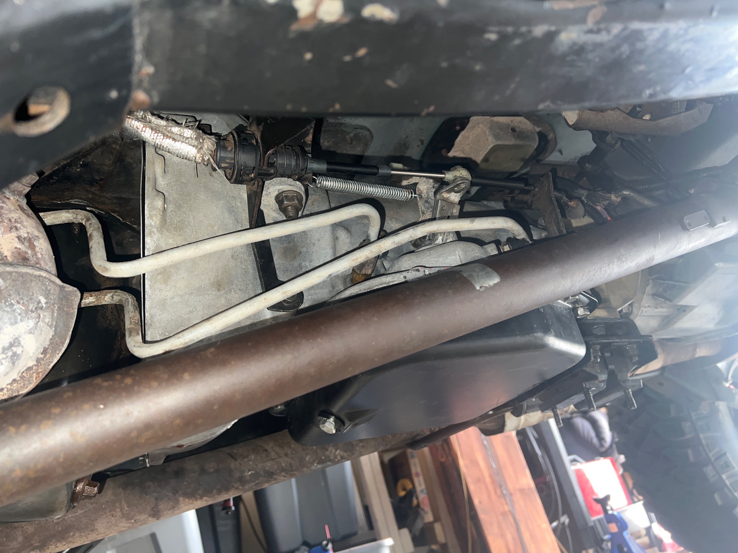

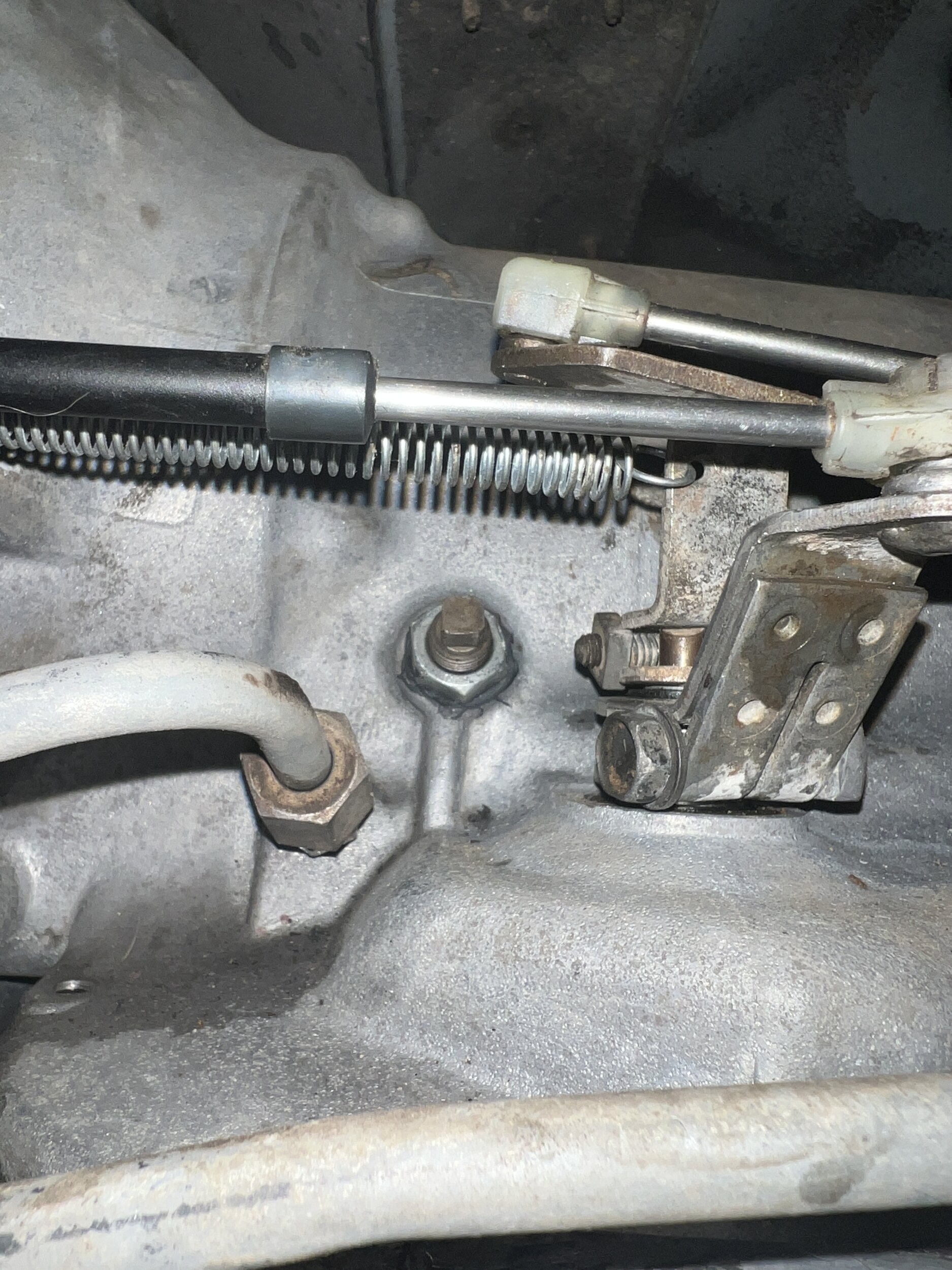

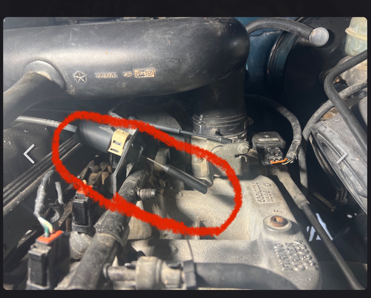

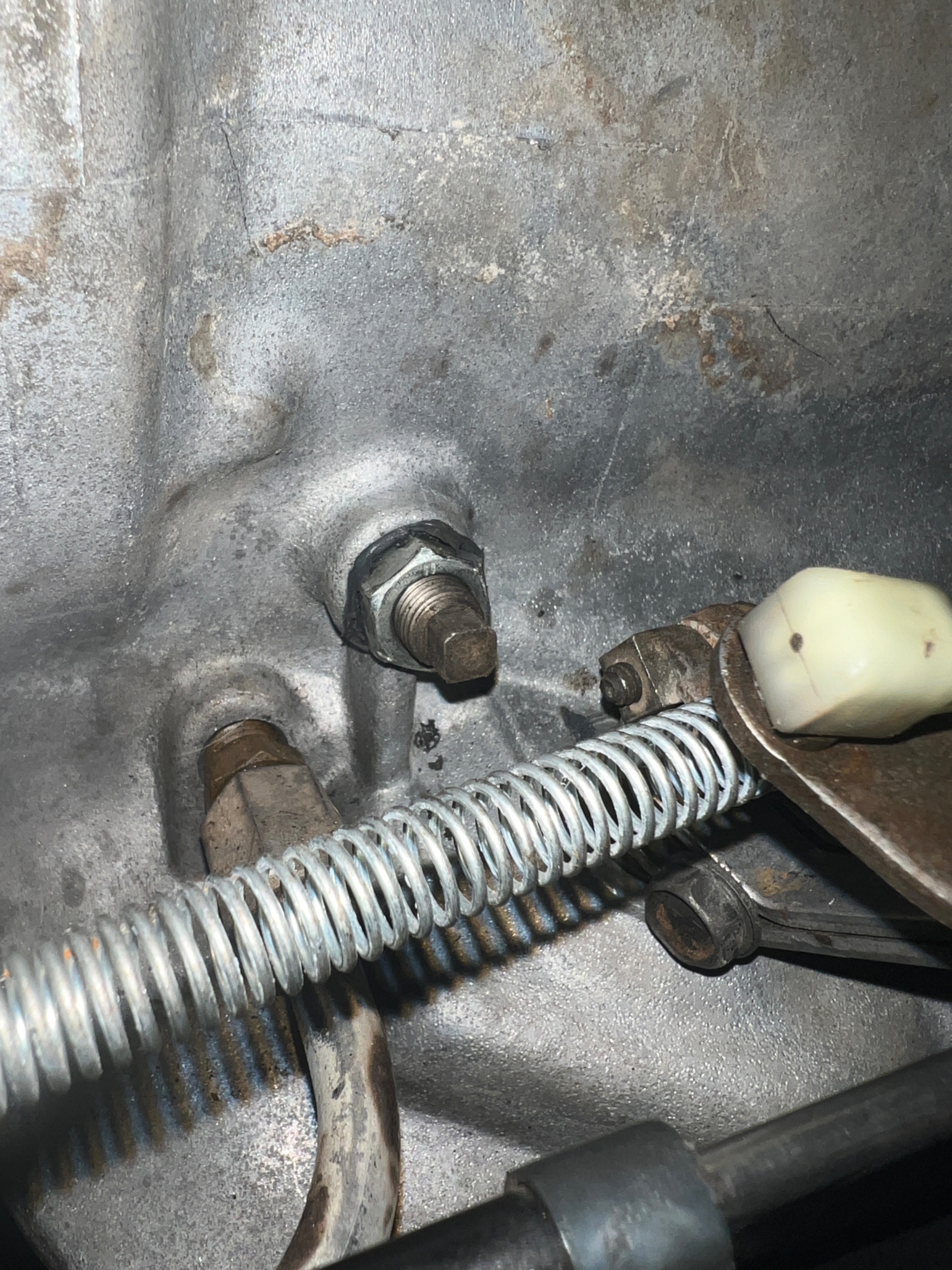

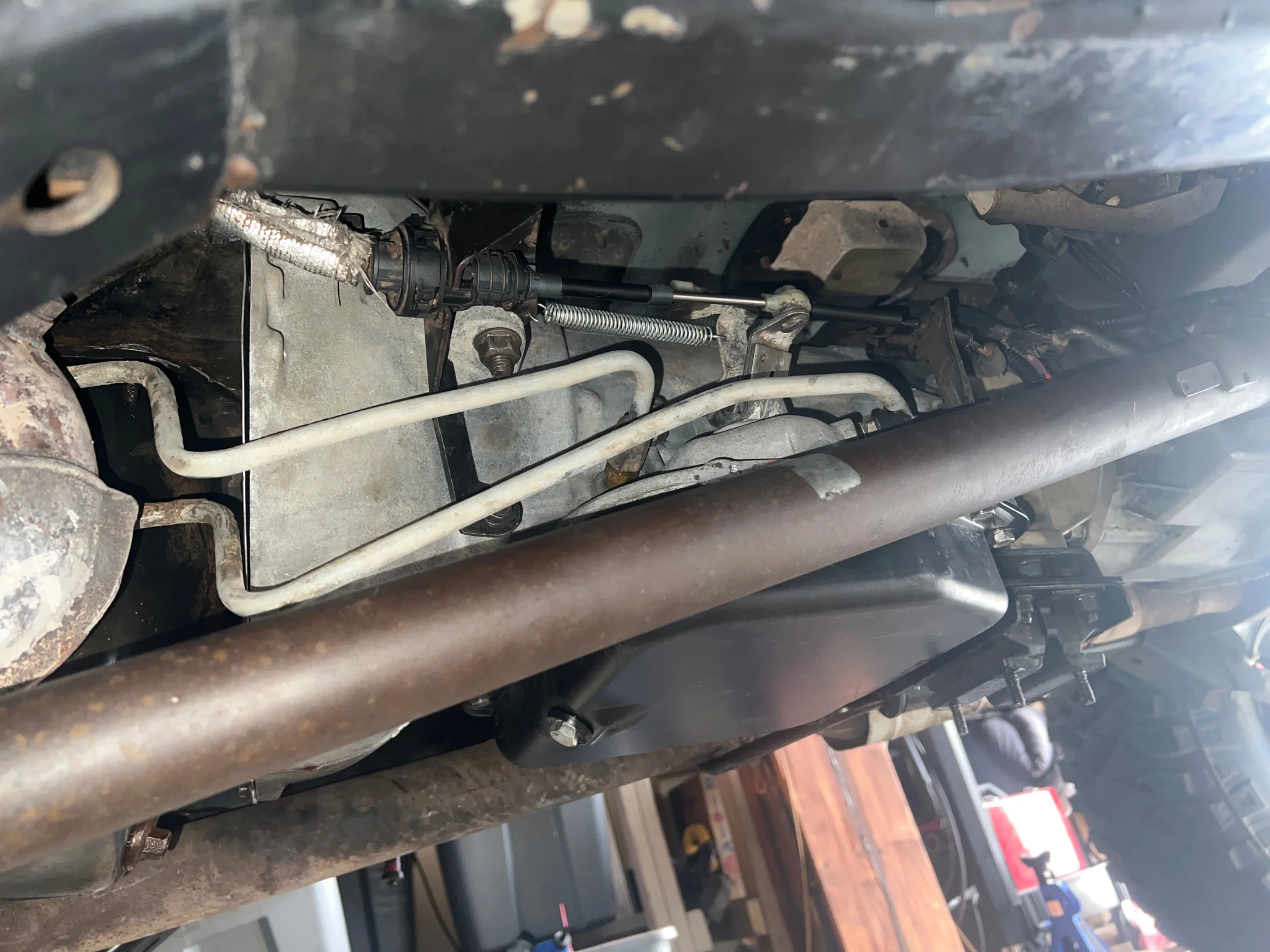

@hear @Christian.mers I noticed this bottom cable that I circled in red. Has the smallest bit of slack in the line. When the top gets pulled, the bottom plastic will slide for the smallest amount before pulling even pulling the cable. Based off your knowledge, could this be causing my issue? I looks nice and tight but when pulled the bottom one travels a bit before pulling cable
