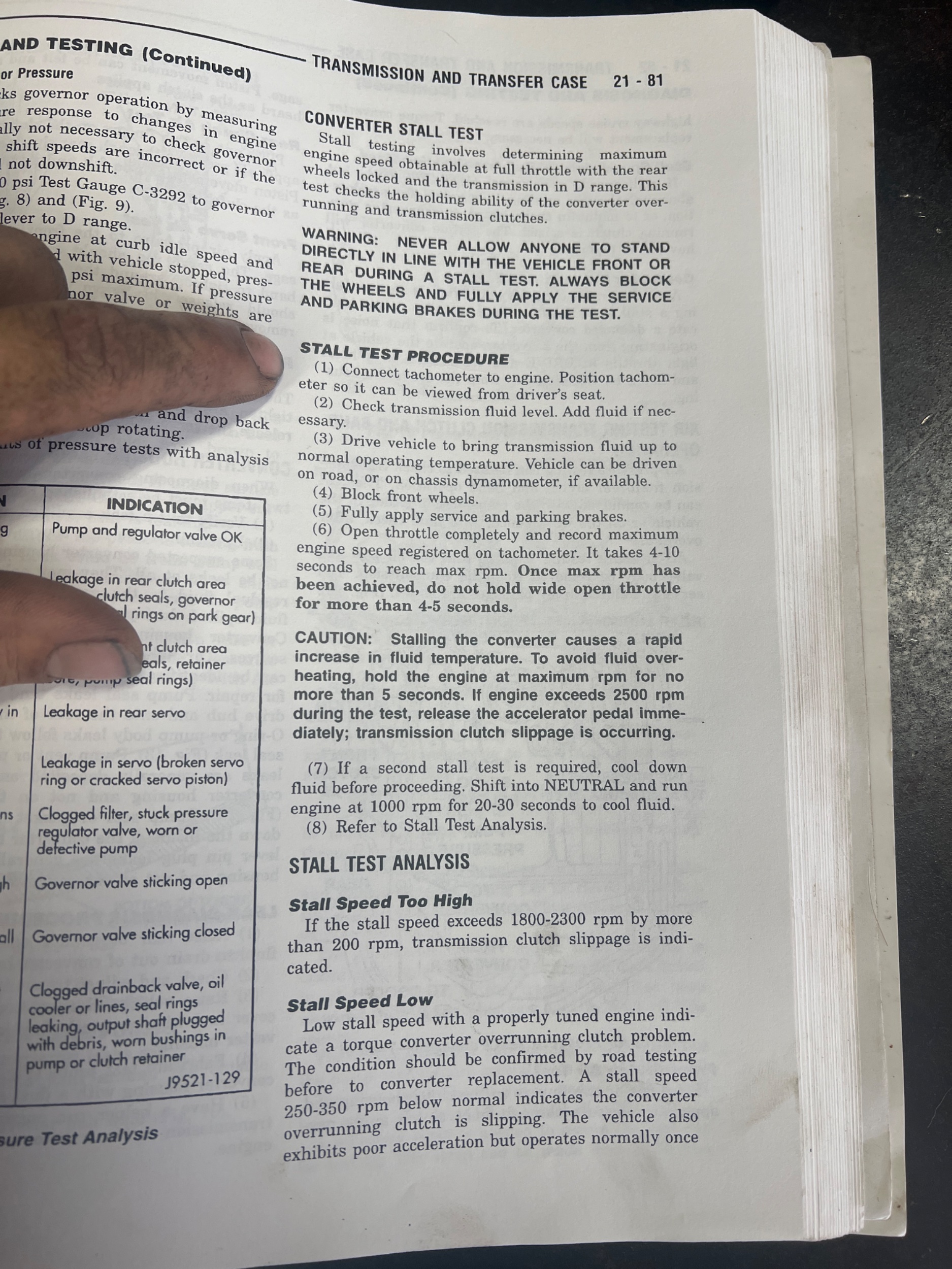

Like @hear was saying, try a stall test. You can find your steps here in the manual.

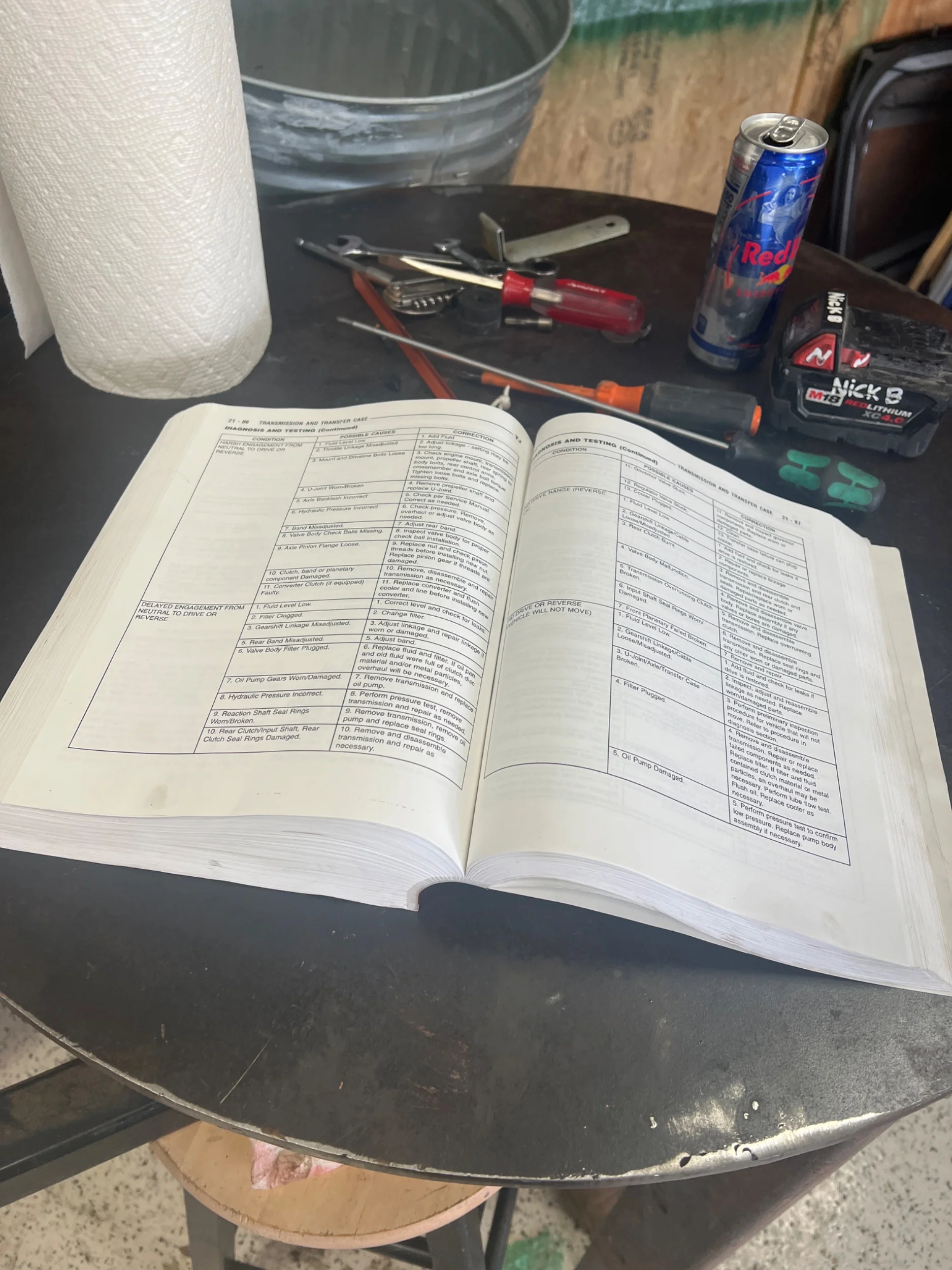

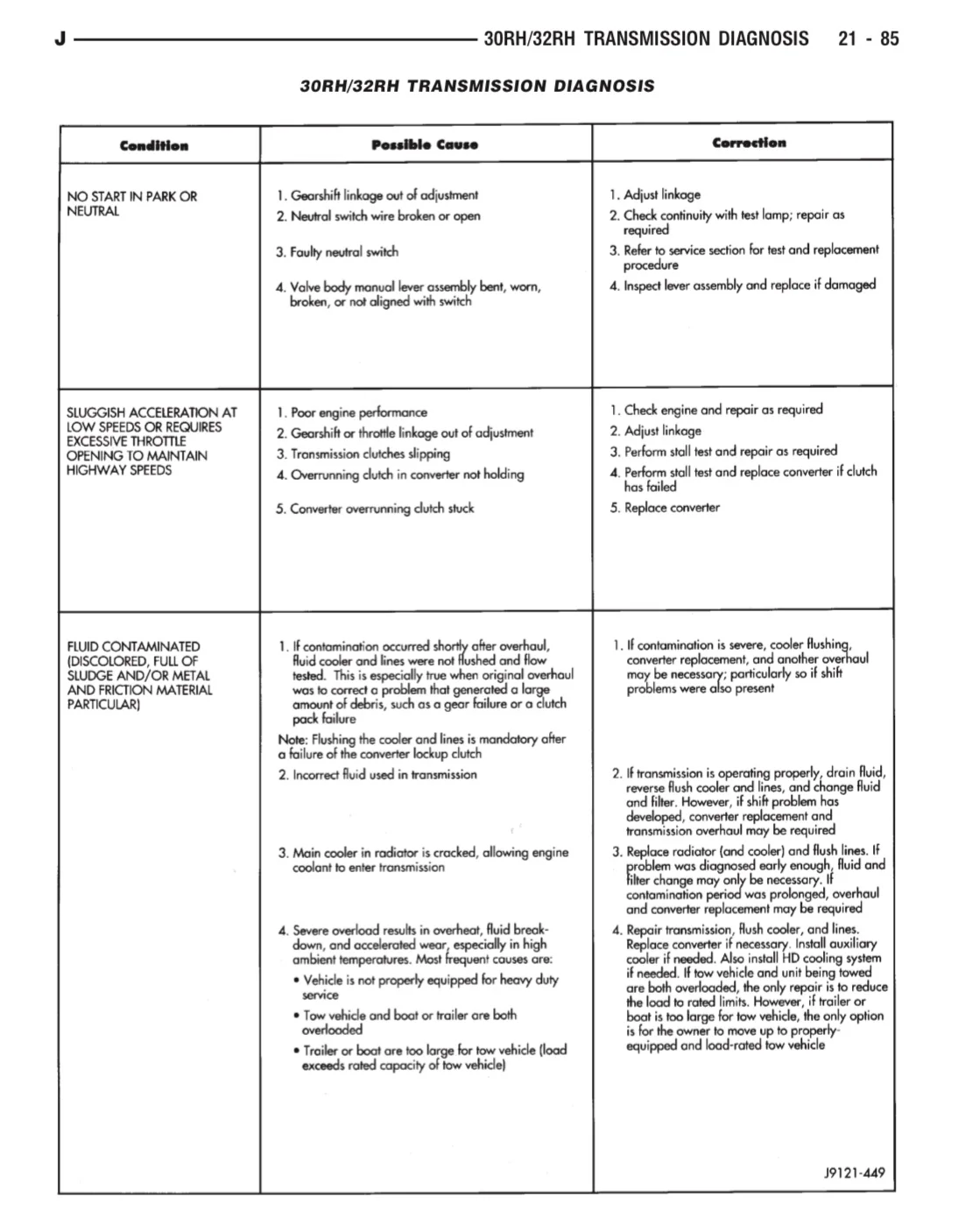

Page 21 - 85 seems to address your issue shortly but I’d follow the testing procedures to be for sure and to determine which of the 5 issues may be the one you are experiencing
@Christian.mers @hear I completed the stall test, I used these procedures, the stall test did not go over 2000rpms

Hmmm, this is definitely where @hear shines for sure! To me it sounds like the torque converter is the issue and that’s what the this test is really signifying. I would replace that when rebuilding unless I knew 1000% that it was perfect

I got this exact one on ebay for 90$ seriously has everything you’d ever need to know in it. That why when you sent me that document, I went to that exact page in the book (21-85) and it had like 5 pages about stall testing. It’s a great book, look on eBay
