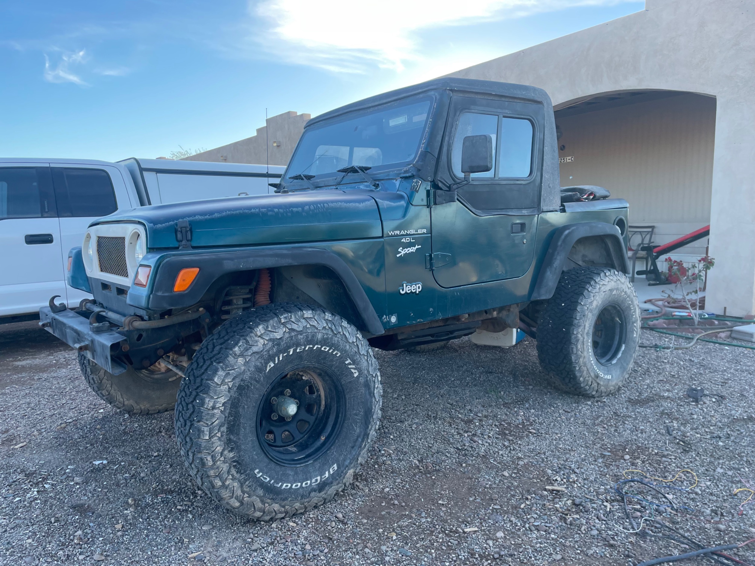

Rebuilt transmission not shifting out of first gear
Does it have a lb?
Reverse too? Try 4-lo In reverse and see if it gives you the same issues as 2WD reverse.
Still sounds to me like a shift linkage even though yours looks about right to me (it’s almost midnight here in WV and I’m crawling around under my jeep😂)
4 lo in reverse gives me no issues and actually drives how 2hi should feel I did my test shifting t-case by hand. It’s definitely in the right gear. Also in drive and reverse the jeep starts creeping at 1200 rpm @hear @Christian.mers
I’m planning on replacing my kickdown/throttle cable. And heavy dusty t-case cable linkage and take jeep to shop Monday. I’ll respond back to this thread when those 3 are done or if I get this fixed. Thanks for everyone’s help and feedback @macleanflood @tr21triton @hear @Christian.mers

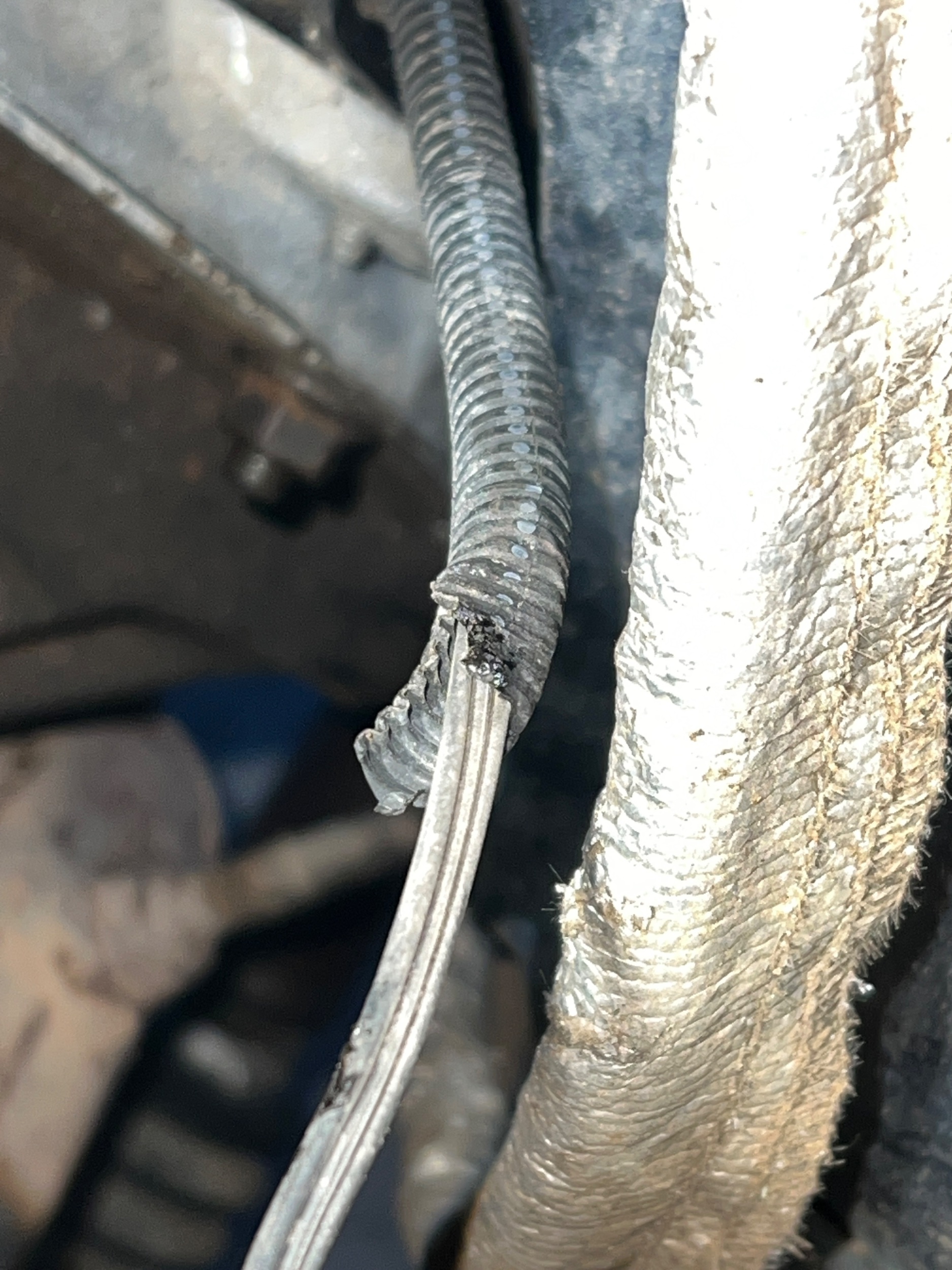

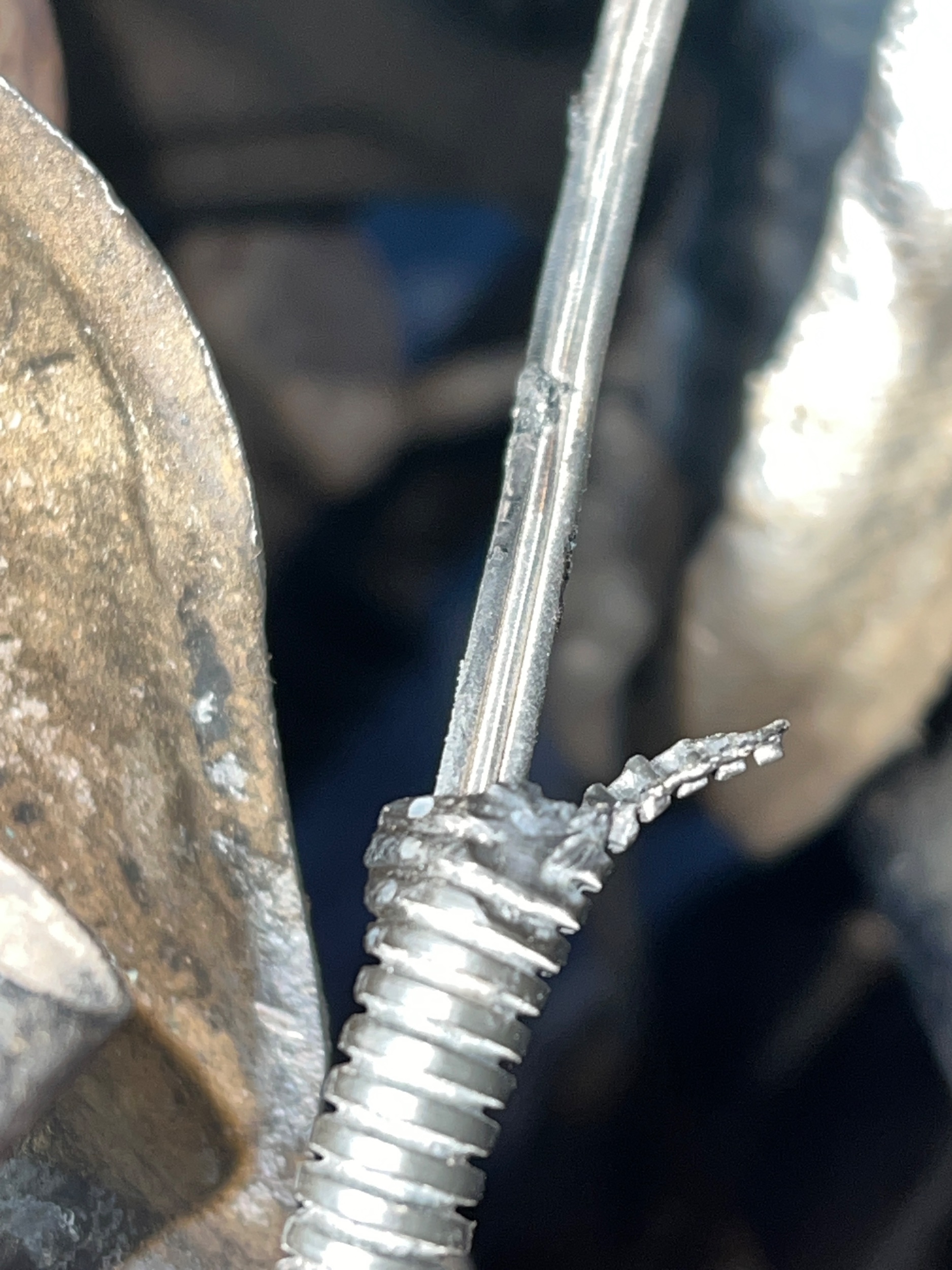

Sorry I wasn’t getting back today. Take the jeep to the shop for sure but check out that procedure, I had messed up my throttle cable and I was balls to the walls to get it to move from the stop and I followed the procedure and some of that plastic sleeve did end coming out and you’ll hear some clicking as you make your way to WOT (Wide Open Throttle) and see the plastic conduit coming out towards your cable end

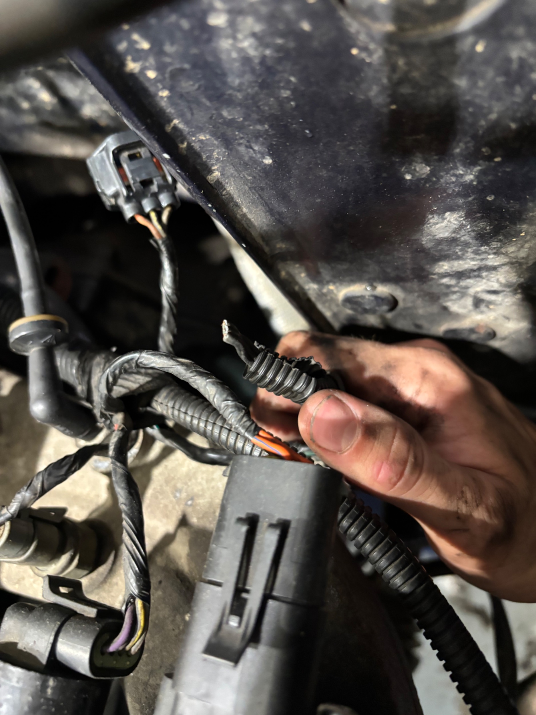

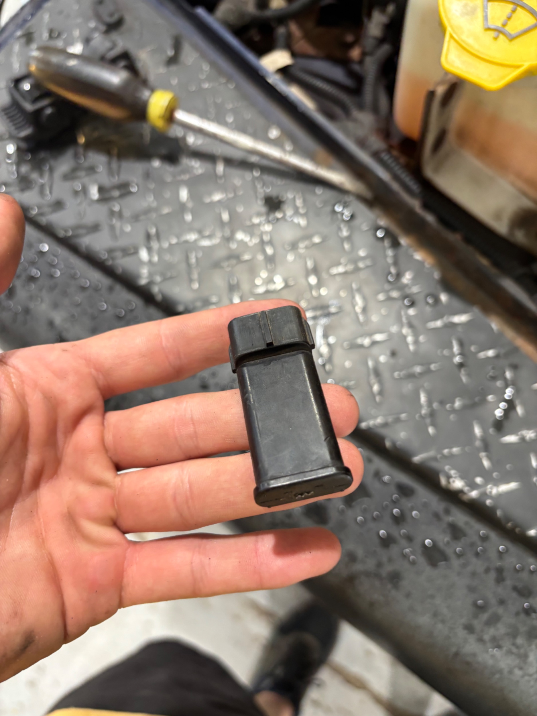

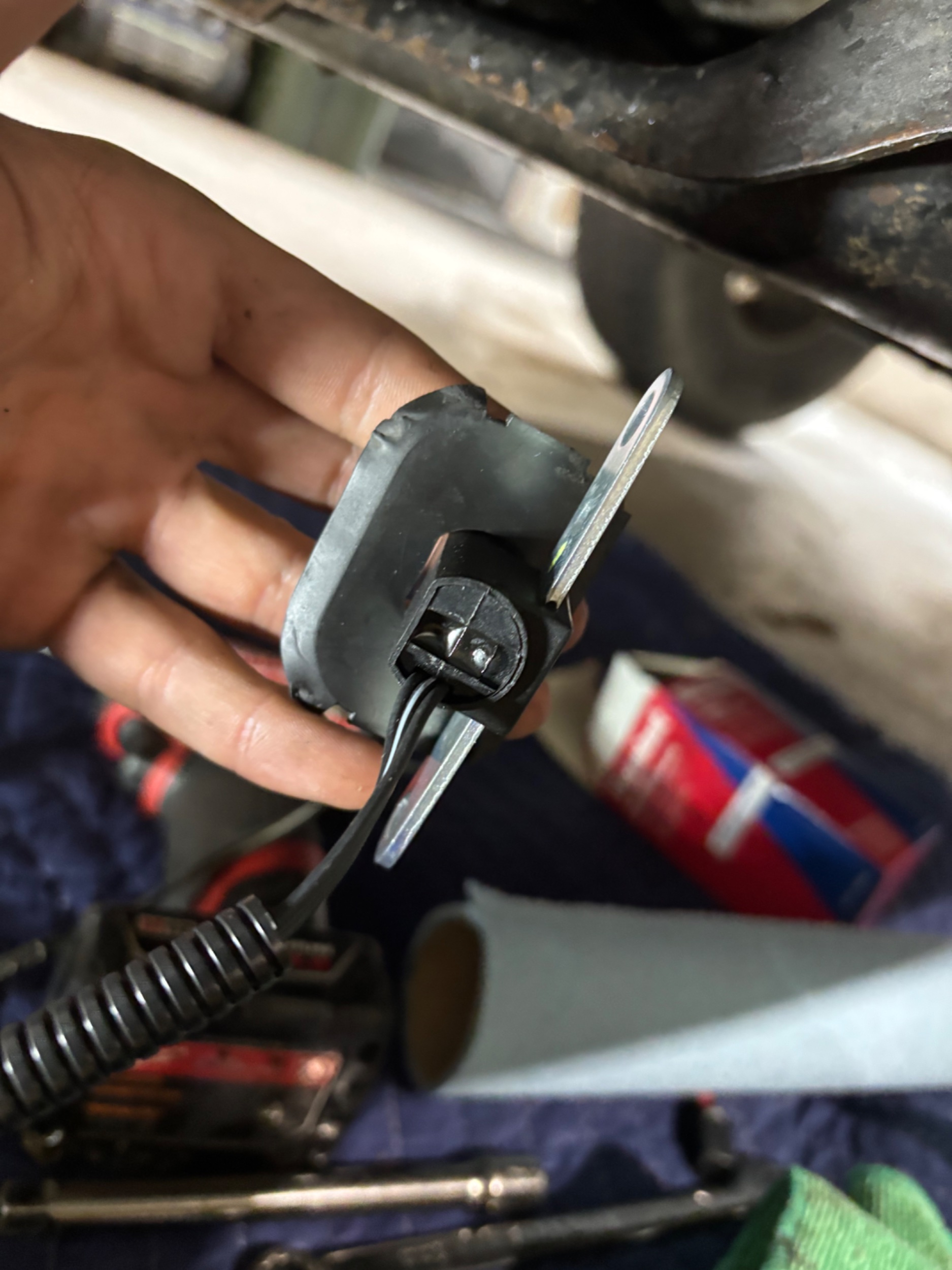

Hey @Christian.mers @hear what do you think of this.. I read another forum with somone else having similar sluggish acceleration issues as me he said it was his crank shaft position sensor. When I was picking my transmission up from transgender shop the guy said “hey it’s prob not good to leave your cps sensor on the transmission” when I brought it in. This just popped in my head. I looked at this sensor right now and I think it may have got fried or melted. He said after he replaced his cps sensor his jeep could climb a tree. If you look closely you can see the wire got melted pretty bad enough to melt the shielding in half
I needed to replace mine. When I would go to accelerate it was absolutely sluggish, some things I noticed would that I would absolutely lose throttle response and when I pressed the accelerator my engine would pop pop pop like it was backfiring, slow down like it was in limp mode and I’d have a huge loss of power and wouldn’t return to normal throttle response till I slammed to WOT throttle. I noticed I really needed to look around when I was driving up a great West Virginia hill and someone pulled out in front of me and I had to slow down immediately, I had to shift into 4-hi then 4lo to even get enough power to get to the top of the hill and that’s finally where I realized my ignorance and laziness was going to be the death of my jeep.
Testing it:
Disconnect the plug and check resistance across your two signal wires (I believe the range is 200-1200 Ohms)
Also check continuity on sensor and chassis ground
Check voltage when cranking (Should be around 0.5-1.0 AC V when cranking if I remember correctly)
Check wiring for issues too
Do you have any issues at idle? It doesn’t sound like what I was experience or the classic signs of a CKP issue, especially if your jeep is starting up no issues but it’s always good to rule everything out

Another thing to note is that I got no codes even with the awful state of my sensor plug and wiring. I touched the plug and it fell on the floor so that should tell you all you need to know. It was only an intermittent issue and I had the issue since December last year but it didn’t give me trouble for a couple of months then happened a few times and then didn’t give me trouble.
That’s sensor takes so much heat soak in the area it’s located. it’s unbelievable. For loom just look at harbor freight for 1/4”
That’s just my take on the CKP sensor issues that I experienced
