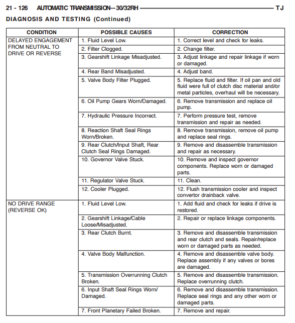

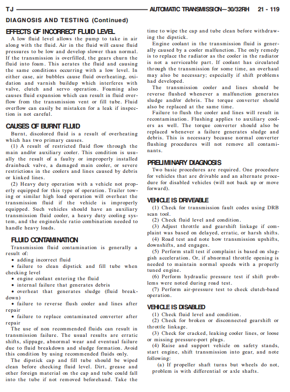

download the service manual, if you haven't already. here are a couple excerpts that may apply
Reactions: ColoJeep
