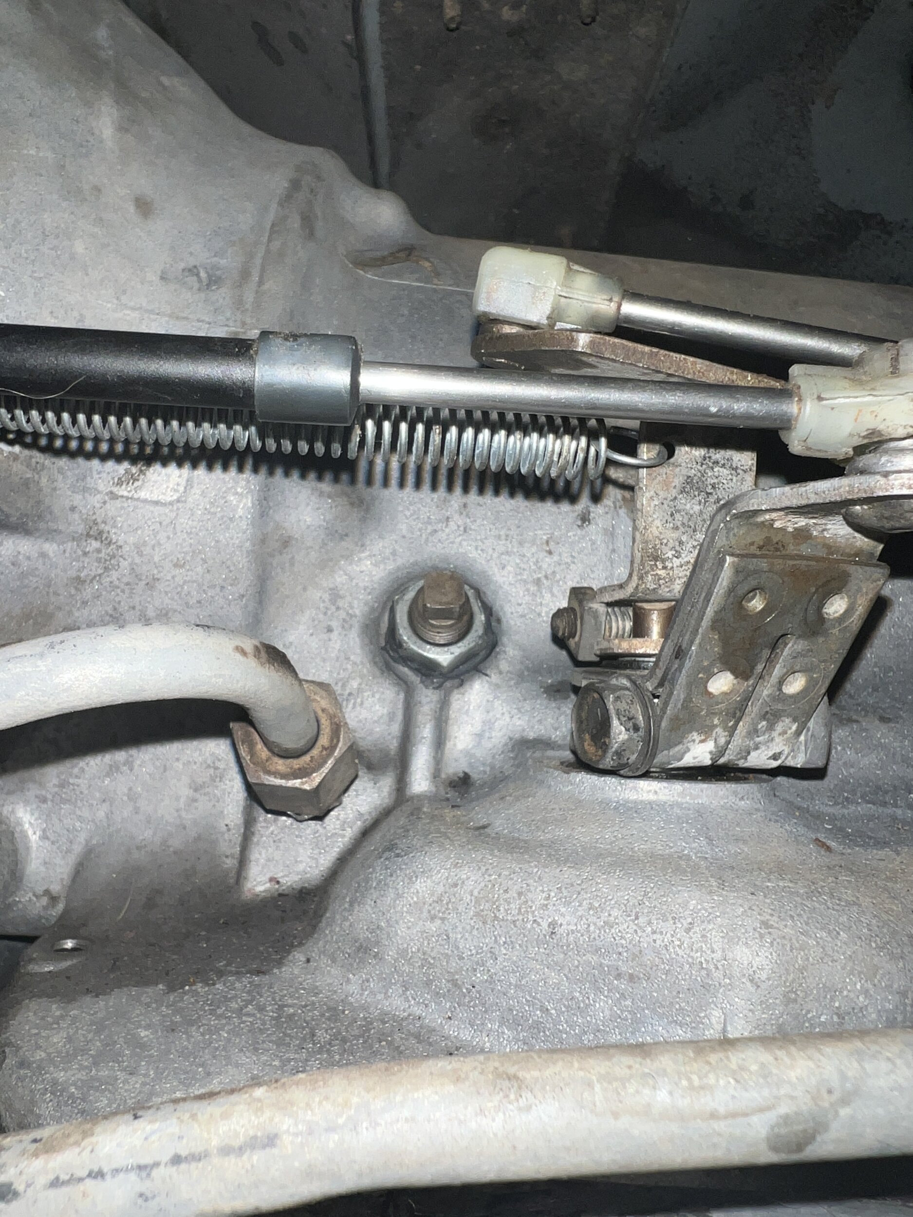

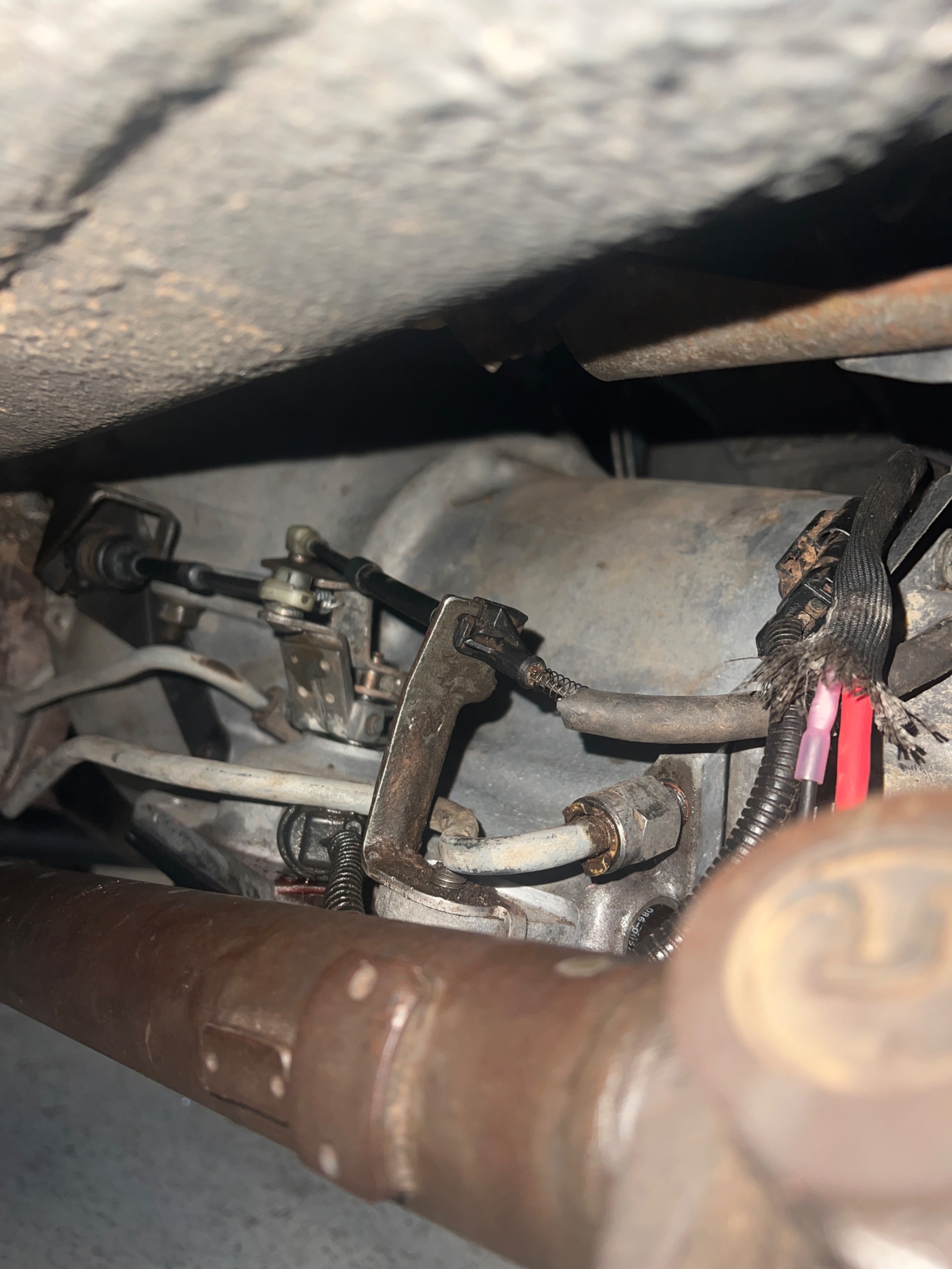

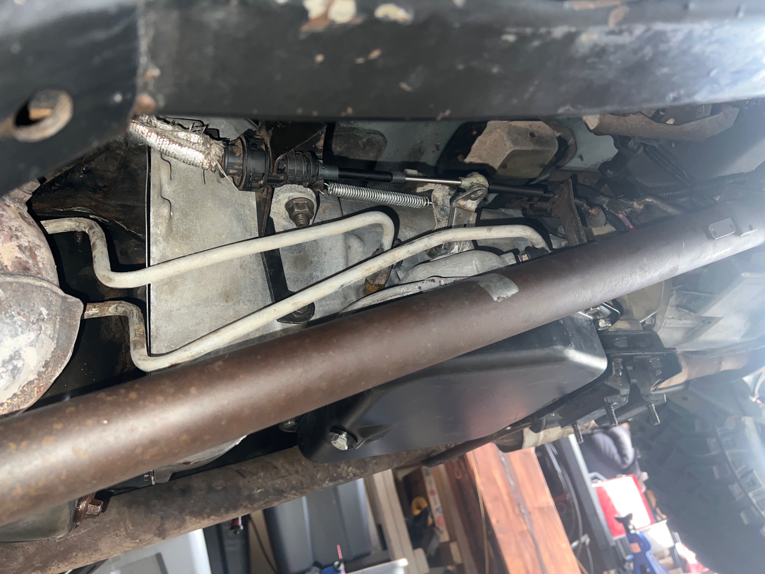

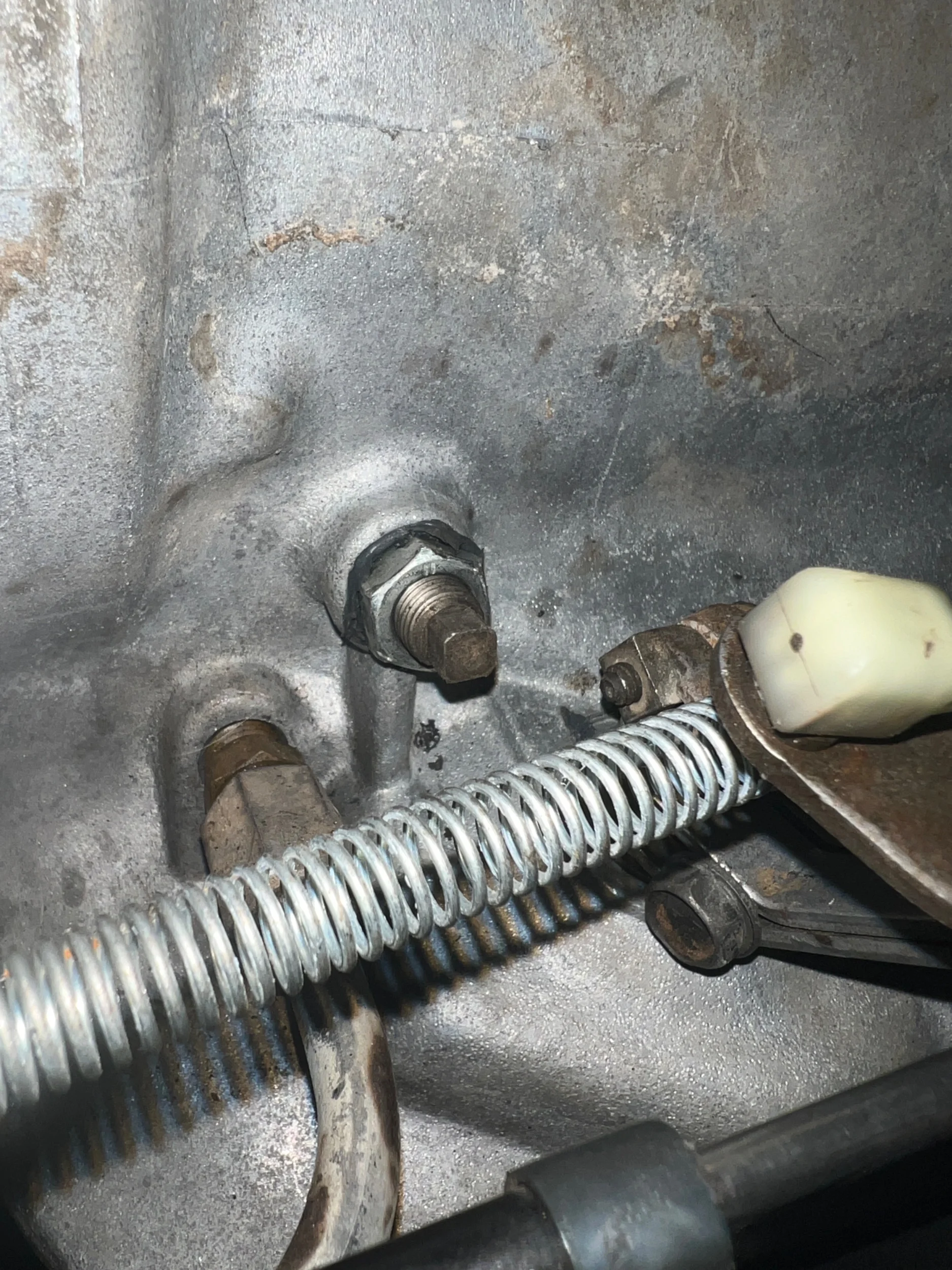

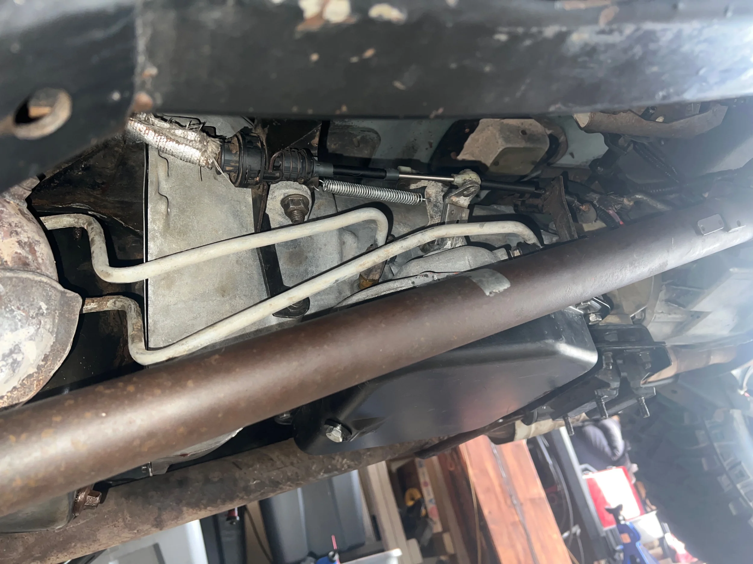

I have some thoughts about all this…basically I’m not buying that a TV cable misadjustment for a short period of time burned out those clutches. Might be why they’re fixing it for free.
Prior to starting this thread, had you done any adjustment on the TV cable? I ask, because to remove the trans all you have to do is remove the return spring, loosen the hold-down bolt, and slide the bracket off the selector shaft. And when you re-install it you do the reverse; no adjustment is necessary. So if it didn’t burn out your couches before, I don’t see why it would now.
On the other hand, we already know they didn’t properly perform the kickdown band adjustment, so what else might they have forgotten? Clutch clearance, maybe?
I’ll be back with a discussion on pressure as time permits.
So I just got my Jeep back today, and yes, I agree. I told them the same thing. The transmission just slides out and slides back in without messing up any of the TV adjustments so how did that cause my clutch to burn? They tried telling me maybe it was already misadjusted beforehand and with the rebuild matching up to that miss adjustment, that could have caused it? Either way I bought a new kickdown cable they installed it and told me to pick the jeep up today. They did a test drive made some adjustments and I drove it home and seems like it’s doing great other than a little bit of early shifting which I think is because of the kick down adjustment is maybe a little tight? Which they even told me themselves they may have adjusted it a bit tight, hence, they only test drove it about 30mph but bring it “back if it is to tight” (although I think I can do this myself) It shifts right after 2k like prob 2300 I’ll have to drive it more and get back to you, I only drive it home. But it’s shifts pretty good now and drives great. I was also petal to the metal trying to get up a hill on the highway seemed a little too slow. But I’ll have to drive it more to tell. I’ll do some test and get back. They did show me the bad clutch and parts inside the transmission and they were burnt to absolute shit like all black… i barley drove it when i installed it back myself, and i even towed it to them when returning it to them so I didint mess anything up after installing the trans. So that was a little weird? @Christian.mers @hear
Sounds like a tight TV. I wouldn’t have even pulled into my garage, all of this hassle, I would’ve noticed the issue and drove right back😂
Definitely a shop error 100%. No doubt about it. Whether it was the wrong clutch clearance or even the valve body not being installed properly and there being a stuck valve. If your cable was misadjusted before then there would’ve been signs and symptoms and a rebuilt transmission doesn’t change that
It’s like the shop saying: “It’s not us, your throttle cable is the issue, look at these clutches. But we’ll fix it free of charge”
Shops do this all the time, this is their way of acknowledging that they F’d up and it wasn’t your fault but they still wanted to make it right.

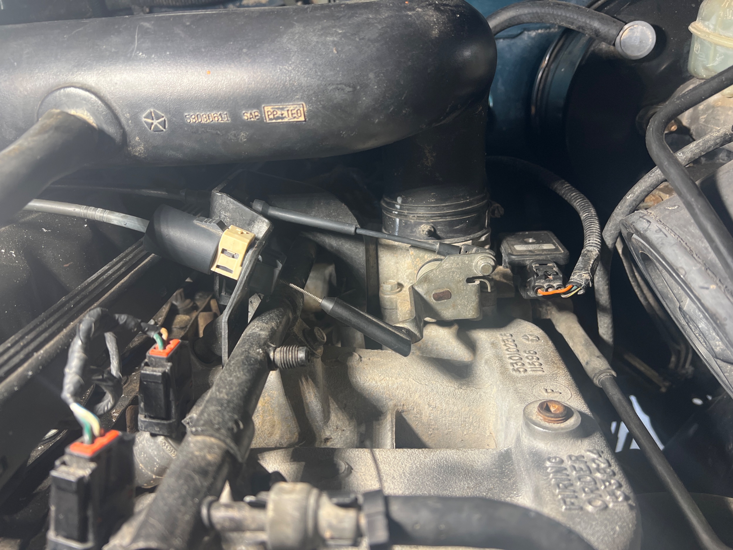

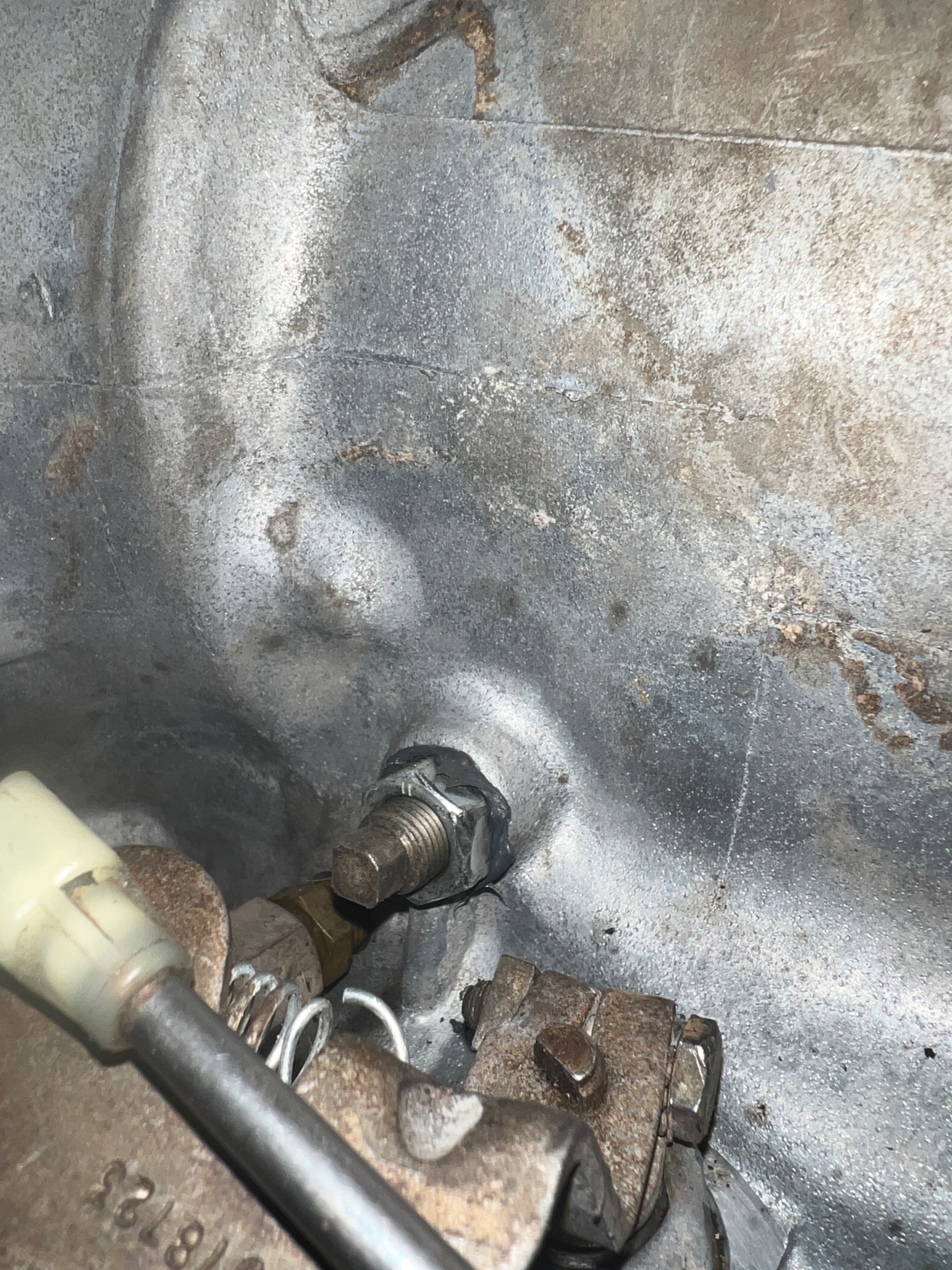

No way the TV cable misadjustment burned up your clutches that fast. But it sounds like they made it right. The kickdown band being too tight shouldn't really adjust the shift point. All that adjustment does is set the resting drag of the band on the drum, which effectively sets the required servo pressure to lock down the drum. It would make the shift firmer, but not sooner. The TV cable, governor, & valve spring stiffness will affect the shift points. And I guess the line pressure screw, that you normally wouldn't touch unless you had established that the pressure was out of spec.
To take the tv cable out of the mix (to a certain extent), just shift manually and see if it performs like you'd expect. If that's fine, but shifts early when in D, it's almost certainly the TV cable adjusment still. I fought with mine for a long time after I replaced the OEM cable. But it's finally fun to drive again. :)
