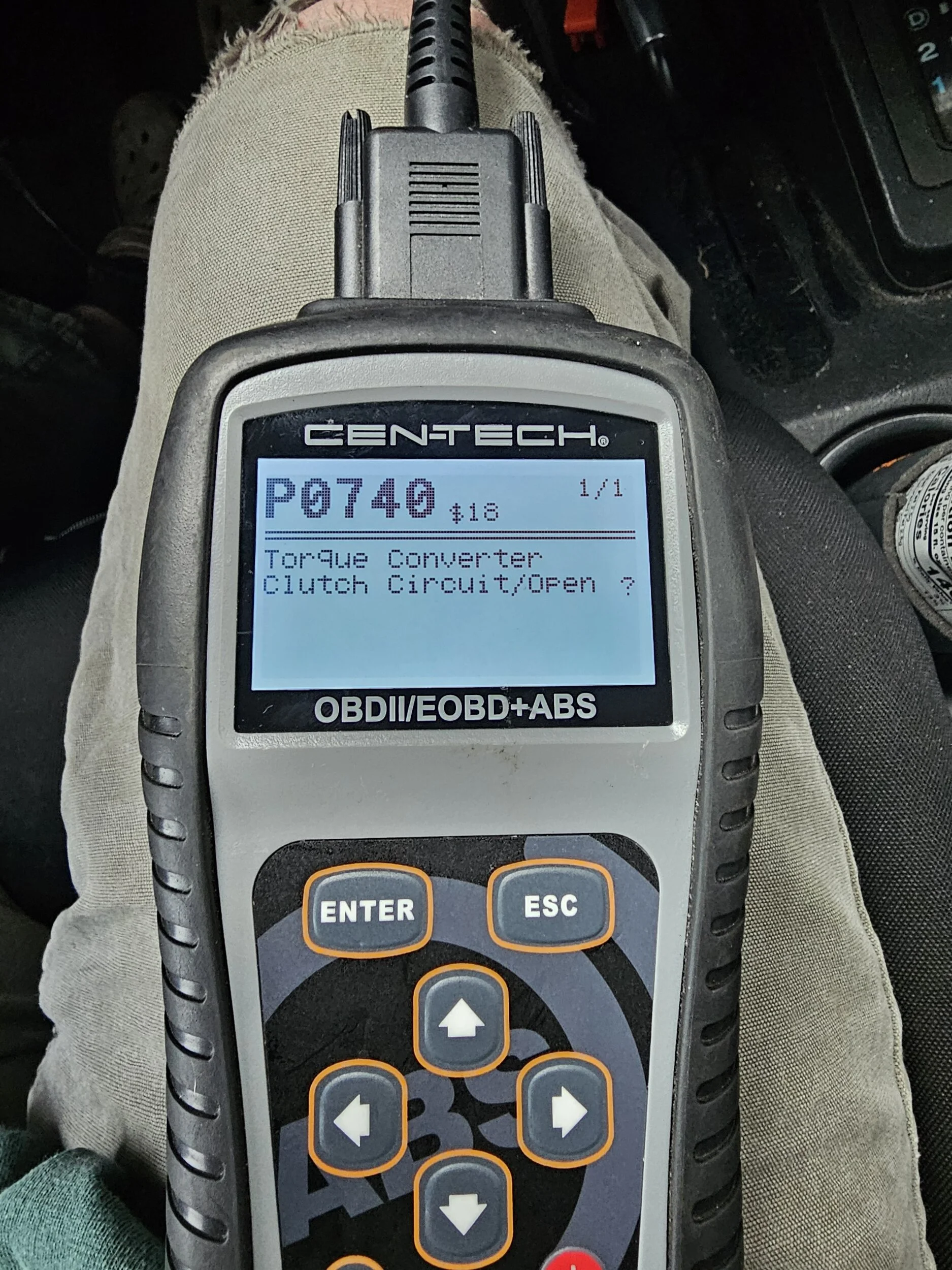

M mcdanjc New Member Joined Feb 9, 2026 Messages 1 Location Oklahoma City Feb 9, 2026 #44 Did this ever get a fix? I am having a very similar problem with mine!
