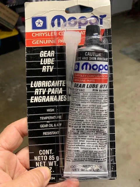

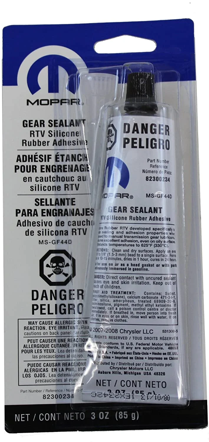

I don't know about your 30RH but it's common for some automatic transmission pan bolts to require an ATF resistant RTV to be applied to the threads or they'll leak otherwise. Have you looked at the FSM for your year to see if any of yours do?
Hi Jerry. Would you just remove a pan bolt, then apply RTV to the threads and replace the bolt. Where would you purchase ATF resistant RTV.
