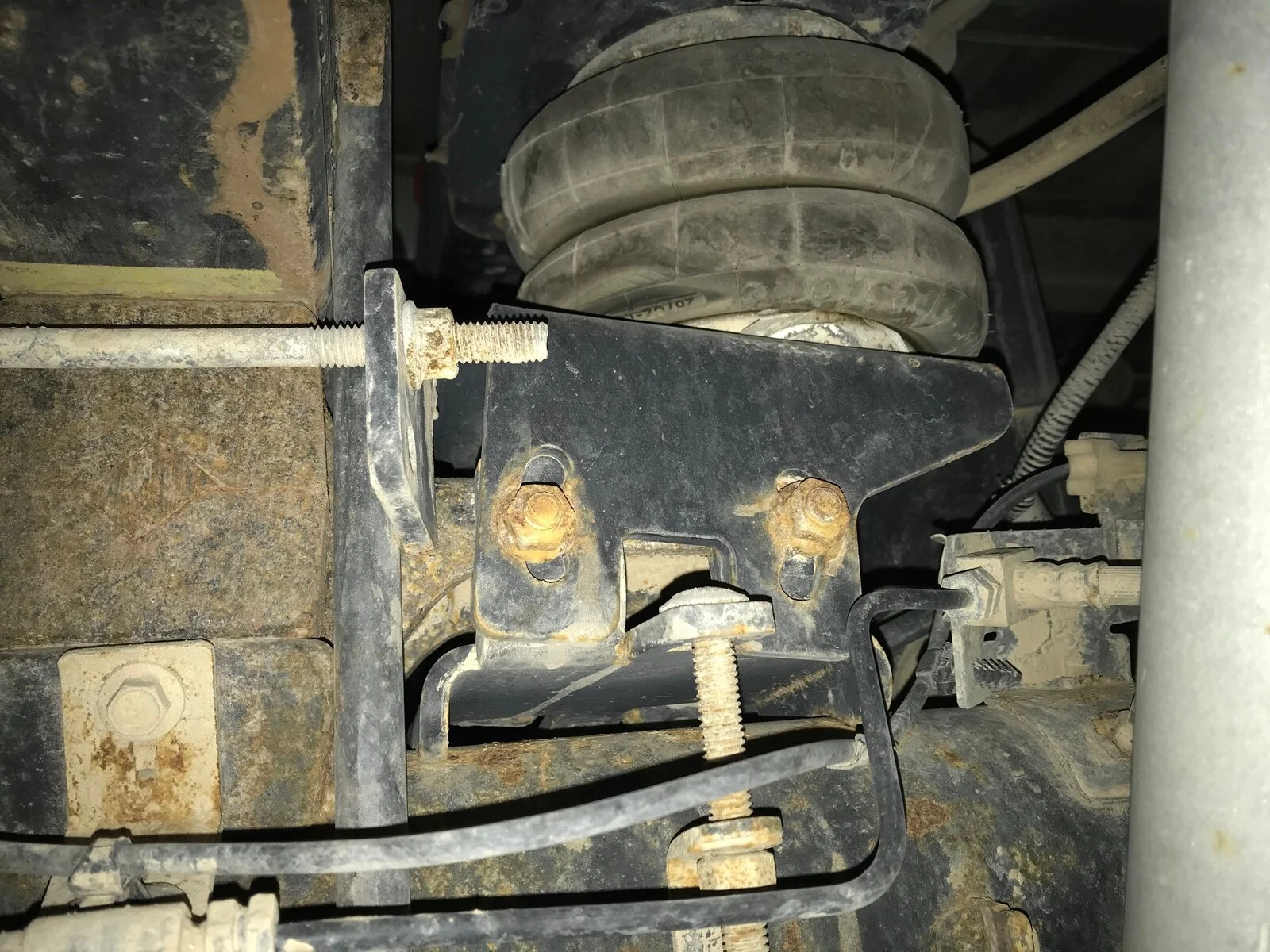

An observation about Firestone bags: They are not up to the job on an F350 without modification. They consist of upper and lower clam shells that are held together with bolts in slotted holes. The top half will slide to the bottom of the slots regardless of how tight the bolts are. I replaced the bolts with grade-8 bolts so I could use more torque on them and the results were the same. I solved the problem by installing aluminum pucks between the top and the bottom halves which prevent them from collapsing on each other. If you have a camper on an F350 and are using the Firestone bags, crawl underneath and take a look. I can almost guarantee that you have this problem.

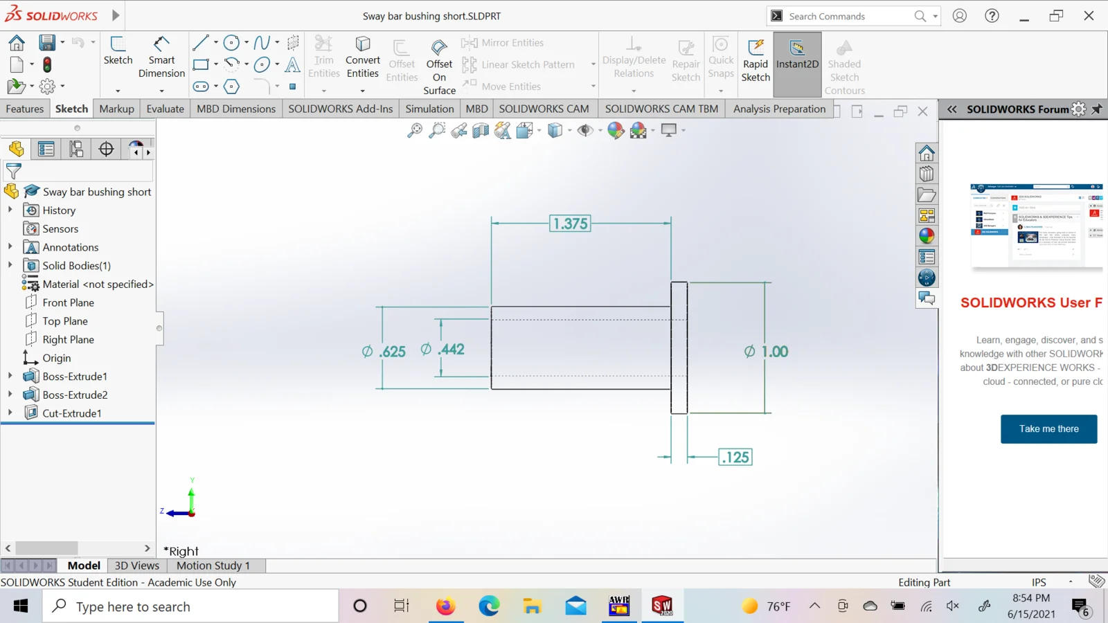

Now Hellwig swaybars: The ferrules through the bushings in the rod ends have no flanges. The swaybar has loose tolerance holes and the ferrules move around a lot, regardless of how tight the bolts are. This quickly wears down the ferrules and also the bolts at the swaybar ends. My solution to this was to weld flanges to the ferrules. This holds the ferrules square with the swaybar end and prevents relative motion. This seems to have solved the problem.

I am referring to the brackets that bolt to the axle, not the frame. The airbags fit between these brackets and the bracket that bolts to the frame. I will try to get a picture of it later. Perhaps the system designed for the dually is different.

In this picture you can see the upper and lower brackets on the axle. Note the slotted holes and bolts on the side. I used a 3/4 inch puck which really wasn't enough, hence the top bracket is still angled down slightly, but it was good enough. The puck bolts to the bottom side of the upper bracket and rests on the OEM axle bump stop.

This is a Solidworks drawing showing the dimensions of the flanged ferrule. I ended up welding this up rather than machining it.

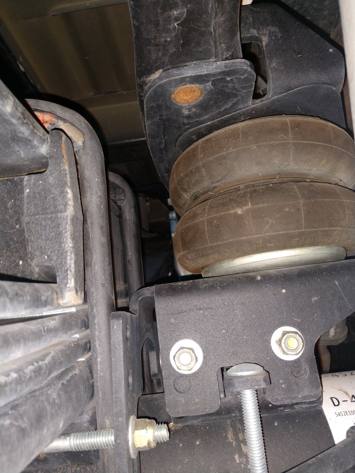

you must not have been the only one who had a gripe with their design because mine purchased 6 months ago looks like this
