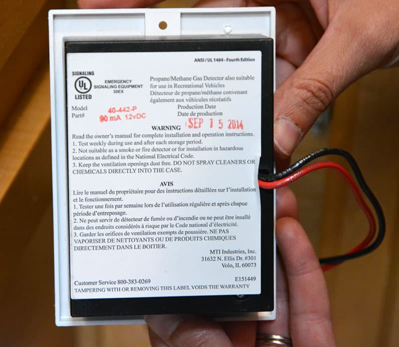

The first thing to smell for is propane. While it’s highly unlikely that you will smell propane in a used camper, it’s possible if a unit has been closed up with open propane tanks.
If you smell propane (in any camper), do not enter the unit and leave the rear door wide open. The propane and propane smell should dissipate quickly. If a propane leak is suspected, a certified RV technician should be immediately brought in for a propane safety inspection.

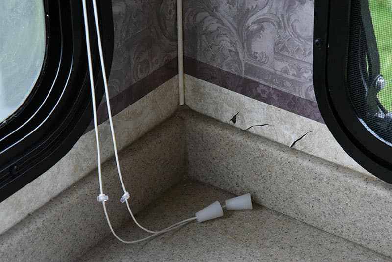

If a camper passes the smell test, the next step is to visually inspect the interior. First, check the ceiling for water stains, deformed material, or any other possible signs of water damage. We recommend a high quality flashlight for this step.
Above: Rippled and/or ripped wallpaper could be a sign of water damage
Next, open every cabinet throughout the camper and inspect the floor, walls, and ceiling inside that compartment. Again, what you’re primarily looking for are any signs of water damage. If you open a compartment and it smells musty, that’s a possible sign of water damage.

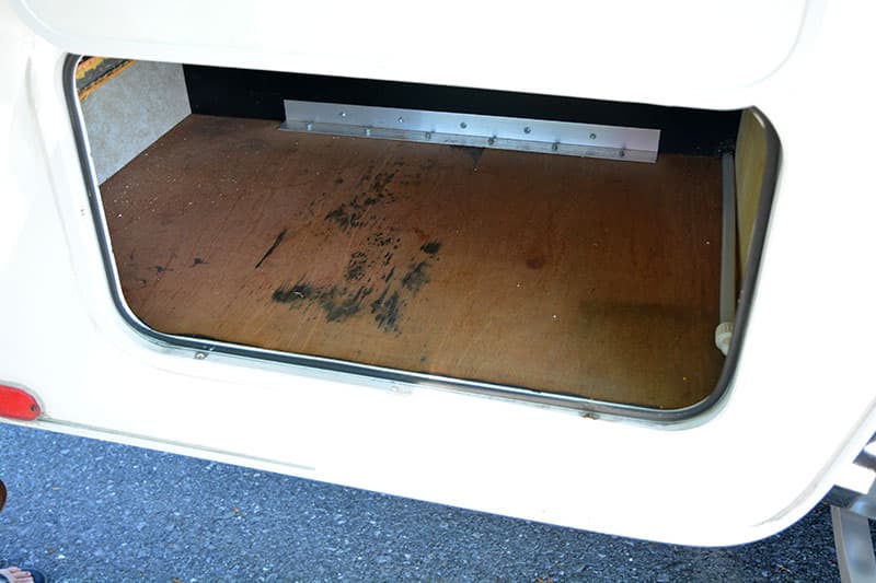

Above: The propane compartment is another area that should be inspected. The spots on the rear wall and floor are propane oil; a sign that the regulator should be replaced.

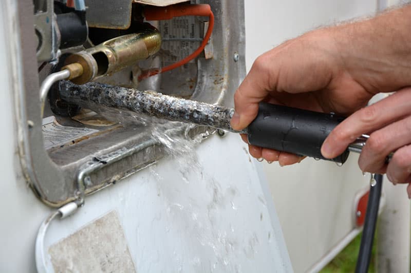

Above: Suburban water heaters have anode rods. Before using the camper you should inspect the anode rod condition and replace it if needed.

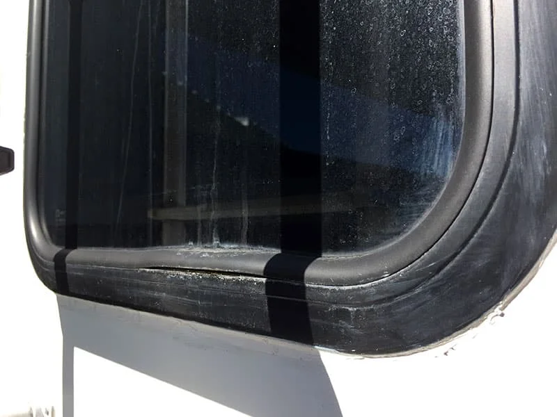

If the inside of the unit passes the smell, stain, and turn-on tests, it’s time to get out and inspect the exterior. Here we continue the search for potential water damage by really getting pushy.

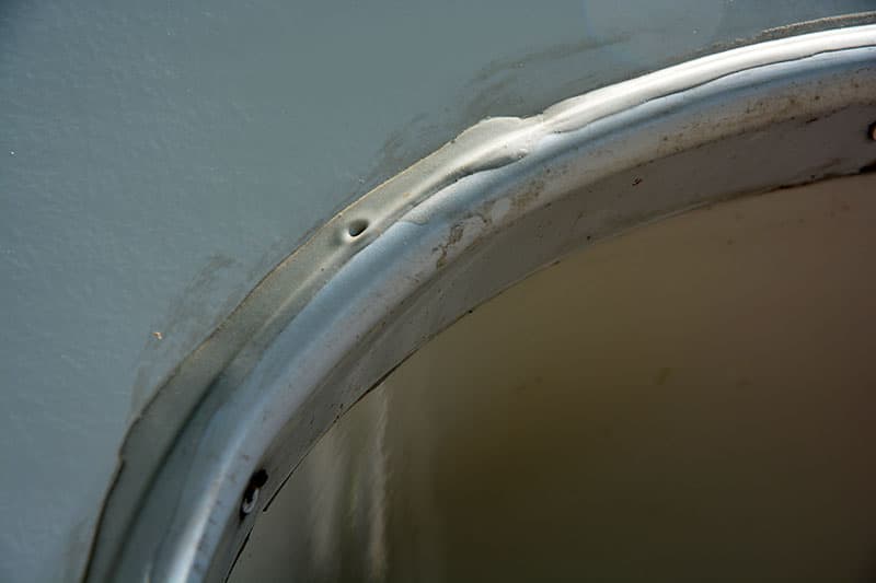

Above: Take careful note of anything of concern, like this split window seal
As you walk around the unit, place a flat hand on the exterior walls and push. The exterior walls should feel uniformly firm. Push on the front nose area, front wall, lower mid section, rear wing walls, and rear walls. Basically, push on all of the exterior walls and surfaces. You may need a ladder to reach some of the higher areas of the unit. Be careful.
If a wall area feels soft, that’s a sign that there’s possible water damage in the wall. By pushing on the wall in different areas, you may be able to discover where the possible water damage starts and ends. Sometimes the push test can lead you right to the leak source. For example; broken seals around front or rear marker lights.
If you find a lot of soft wall spots, walk away from the camper. Fixing water damage is a major job that requires tearing out and replacing the water damaged siding, framing, and insulation. Unless you’re looking for a rebuild project, this is not the used camper for you. Look for a used truck camper with firm exterior walls.

Well, things haven’t worked out like that. After several years of talking to the truck camper manufacturers, dealers, and other RV repair professionals from coast-to-coast, we have confirmed one thing; there is no simple or reliable solution to de-lamination.
If we ever discover a proven solution that makes sense and is remotely cost effective, we’ll do it and report our experience. Until then, de-lamination remains unsolvable. You’ve been warned.
The best answer to de-lamination is to fix its likely cause; a leak from broken seal. We sealed our camper as tight as possible, and learned to ignore the de-lamination. Believe it or not, this is exactly the course of action our most trusted industry advisors gave us. Seal the unit, and live with the de-lam.

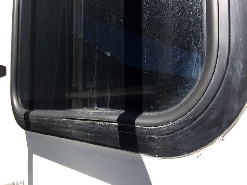

Above: See the crack in the corner of this skylight? That’s a leak!
The seals should also be free of punctures or tears. The sealant on the roof should be a little soft and squishy, not hard and dry. You should be able to firmly push into the seal and have it return to form. If roof seals are hard and dry, they will crack and create leaks.
Vent and fan covers should also be free of punctures and cracks. It’s not unusual for plastic vent and fan covers to develop cracks over time, and leak. We have replaced several in our camper due to cracks from old age.

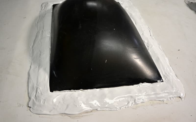

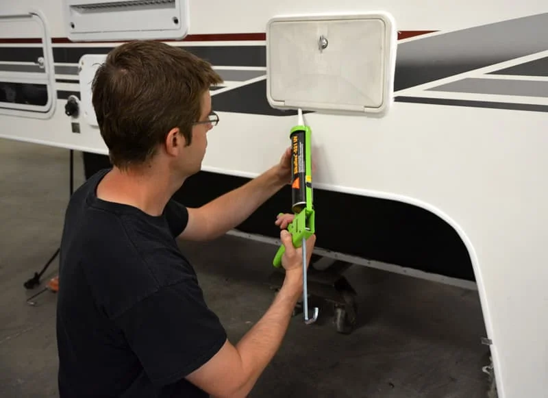

Above: After we saw the cracked seal (above) we removed the old caulking and applied new self leveling roof sealant. This an example of what maintained roof seals should look like.

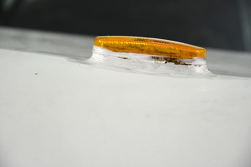

Above: Marker lights are an area where people forget to check. See the cracked seal where the lens meets the base? That’s a leak!

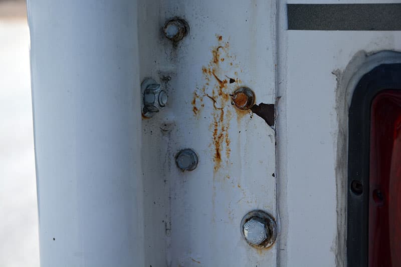

Above: Jack bracket powder coating and screws are an area to inspect. The brackets were cracked and rusting when we took possession of our project camper
This includes the seams around exterior windows, compartment doors, vents, side lights, marker lights, jack brackets, and beyond.
Where any two things meet on the outside of a camper, there’s a seal that needs to be checked and maintained. In the picture above, there’s a hole in the seal. Depending on how deep that hole is, it’s a possible leak.
Above: This front wall seal under the cabover is cracked, brittle, thin, and in desperate need of removal and replacement. Old seals like this are likely leak points.
A good exterior seal will be clean, continuous and tight to the camper. The sealant should be just a little soft and pliable, not dry and hard. If a seal is pulling away from the camper, is cracked, or has sections missing, it needs to be immediately removed and replaced. Put this off and you will develop leaks.
Again, you should find signs of seal maintenance. There will be places where the sealant has obviously been removed and reapplied. The new sealant might be a different color from less sun exposure. It might also not be as pretty in its application as it was done by the owner, not the factory.
During your exterior inspection, open every exterior compartment door and look at the condition of the compartment’s interior. Look inside storage compartments, battery compartments, propane compartments, generator compartments, outside shower doors, and sewer/service areas and look (and smell) for signs of water intrusion.
Above: An exterior compartment with some minor water damage (dark patches)

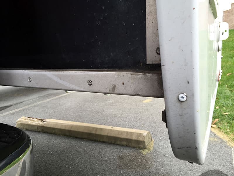

While you’re inspecting the seals around the unit, look at any and all screws you find. Screws that are rusted, loose, or missing are another warning sign of possible water intrusion.
Another trick is to remove a screw and see if the threading is rusted and deteriorated. Screws should back out and return with appropriate tension and should not be rusty or deteriorated. If you do this, make sure to remove only one screw, and then tighten that screw back in before moving another.
We discovered a lot of loose, rusting, or missing screws on the underbody of our project truck camper. These screws were all replaced with stainless steel screws. Each of these was dabbed with Sikaflex 521 sealant before being driven back into the camper. One day I would like to replace all of the exterior screws on the camper using this approach.

Another item that’s expensive to replace are the detectors. It’s quite common for smoke detectors, LP detectors, and CO detectors to be out-of-date in a used camper. For your personal safety, we strongly recommend these detectors be checked and replaced prior to using the camper.

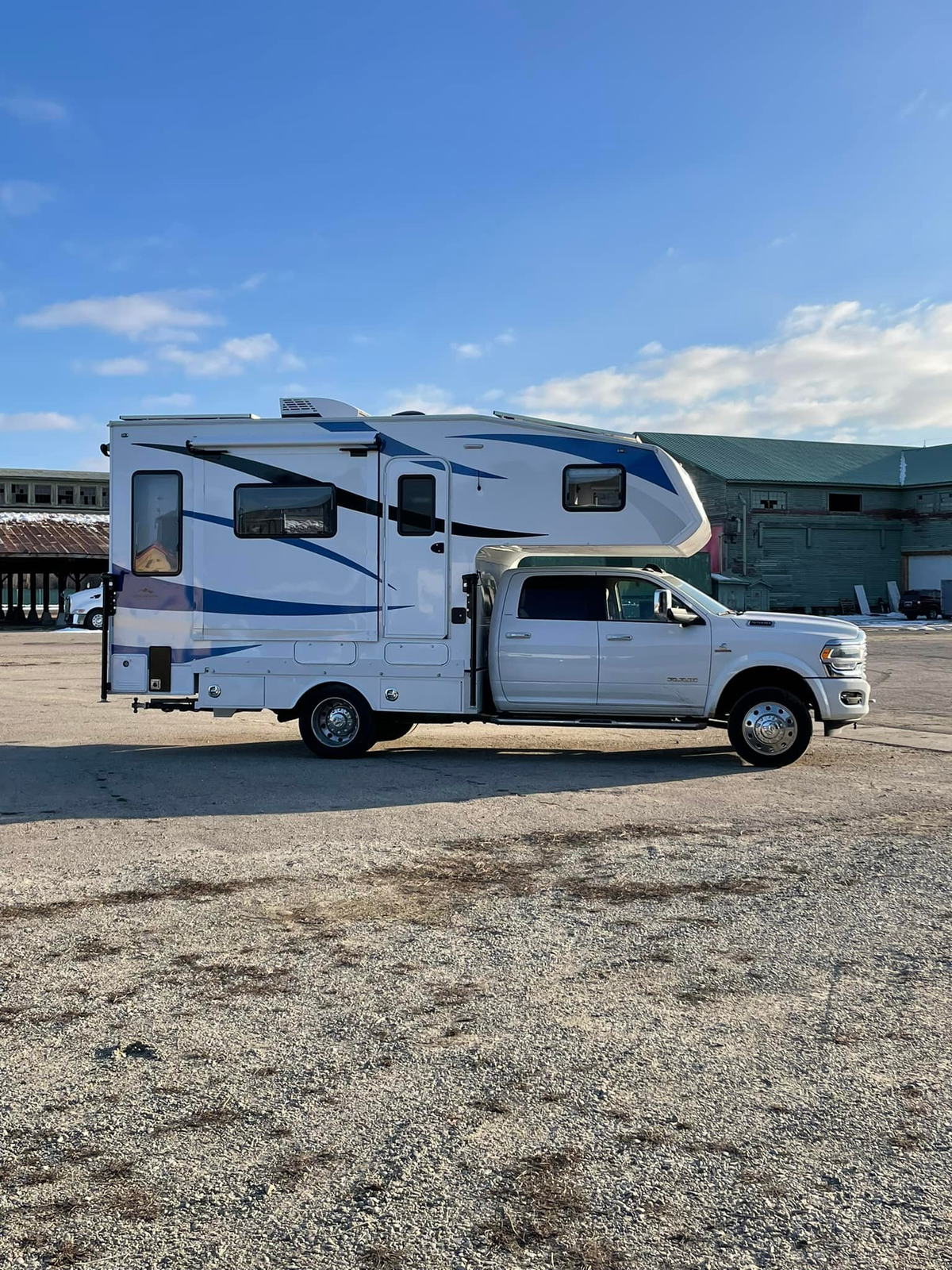

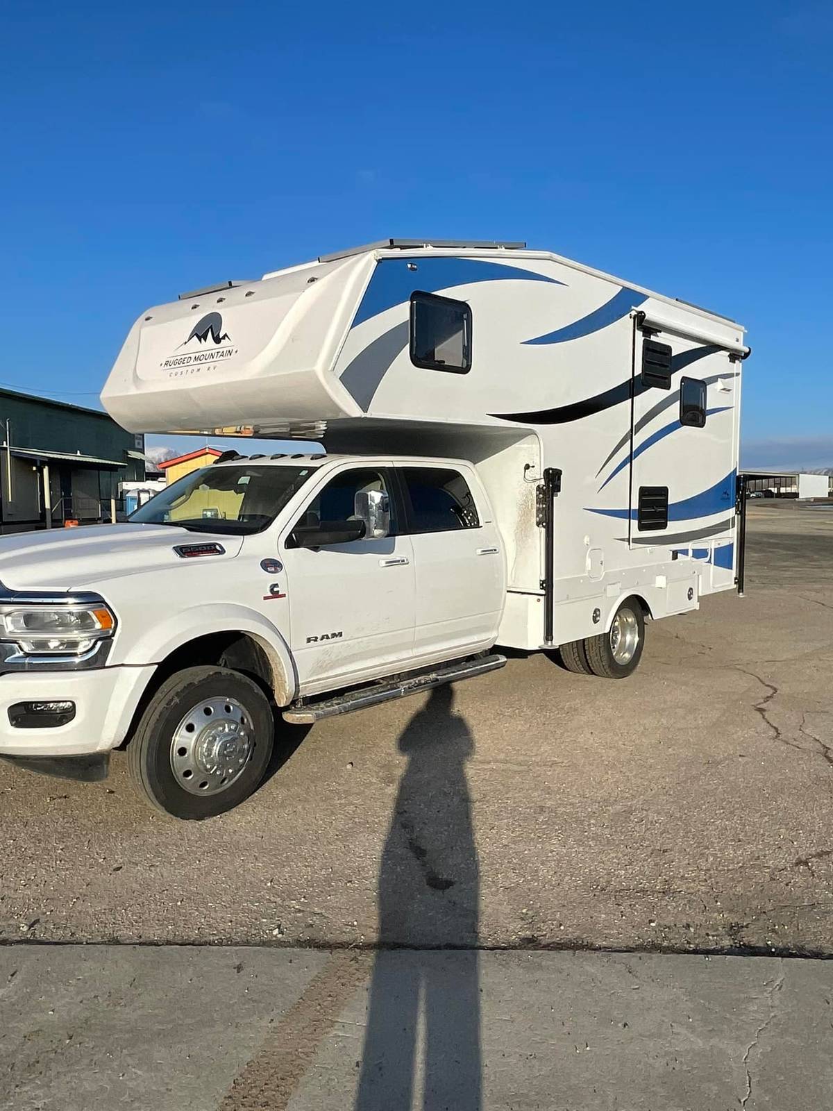

This is a new truck camper company and from what I know has had some growing pains too.
http://ruggedmountaincustomrv.com/
They are from the PNW and the one thing I can say about them that I like more than other companies is they have said they were willing to work with me to customize a camper for my needs.
Here is their new flat bed camper they are showing at the AZ RV show.
