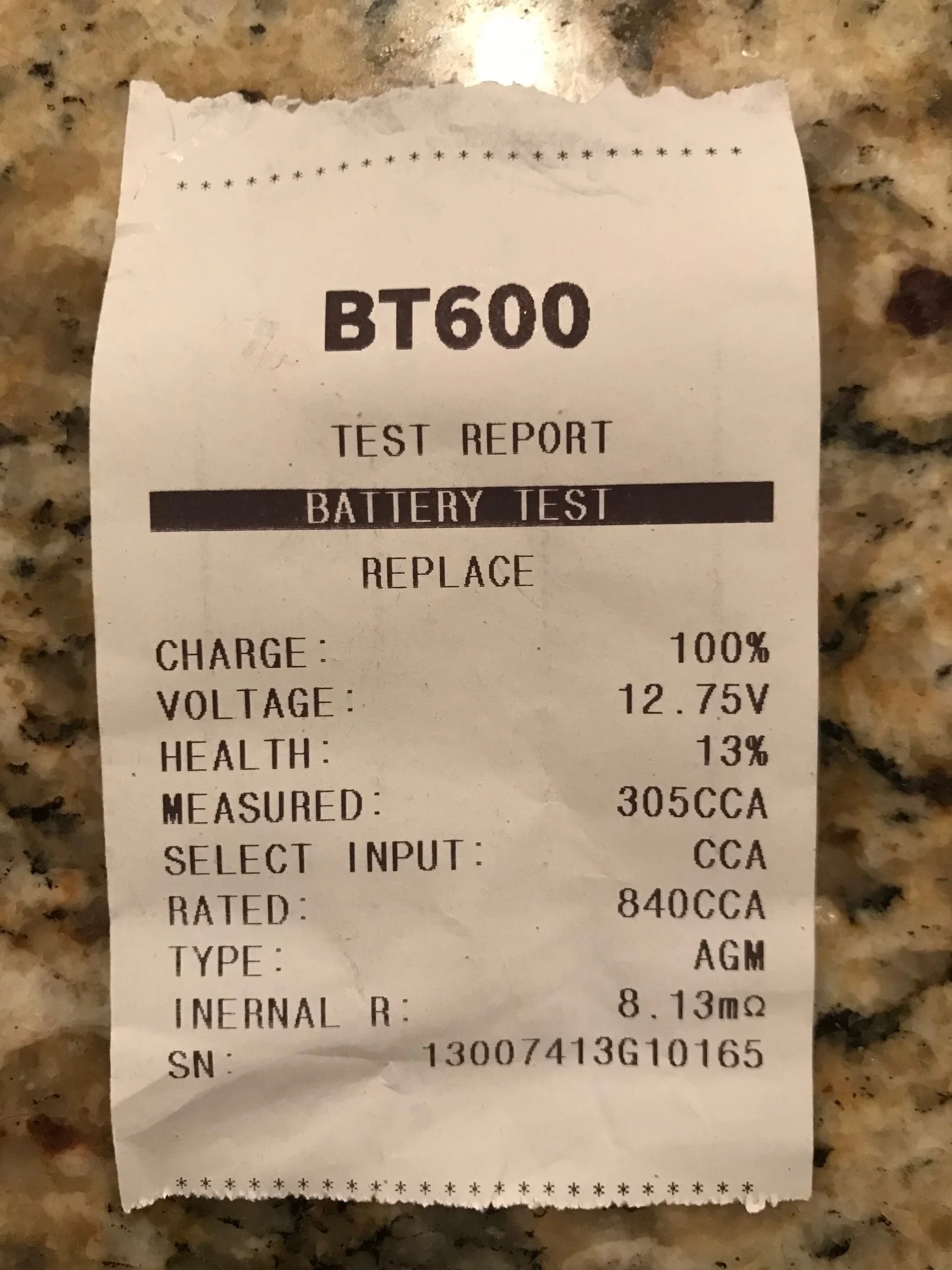

Two Bad Northstar Batteries!

What's your charge voltage? If you don't have a battery temperature sensor, there is a strong chance you are only charging at 13.7-13.8 volts all the time, which will quickly cause an AGM to permanently lose capacity. For an AGM, charge voltage needs to be in the range of 14.2-14.8V in most cases, with 14.4 to 14.6 being ideal at moderate temperatures. 13.8 would really only be appropriate at temperatures exceeding 150°F.
Flooded cell batteries are more tolerant of the low charge voltage, but will still lose capacity more quickly over time if they are not de-sulfated.

Well...My 2 year old Odyssey is toast. Had it tested today...:mad:

Remind me again how you upped your charging voltage.
Two options:
  • External charge controller, like the ones used for bad PCMs
  • Using a tuner, like HPTuners
I did note the @Wranglerfix PCM seems to always charge around @14.5V even though it has the original tune file. Not sure if there's something different there in how it works since it's not a TJ PCM
HP Tuners was what I hoped you were going to say. I'm going to poke around soon to up my charging voltage. Care to point me in the right direction?
I believe in the "System" options there is an Alternator Charge voltage setpoint chart. It varies the PCM charge voltage based on the battery temperature sensor output. If you don't have a battery temperature sensor, it automatically assumes the hottest value, meaning it selects the lowest charge voltage.
I simply bumped up any number less than 14.4 to 14.4, which has worked great and kept my Northstar running perfectly for five years.
