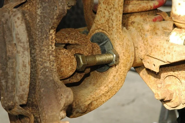

You don't need the hub puller. You can use a bolt between the inner C and the yoke ear. Then you use the steering wheel to force the hub out. Stu has a write up on his archived site.
https://web.archive.org/web/2017111...ffroad.com/axle/unitbearing/unitbearing-1.htm
