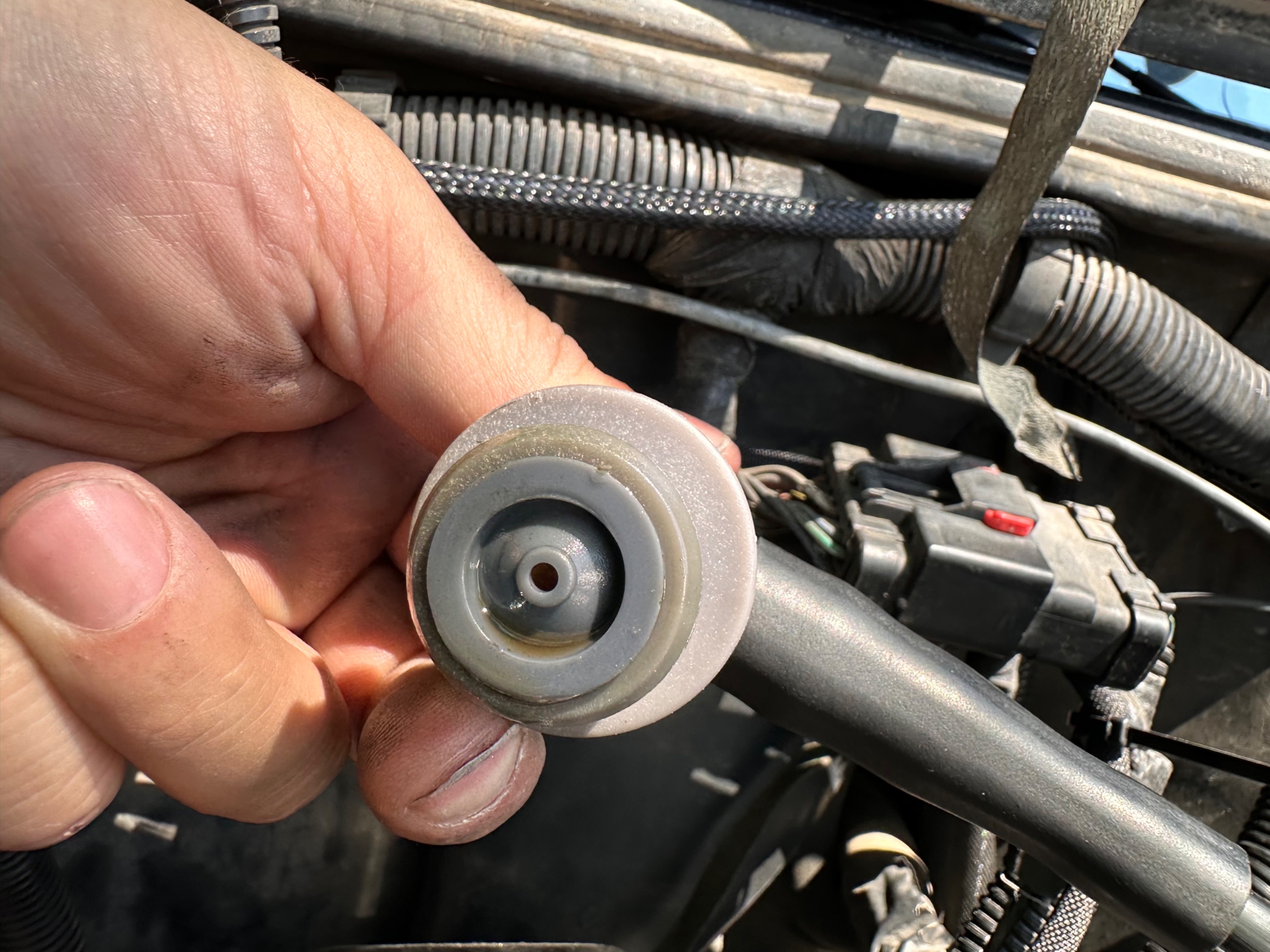

The elbow in the back is gray, and it has the part number 53030495 Stamped on it. From what I’ve read that’s the correct for the rear.
Again, most of the parts lists are WRONG. Looking up that PN online gave me "Crankcase Vent To Air Cleaner Tube" which is also WRONG for the rear. But don't believe me nor the parts lists - inspect it and you'll know in short order - far faster than fiddling with the IAC.
Thanks Zorba, I pulled both front and back to compare, the front is wide open the rear isn’t. Here’s a shitty pic of the rear
