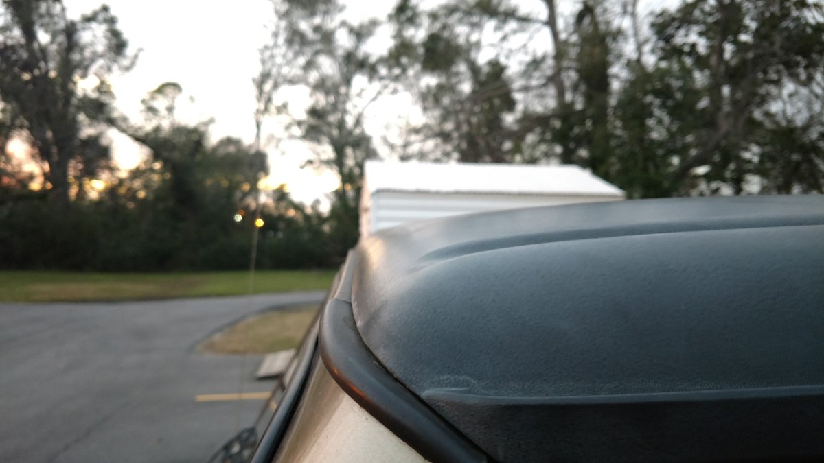

Saw this a few days ago and I couldn't make sense of it. Anyone know why the top would be sitting as far forward onto the windshield as it is?

So, here's a close-up of that top, in the first post.

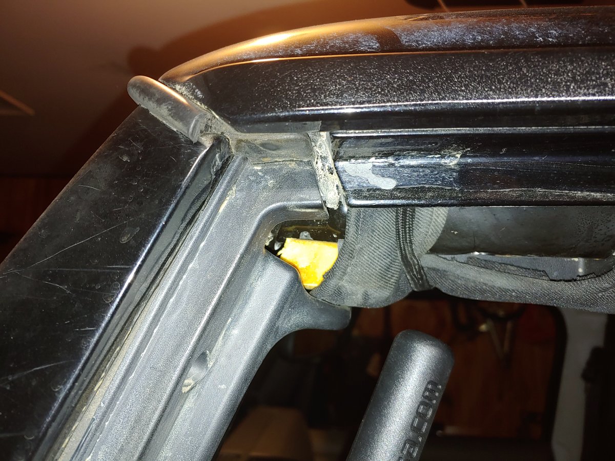

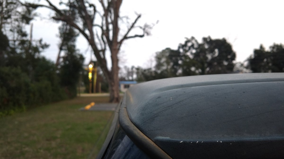

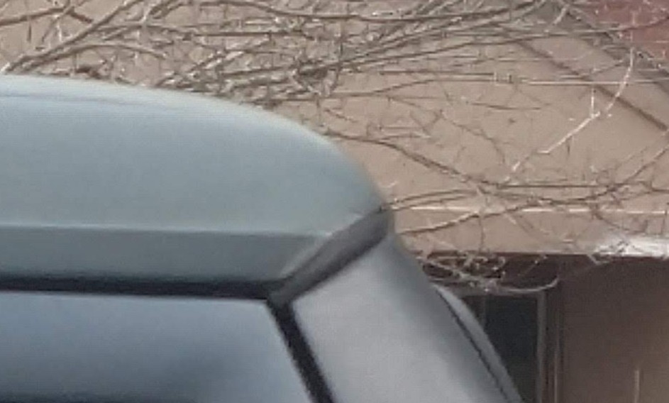

And here's a picture of mine, along with two others.
The only way I know of to get mine to fit like that would be to lean the windshield back further. Can't go any further forward with the top.
In the first pic, look at the point where the windshield frame, door frame, and top all meet. If those corners all line up with each other and looks reasonably symmetrical, you're all good.

I'd eyeballed that area myself. The one in the first pic sits further forward than the other three. That probably isn't helping matters, but I believe they are right with the small seal idea.
It's nice to see my pics being used for good.

As noted, gaskets vary. How it fits relative to the gasket is not what is important. The windshield frame, doors, and hard top are all adjustable. You want them to seal and not look wholly terrible. Front of window frame roughly parallel to windshield frame as long as that doesn't produce a gap elsewhere that leaks. Hardtop forward or back to get the front edge to seal at gasket and not produce too large of a gap at the back of the door. Then that has to be checked to make sure that doesn't interrupt the lift gate seal at the top of the tailgate. Parallel across top of door to hard top as long as that doesn't screw up the door fit in the opening in the tub.
There is not a "this fits this way or its wrong" on most of the crap on a TJ. The whole mess has to be adjusted and made to work.
