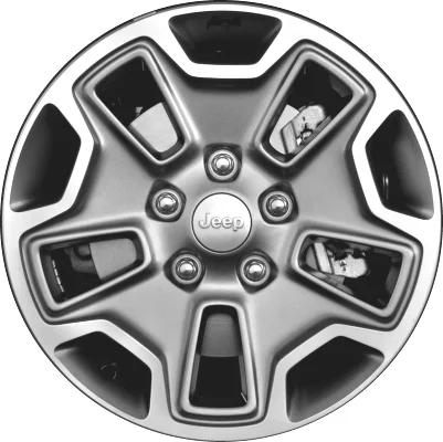

Hello,
I am currently running 235/75R15 tires on Canyon wheels. I have found a good deal on some of the 17" Hardrock Rubicon wheels like in the attached pic. I really like the appearance of the Hardrock, but my concern is how they will look on my stock TJ, because I don't want them to look crammed into the wheel wells. The wheels don't already have tires mounted, so I would buy either 245/75R17 or 255/75R17 tires, and I know I will need a 5x4.5 to 5x5 wheel adapter.
Someone on youtube used the following adapter and liked it: https://www.amazon.com/gp/product/B01IVKIZW0/?tag=wranglerorg-20
I recently replaced my shocks with the Rancho RS5000X shocks and my TJ now appears to sit just slightly higher than it did, and my 235's are looking small, (I did buy the shocks for a non-lifted vehicle). I know others have upgraded to JK wheels, but I generally see it done with a lift.
How do you think these will look with no lift? Will a 1.25" adapter be sufficient, and does the above adapter look like a quality adapter? Will the use of the adapter put excessive stress on the bearings? Any feedback is appreciated.

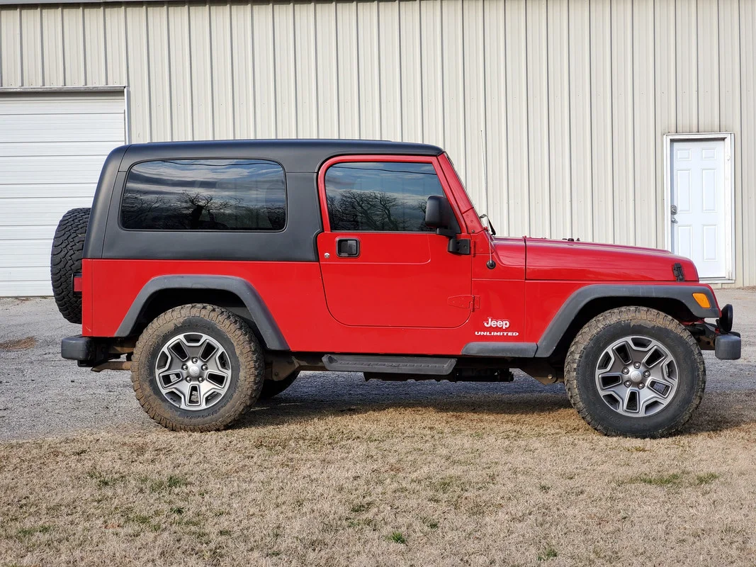

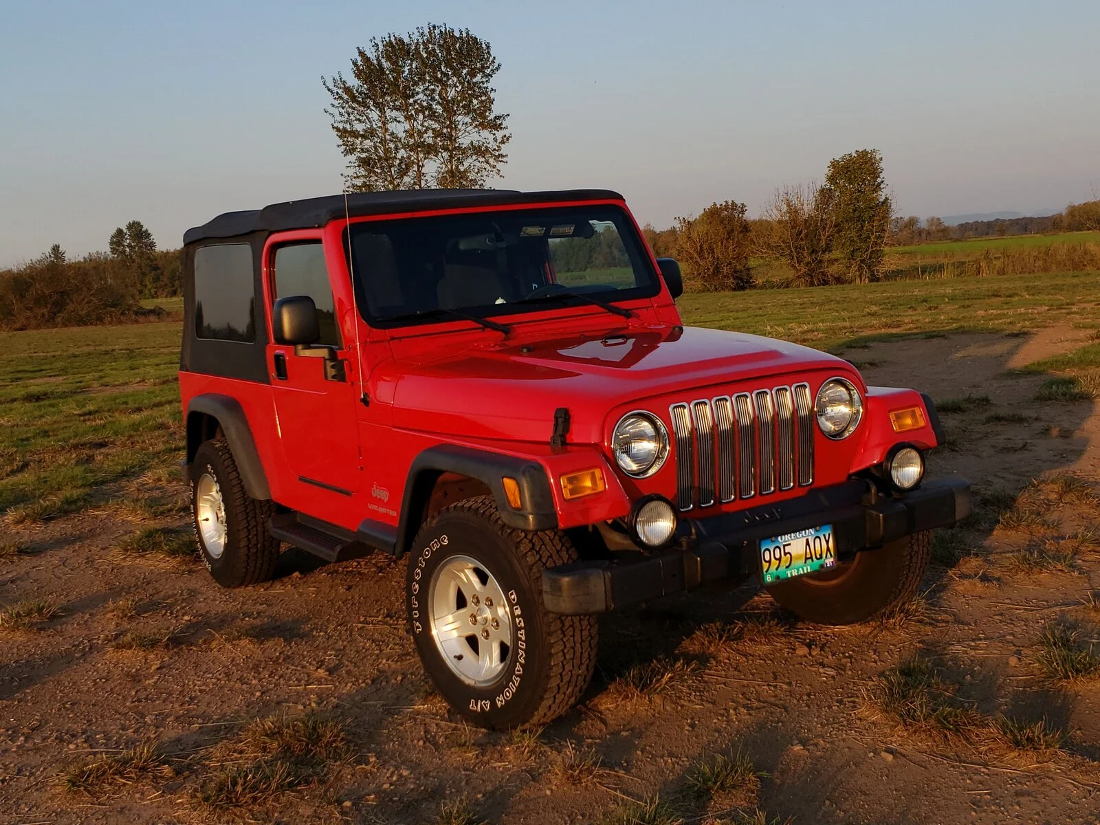

This picture will give you an idea what the JK 17" rims with 255/75/17 Fireston Destination AT 2's on a stock suspension.
Thanks for the pics! Which adapter did you go with? So you get no rubbing? How much clearance is there between the tire and the closest point inside the rear fender well? On my TJ (and I would assume the same on all), if you're looking at the rear fender well on the driver's side, inside the fender well on the lower left there is a plastic section that sort of bulges out and looks like it could come into contact with a large tire.
No rubbing what so ever....
The closest contact points to the rear tires are slightly more than 2" to the spring bucket and the plastic bulge towards the front of the fender well. The spacers are 1.5", but I purchased them so long ago that I do not know who the manufacturer is....

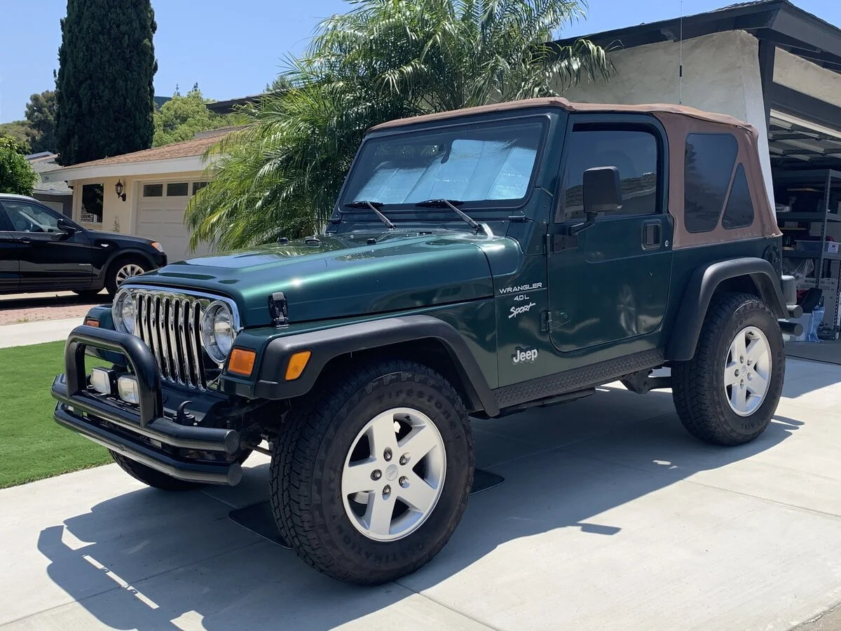

Those are nice. I got some 2018 JLR take offs with 33” BFG KO2’s I want to put on my ‘98 TJ after the OME 2.5” lift.

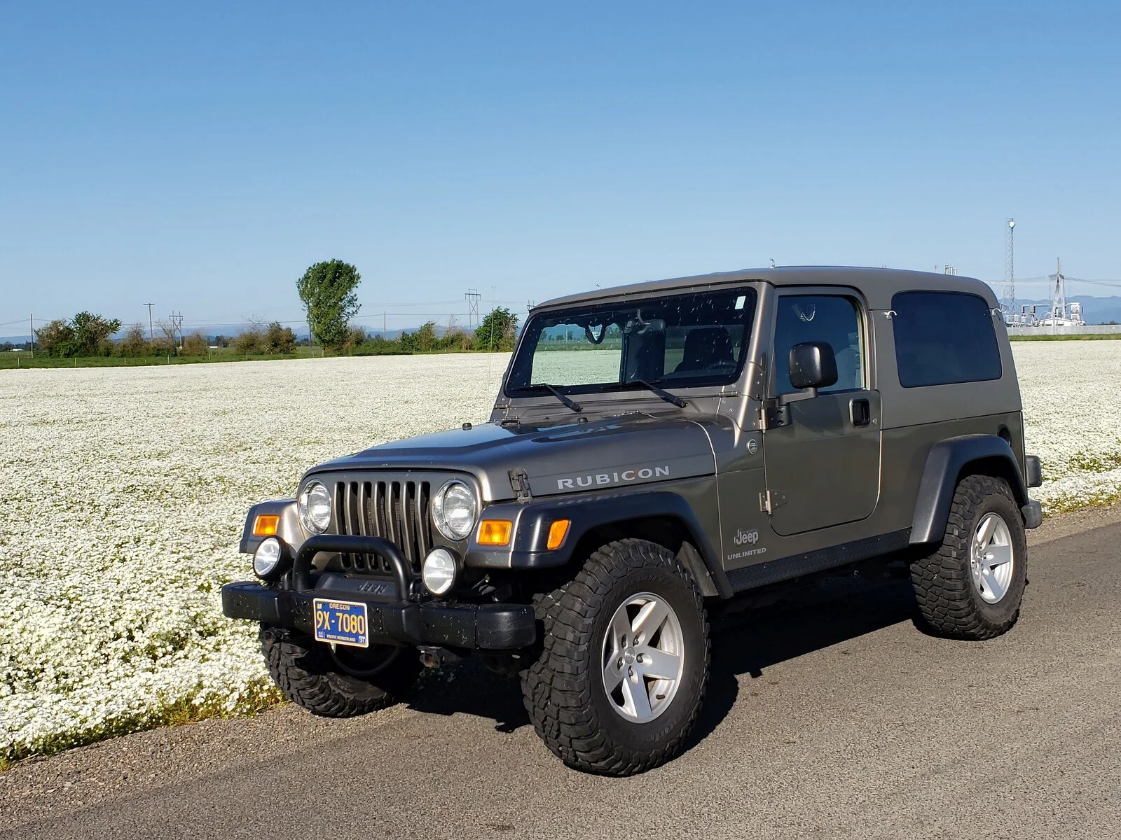

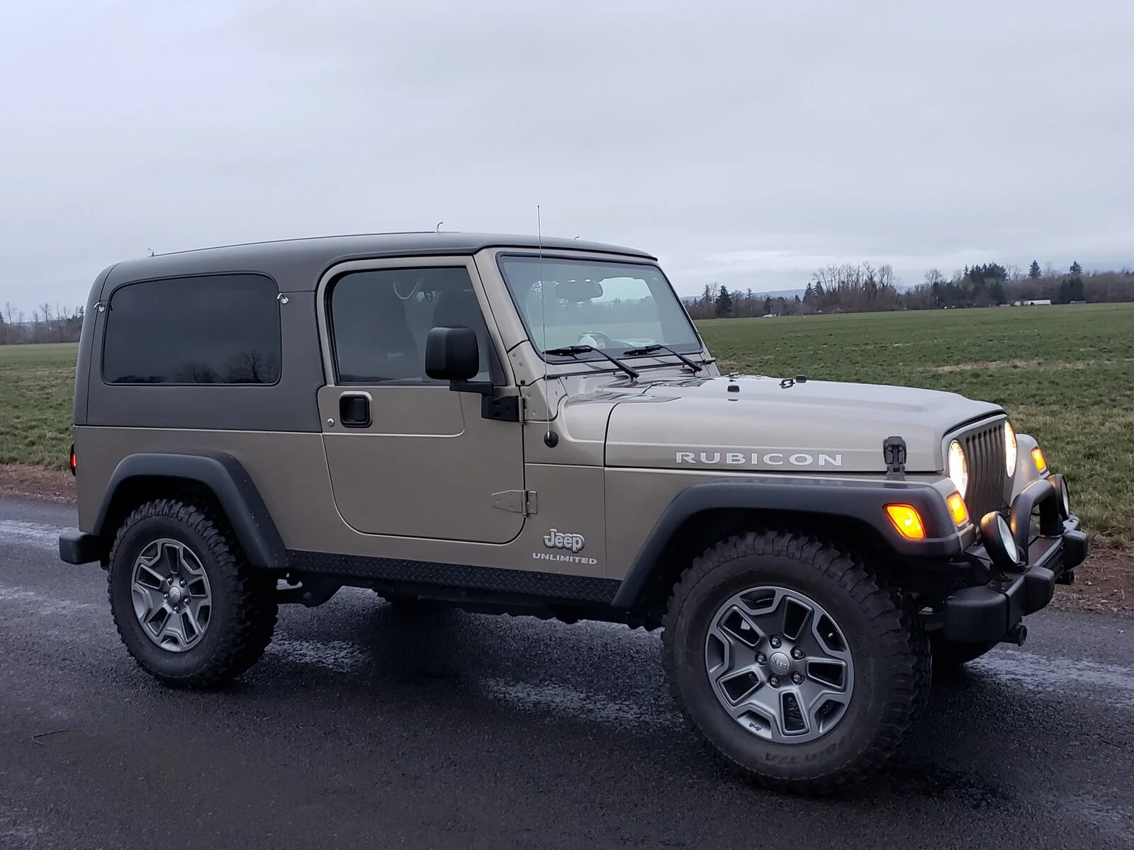

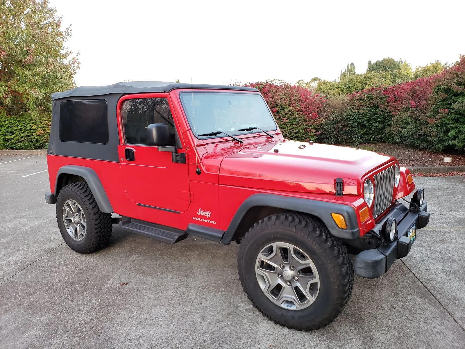

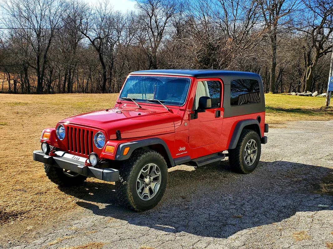

I used the blue SpiderTrax, which I think are the same as your link, and had some rubbing at full turn on the Rubicon but this Sport has ZERO issues with the exact same set up (each LJ is bone stock). Speedo is a little off, but not enough to earn me a speeding ticket and both are automatics — no obvious issues with shift points.
The wheels live on the red Jeep now and I have a little rub with those bigger tires on the Rubi on the stock Moab wheels.

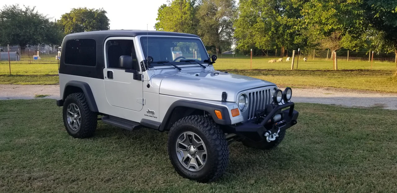

Hit me up if you ever want to part with the Grey Rubicon LJ with those wheels.
