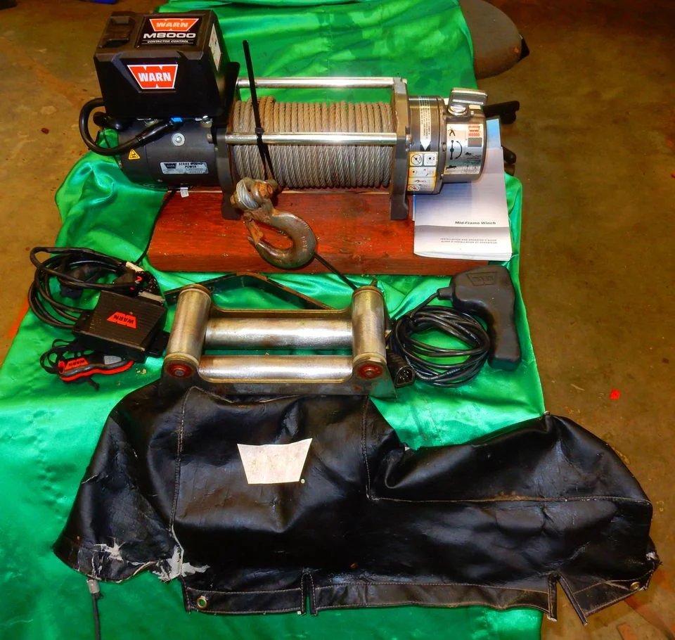

I'm shopping for a winch and it looks like I can get a warn if I stick with steel cable. There's a used, newer m8000 for $550 w/ wired and wireless controllers. Or I could get a newer VR 8 fro $590. What would you get?
If you are willing to do maintenance on it I would go with the M8. If the VR you are looking at is the new Evo it will be better sealed but IMO not as well built.
Go for the M8000, the VR series are all imported from China. And for what brand-new M8000 winches sell for when they're on sale I'd go for a new one. The price on that used M8000 is too close to a new one@
