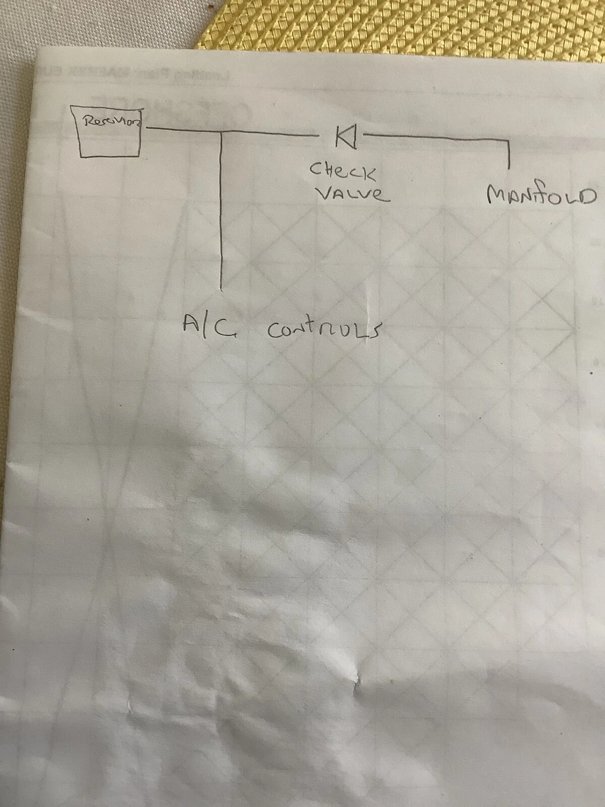

What does it go to?
AC. When I have the fan direction set to the vents and get on the throttle the air diverts to the floor and defrost. When I let off the throttle the air then blows back thru the vents as it should. Seems to be a vac line so I was inspecting the line and ended up cracking the brittle line myself.
So you have leaks and possibly a check valve issue. You can fix the small lines using 3/32” vacuum hose to repair the brittle parts. If it is damages at the firewall some times you can pull it out with a pair of needle nose plyers, if you cannot access it I use a antenna or welding rod and push a piece of vacuum hose through the grommet and connect it behind the glove box. I will spray the line with carb or brake cleaner and push the rubber hose on this will glue it enough to hold. Here is a quick diagram of how it should be set up. Here is a search of what you can find to make your own. You can use just rubber vacuum hose. Manufactures use the plastic because it is cheap.
