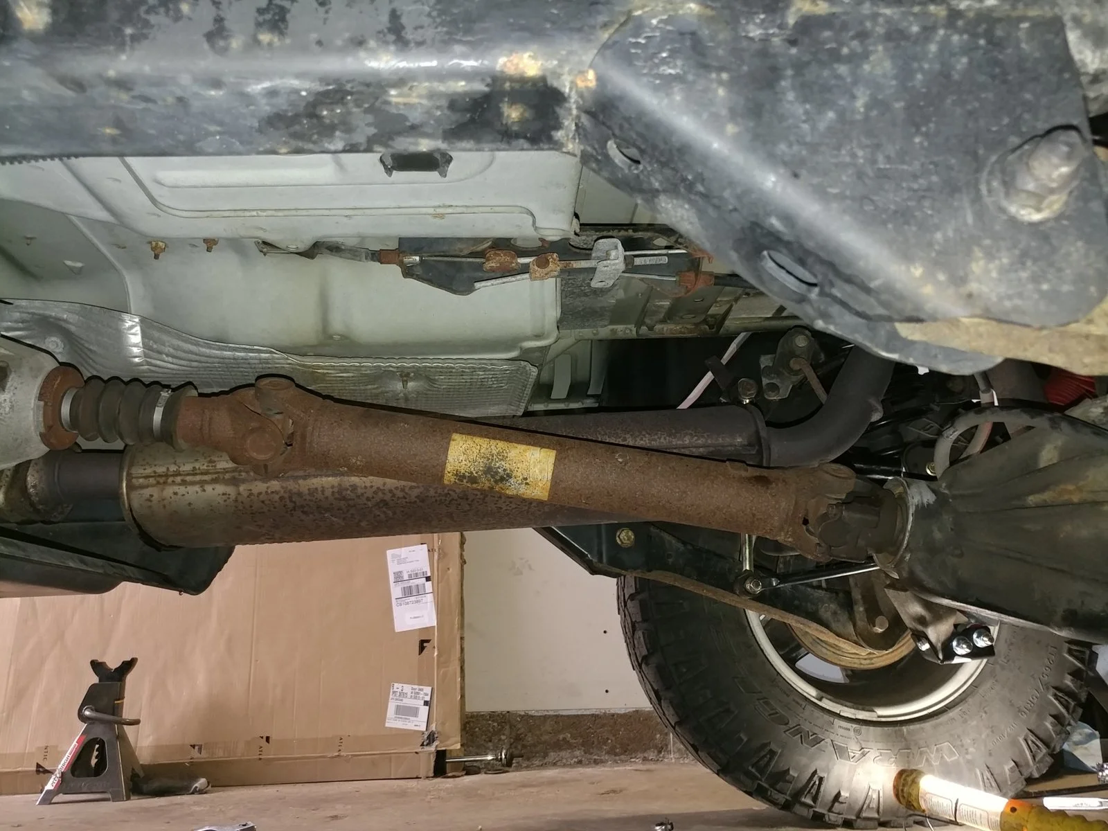

After the TC drop:
Reactions: JMT
Much better angle. An sye is probably in your future anyway as the tummy tuck is going to need it generally speaking.
