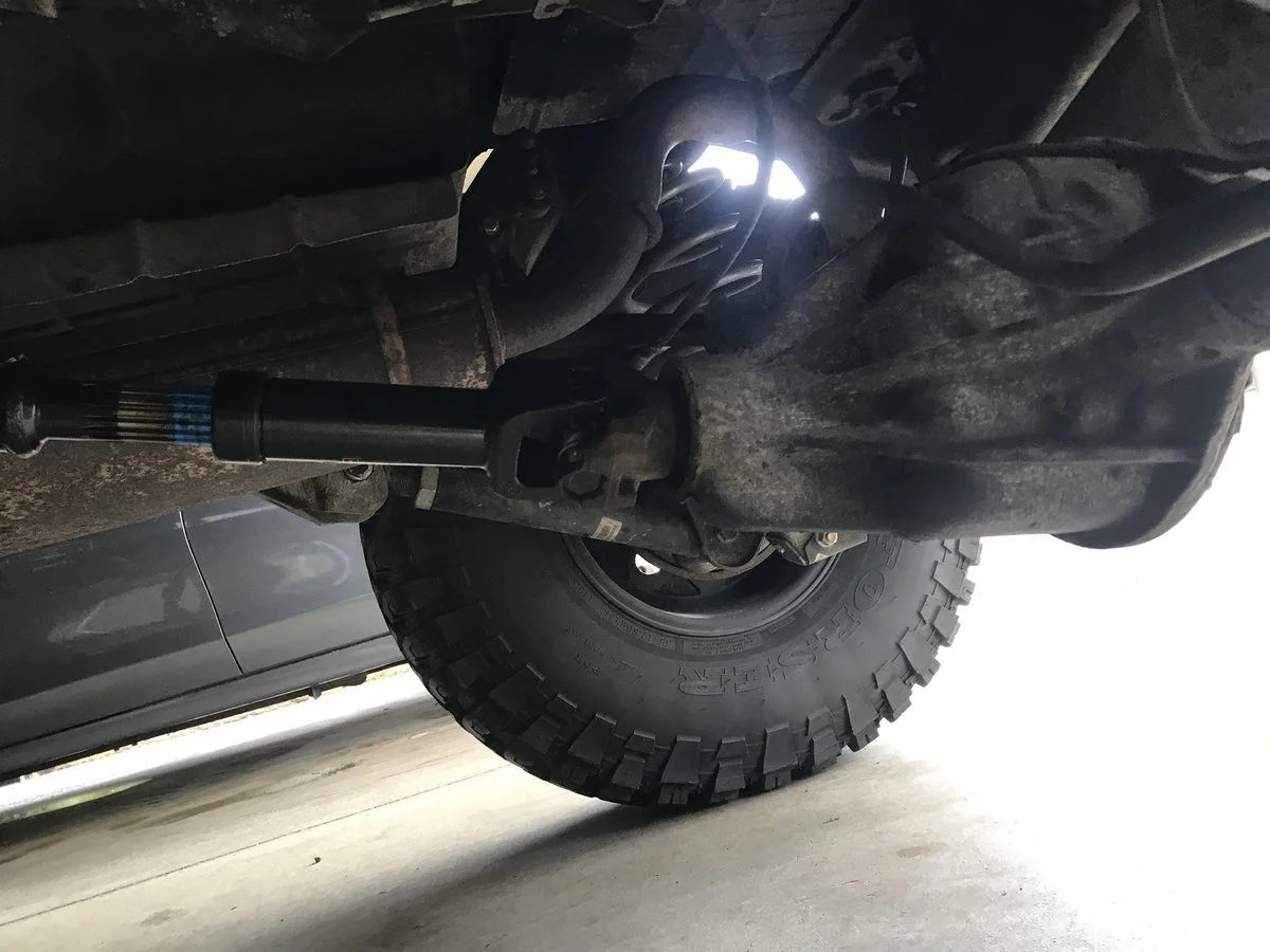

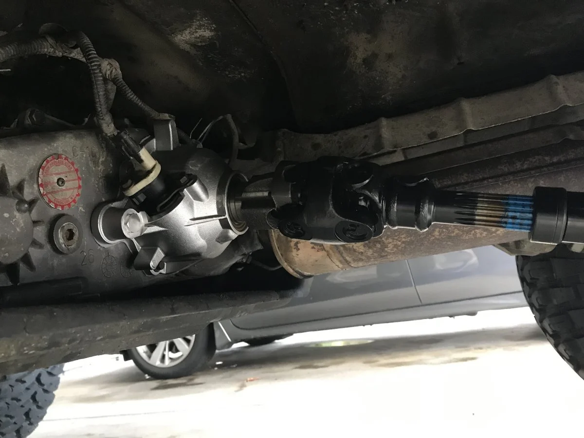

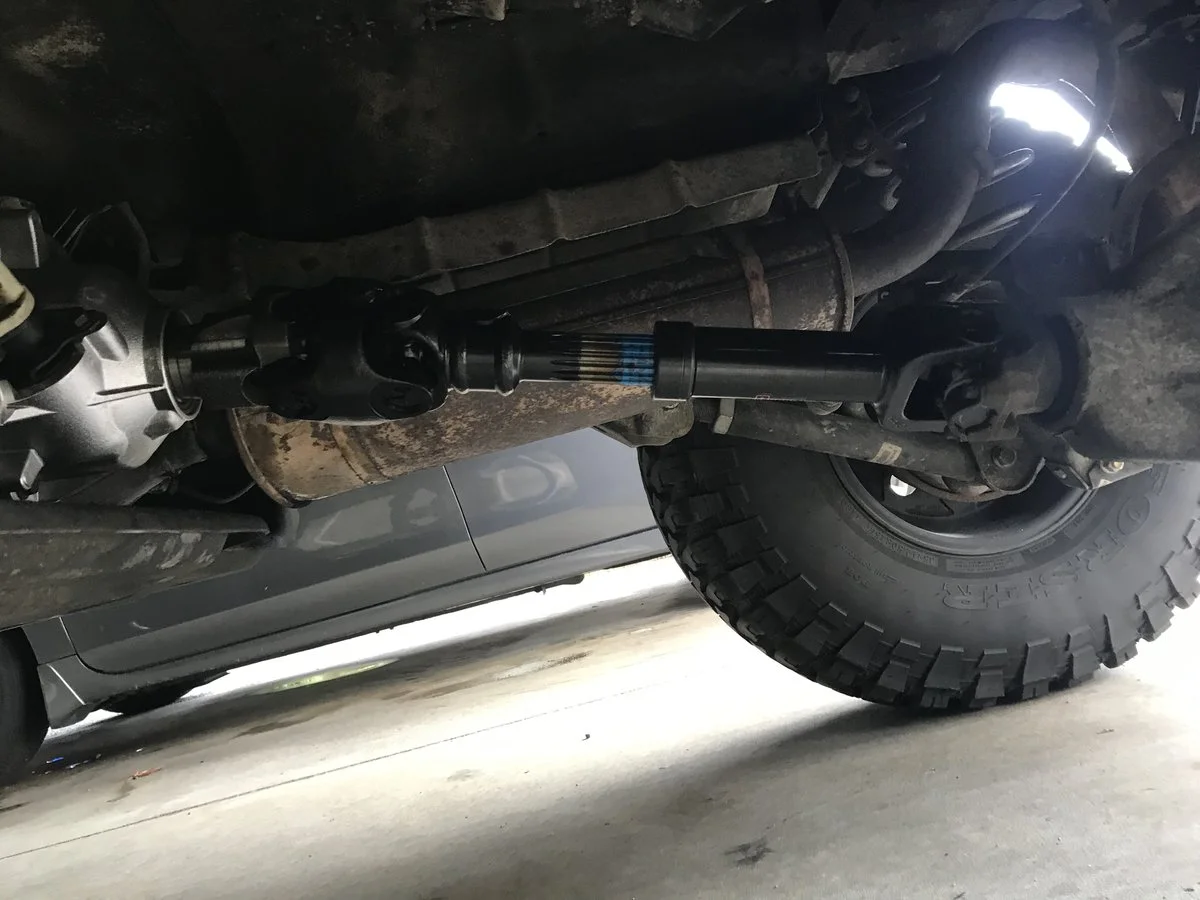

Hi all, better late than never....
My driveshaft:
https://www.northridge4x4.ca/part/r...ft-rear-extreme-duty-solid-1310-cv-driveshaft
and my SYE kit:
https://ruggedridge.com/np231-slip-yoke-eliminator-sye-kit-18676-60.html
Are both installed. See pictures. The vibrations are WAY better. The wheel doesn't shake when going from first to second gear (automatic) AT ALL! and that wall of vibrations at 80 km/h are not there. The only bit of stuff I get now I think is from the blocked catalytic converter. I have yet to do that since I ordered a full exhaust replacements in 3 parts.
I have since realized i have an issue with my speedometer. So 80km/h on the speedo means 95km/h on my phone app. 100 on speedo is 117 on phone. I frankly cannot be bothered to fix this for a while but this was the same both before and after the installation of the SYE.
In short this for sure fixed the problem. I do realize my rear pinion angle could be a little straighter with the driveshaft. I'll get this done eventually as I don't think it's off by enough to hurt anything after all..... no vibrations.
Cheers!
Congrats on getting it fixed!
The pinion angle looks like it still might be a little low, so that could potentially cure even some more vibrations if you get it dialed in even more. Sometime you have to play around with it a bit and find the sweet spot, as it can be different from vehicle-to-vehicle.

Definitely off just a little. Minor vibration at 0-10km/h. But the driving is way better!
Update:
Had a SYE and adamsDC driveshaft installed. Way better. Certainly the main cause of the vibrations. I still need myrear pinion angle tweaked. I get some random little vibrations here and there.
