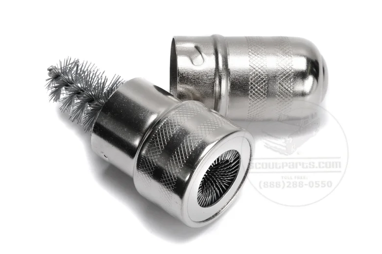

Go buy a $4 battery brush like shown below, then remove both connectors and thoroughly clean both the battery posts and the inside of the connectors. And make sure the connectors are TIGHT when you reinstall them. If you can't get the nut on the clamp tight enough for that, let me know and I'll tell you how to get it to clamp the connector onto the battery post tightly again.
