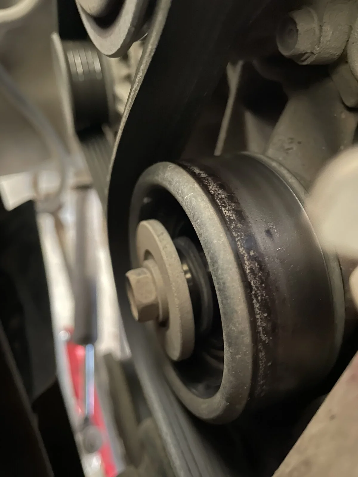

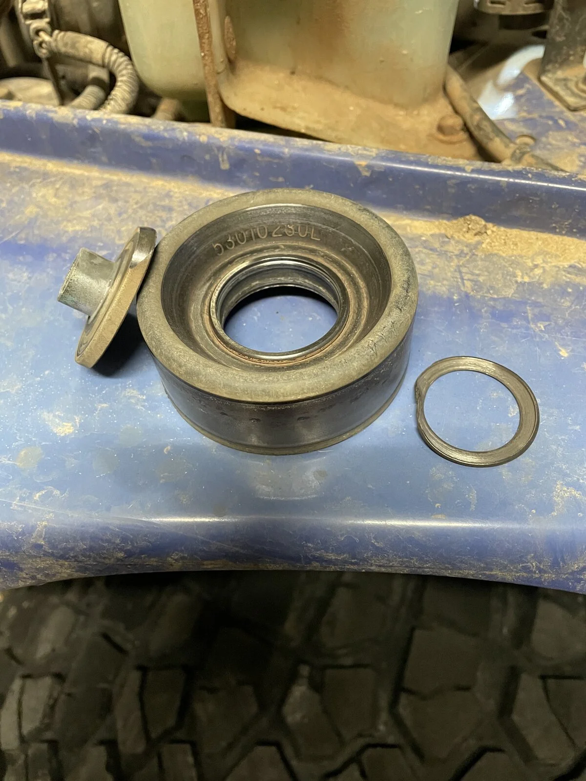

I think I found the problem. Idler pulley looks like it may have broke at the bearing or something.
I set the tension correctly several months back, but it was definitely loose when I checked it so I’m like “why would it lose tension all of a sudden?”
And now we know why.
Reactions: pagrey
If it's just the bearing allot of places like Napa sell them and you can just press it in. I've done it a few times. Water splashed on the metal outside ring can crush the bearing.

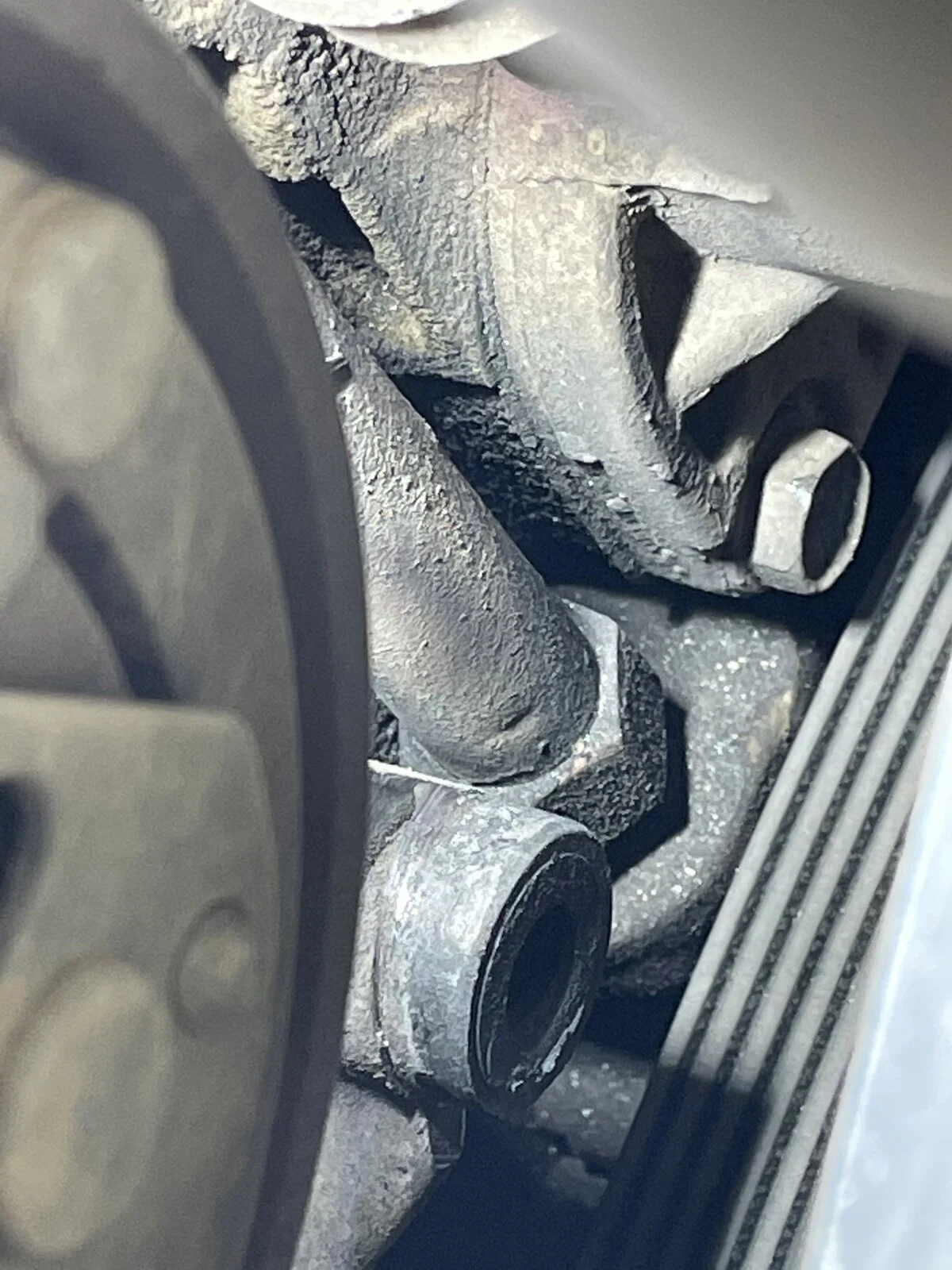

the dust washer is all bent and the bolt sleeve appears to have worn super uneven. New one already on the way.
Looks like it wore on the mount, and even put a small groove in the pipe that connects to the heater core hose. (Barely visible behind the AC compressor). There are metal shavings/dust all over this area.
