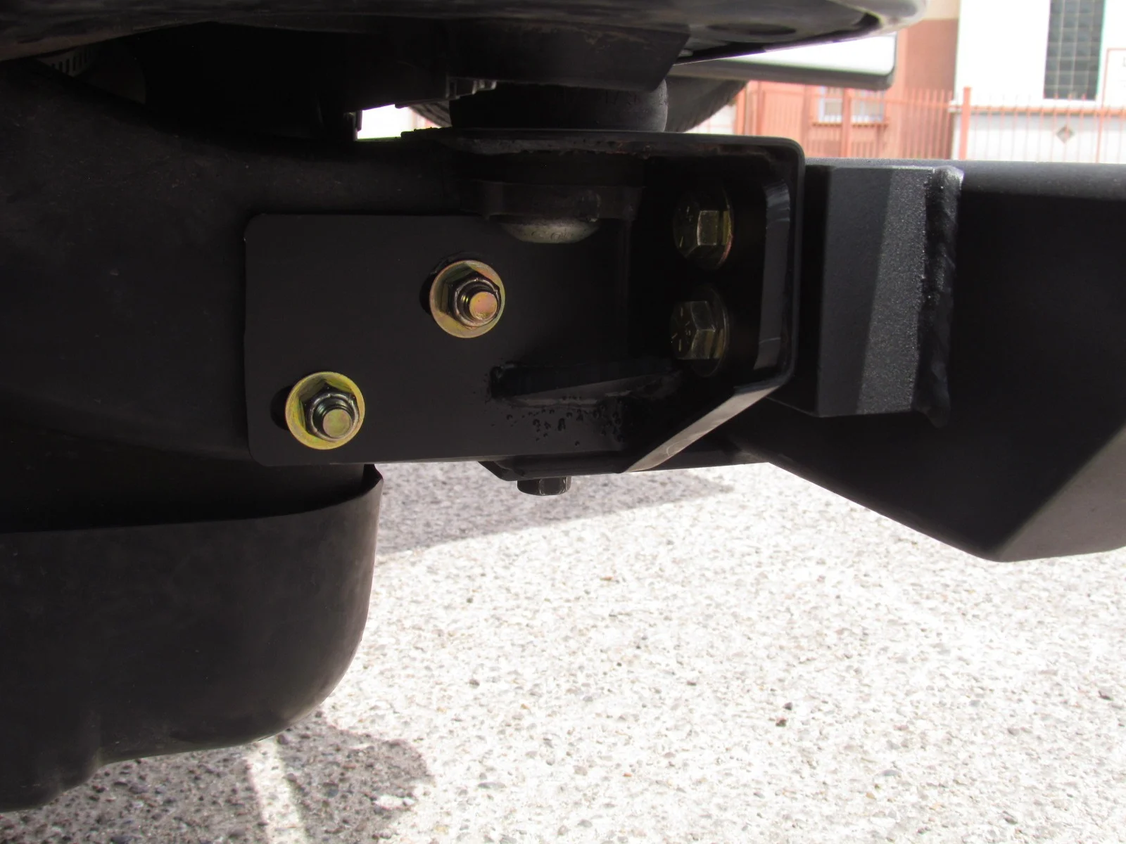

I went ahead and ordered some frame Tie-ins for the new Warn which is now prepped for self-etching primer.

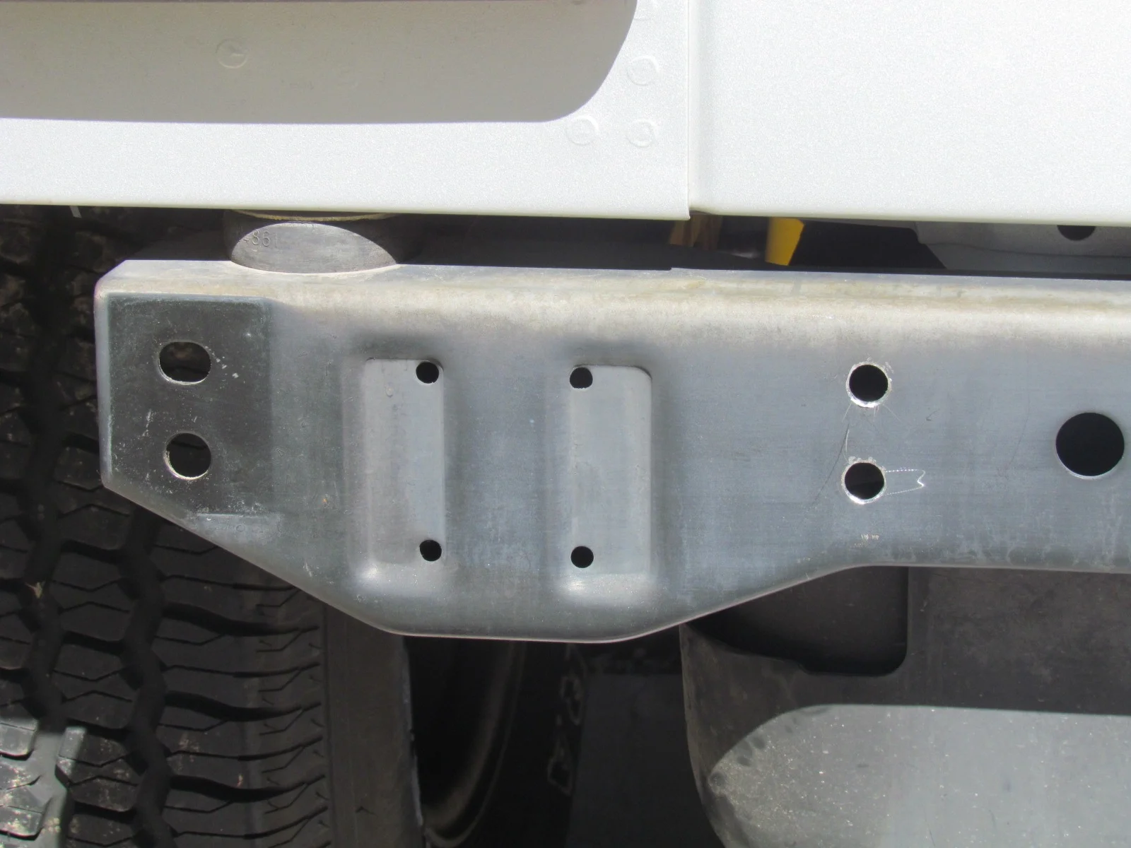

Looks like I need to drill 4 more holes in my crossmember to mount it correctly. Do you need to remove the crossmember to get the bolt behind it to screw into the bumper?
When I installed my Dirtworx rear bumper, I had to drill the same 4 holes. Just removing the rear nuts on the gas tank skid plate studs let the rear of the gas tank drop and provide sufficient room for me to get the bolts through to the bumper. That could be the case also with the Warn, hopefully. I did not lower the gas tank all the way.
I could be wrong, but I think the frame tie-ins use at least one of the same holes in the frame that your recovery hooks use...

As for the frame tie ins, I ordered the poison spider ones. They appear to avoid causing conflict with the recovery tow hooks. Everyone raves about them, so I think I’ll be avidly pleased!
Not all frame tie-ins block the hole or space that would be used for a tow hook mounted on the side of the frame. My previous TJ had both a frame tie-in and a frame-side mounted tow hook. My present TJ has a frame tie-in but no frame side tow hook though there is space for one. My Dirt Worx rear bumper has shackle tabs so no tow hook is required. I was actually kinda surprised just now when I went to go look that my present TJ doesn't have side tow hooks, I though it did... memory is the second thing to go when you get old. :D

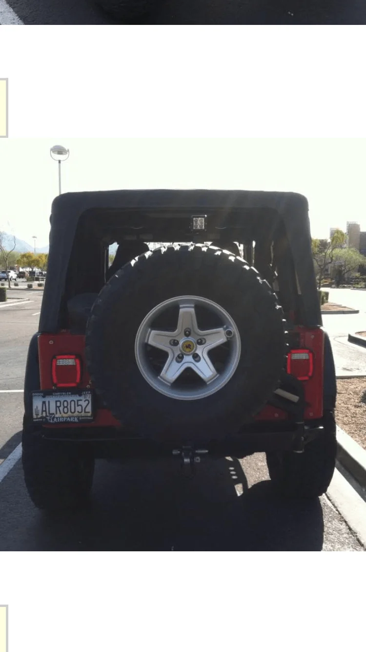

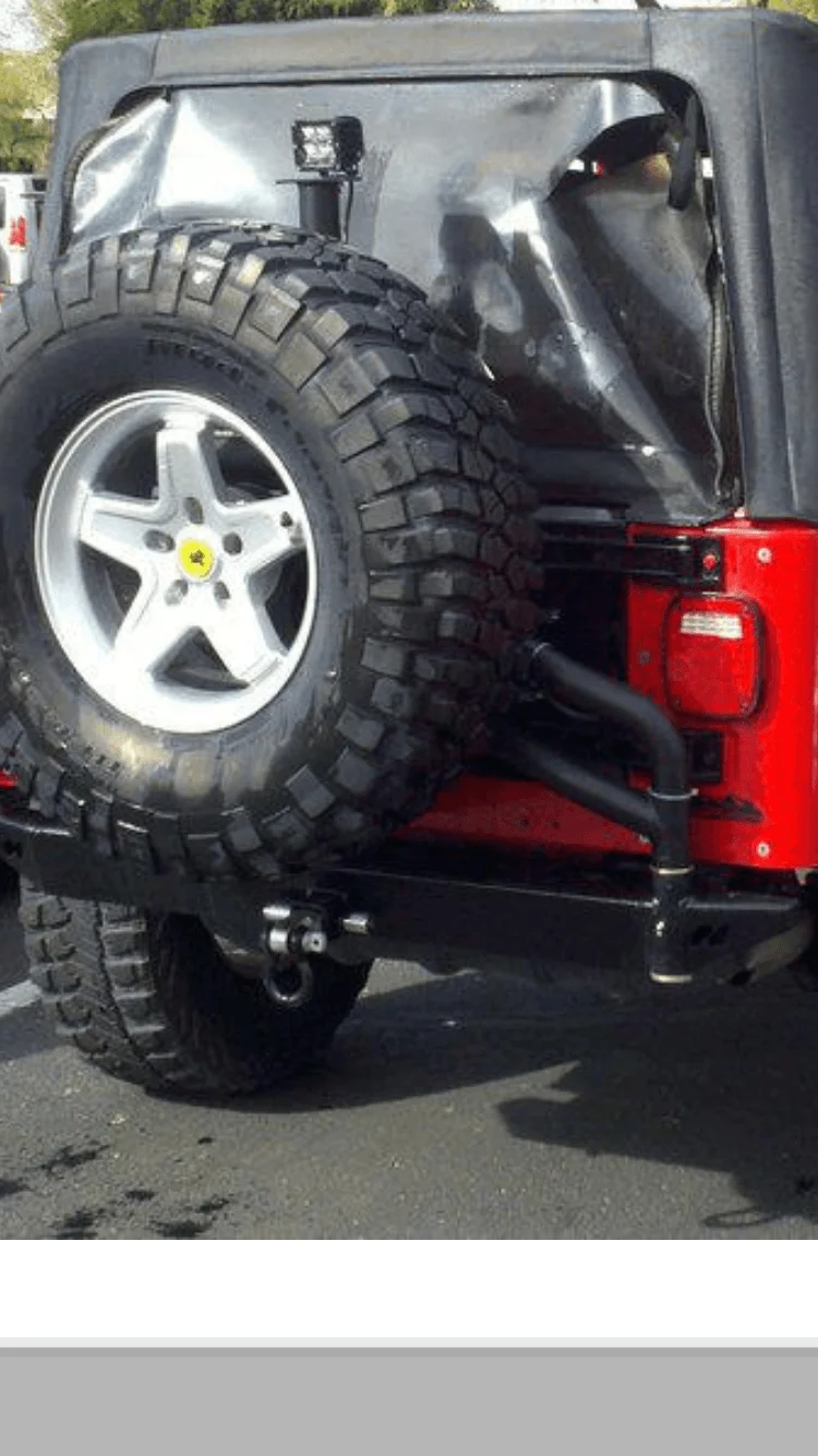

Here is the warn rock crawler rear fabbed with the AEV tire carrier. Looks awesome. Not sure how difficult that is to do tho. I thought it was the mopar rear but it is the warn. Very neat
Reactions: JMT

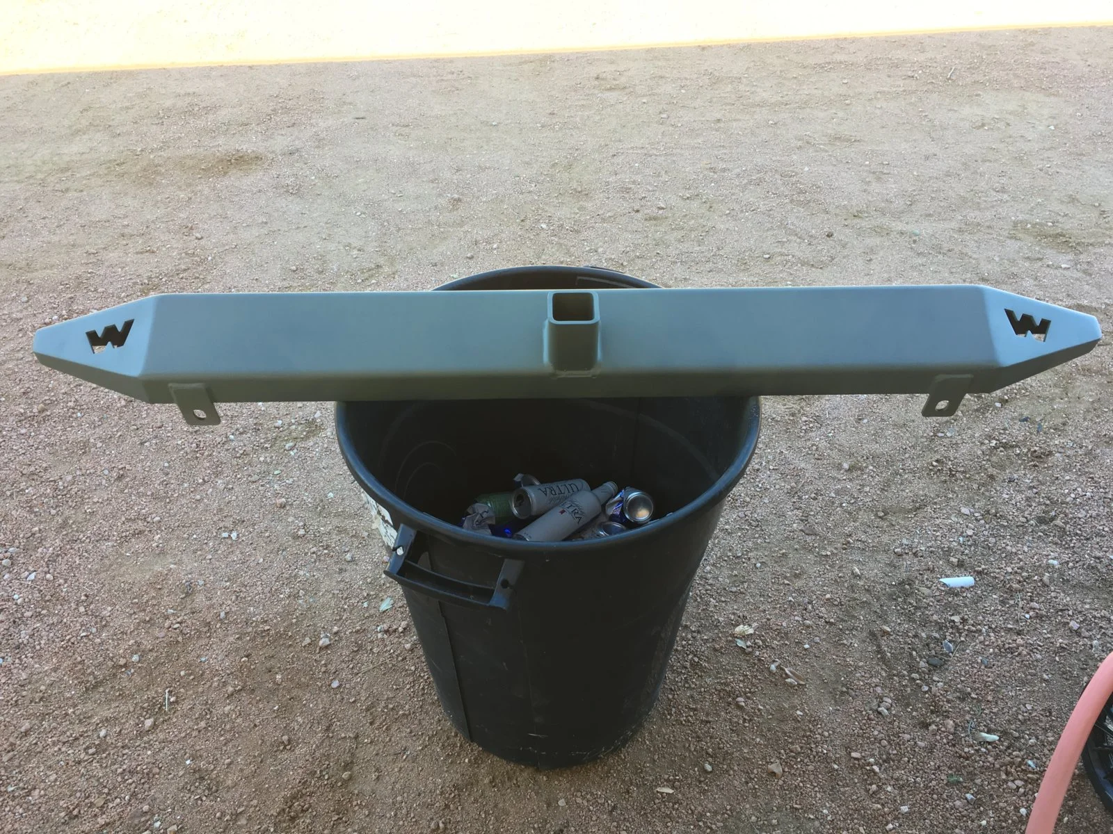

Alright, here’s the Warn Rock Crawler bumper transition today. Just got it yesterday! This thing is awesome. I’m so blessed to get this!
Original in very good condition
Prepped by sanding using 220 and 120 and angle grinder with 80 for cleaning up dings and welds
Self etching primer
Semi-gloss finish that I love
Tell me that doesn’t look BRAND NEW! I’m not a painter or the son of a painter. Yes, those are beer cans. no, I did not drink them all today. That was today and yesterday.

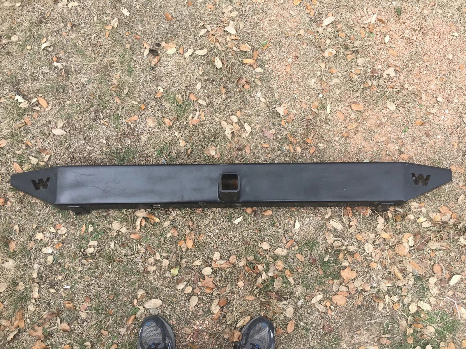

Self etching primer

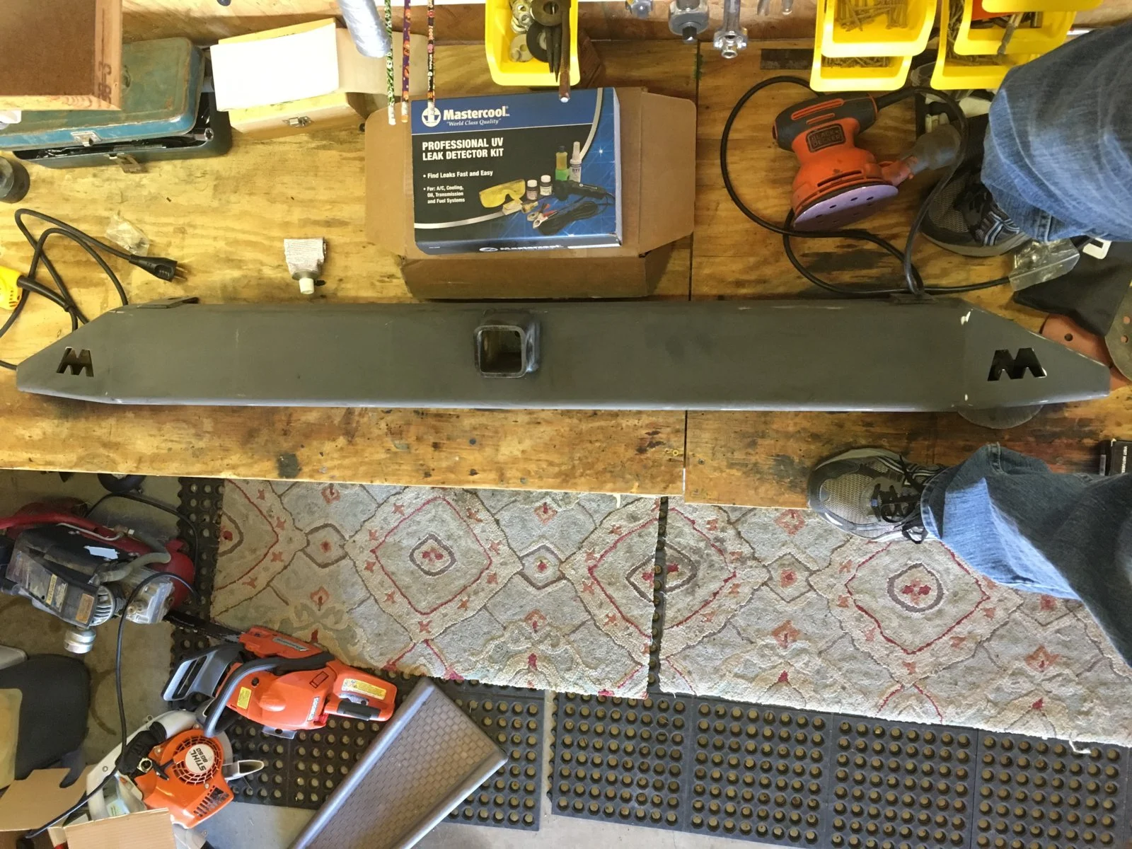

Self etching primer
