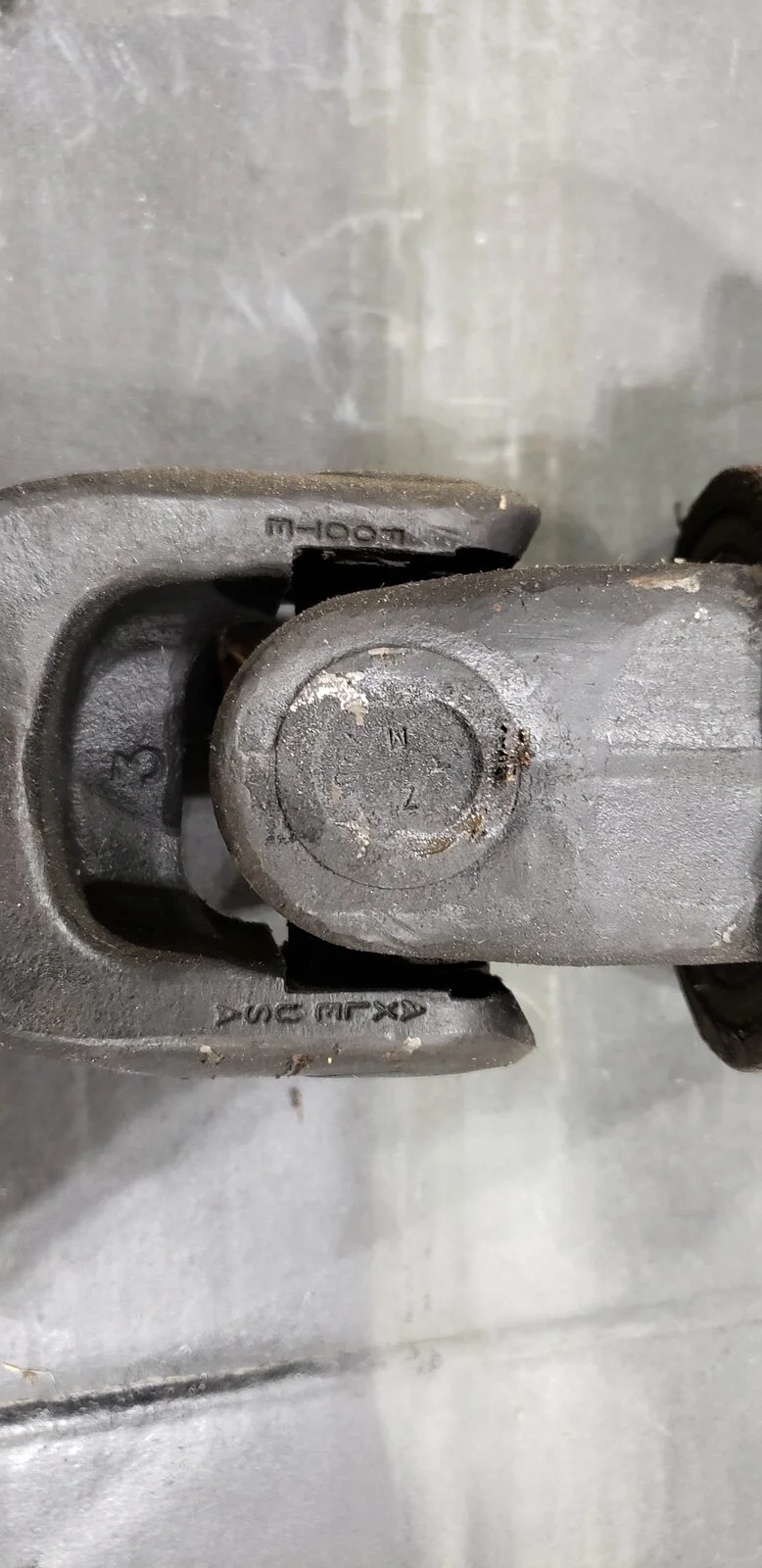

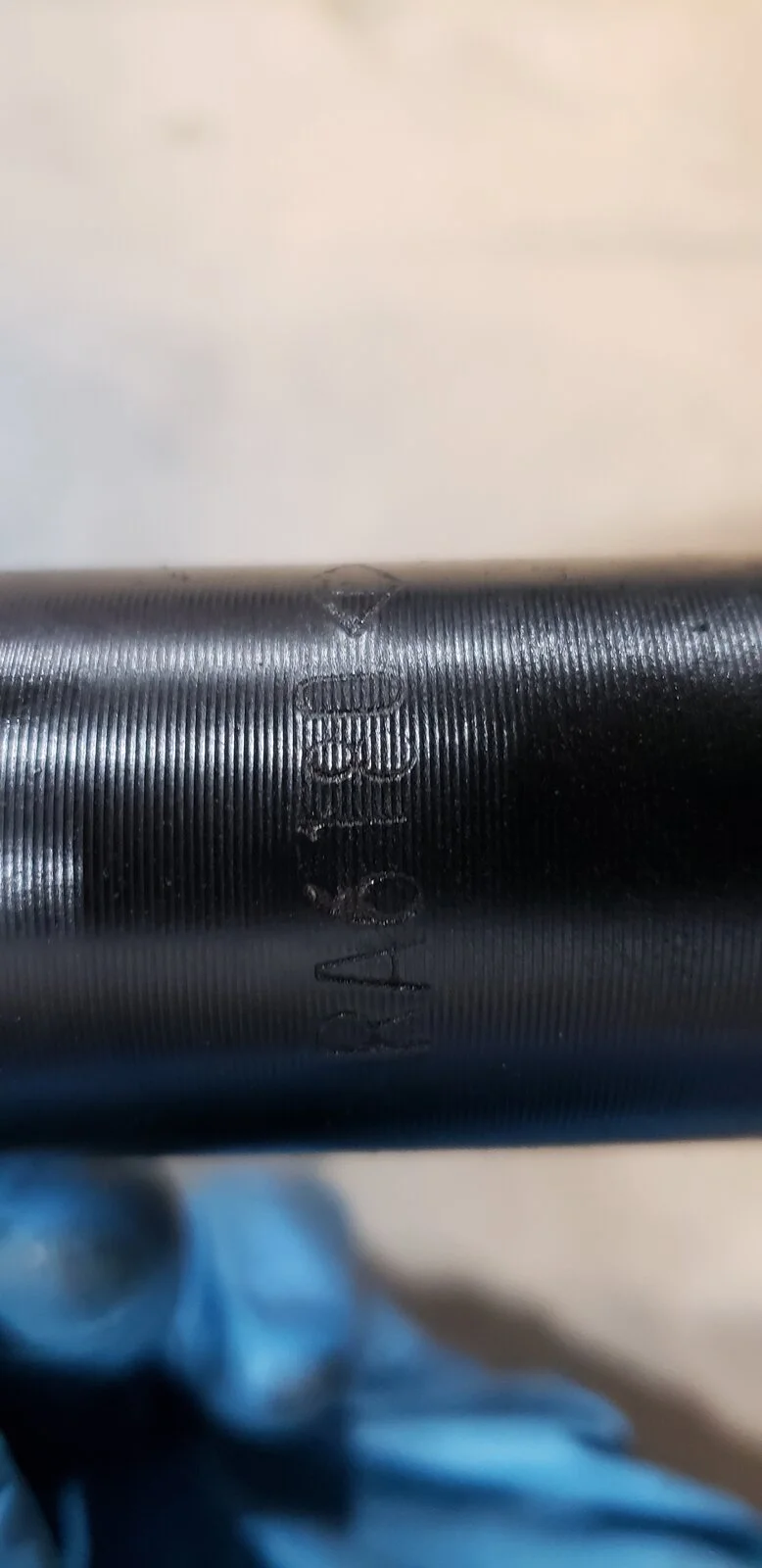

I picked up a mystery Rubicon 44 at a yard sale for $300. Upon pulling it apart, these were inside and I'm not familiar with them. Anyone know who made these?
They’ve got a website, may be worth a call or email to them with the part #
May have to do that next week. I did a quick look through the site, but couldn't find anything specific. :unsure:

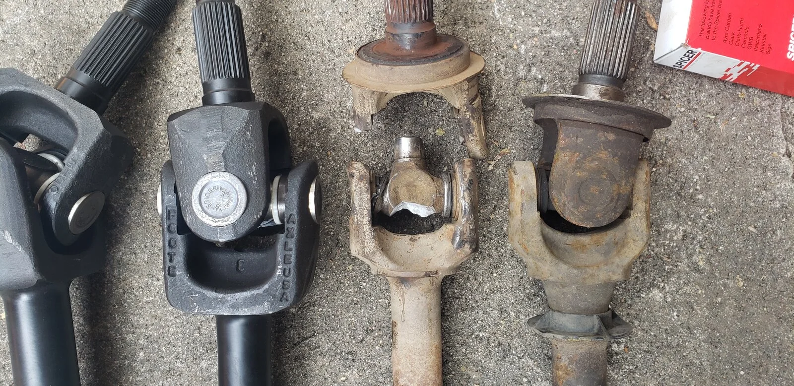

Superior? Are the u joints stock size 763 or the big 1350? Foote was the foundry for Superior and for RGA.
1350 RGA, broken cromoly Superior, stock Rubicon
Could be wrong, but I think I remember reading that foote was the manufacturer is the yokes used by RGA for their USA series axles with the big joint. Are those standard size for a TJ or so they look bigger?
Reactions: Irun
I'm measuring them now!
Reactions: jjvw
Foote is the Los Angeles forge that makes the lifetime axle shafts for RGA and used to make the Superior Axle Evolution shafts.
Reactions: JMT
Well there it is....SPR 1411, which is a 5-7166X 1350 u joint.
