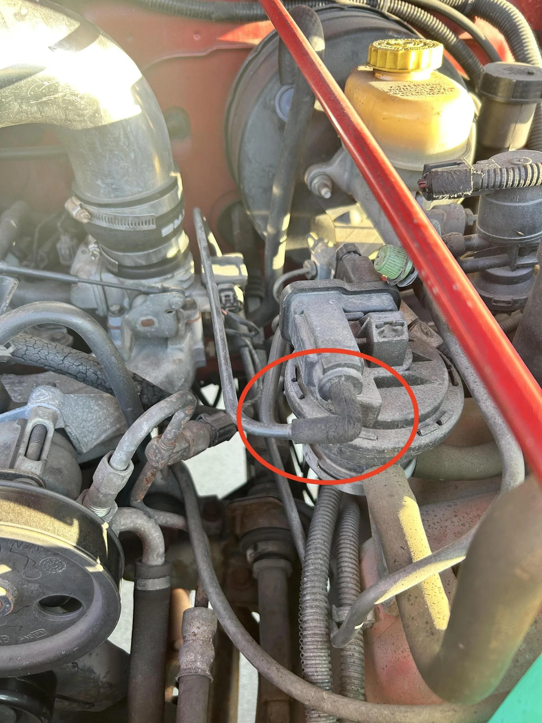

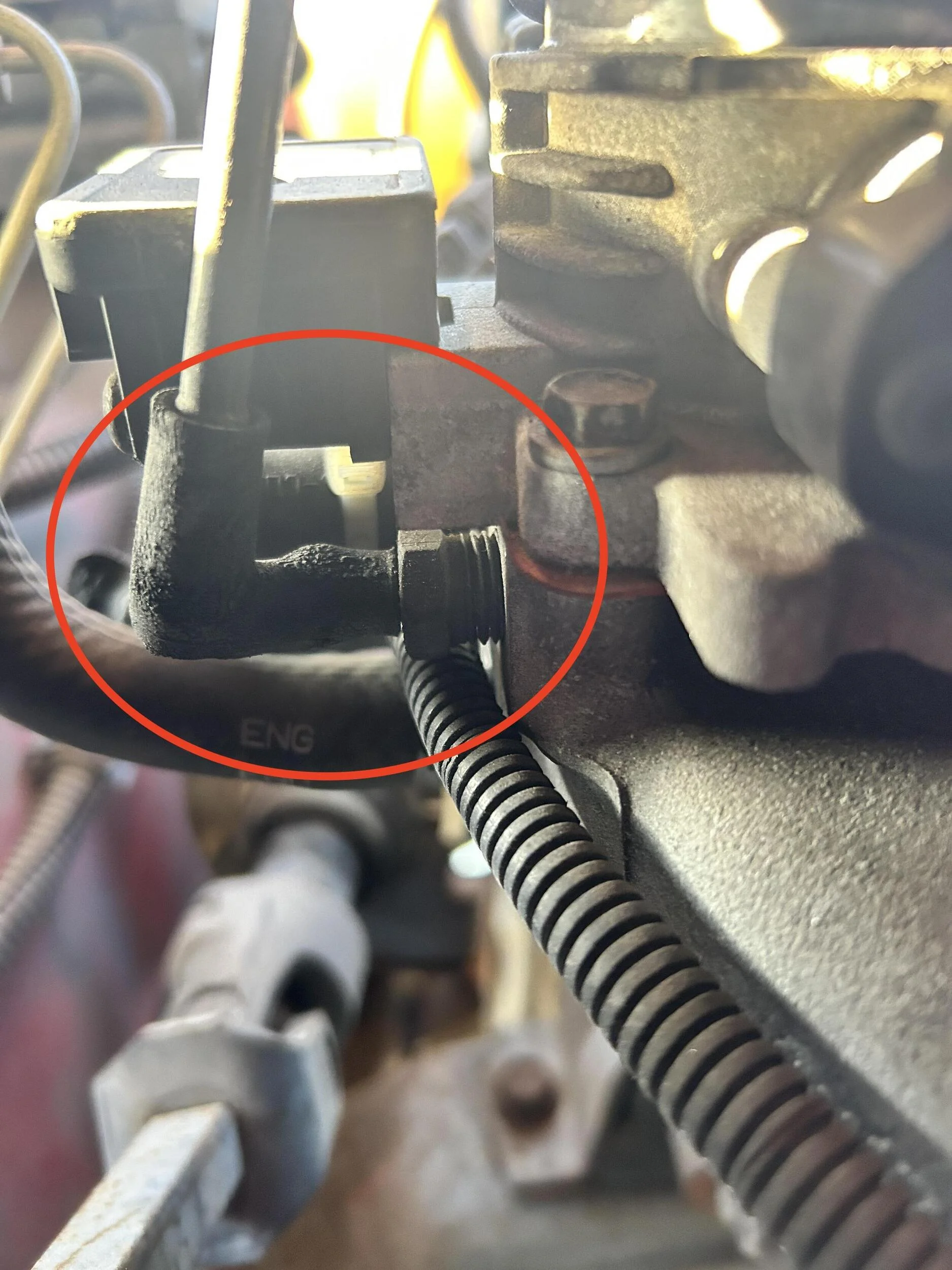

Just got my 99 Jeep smogged and the guy noted that these parts are falling and cause a vacuum leak when wiggled so I want to replace them but I'm not sure what they are called or where to start looking for them.
Here's a shot of them from the top and then from the back where the pipe connects
Top View
Back/Rear View
soft vacuum elbow
you can generally find them at any auto parts store

Take the fitting with you since your shopping for something that will fit since direct replacements are not readily available.
