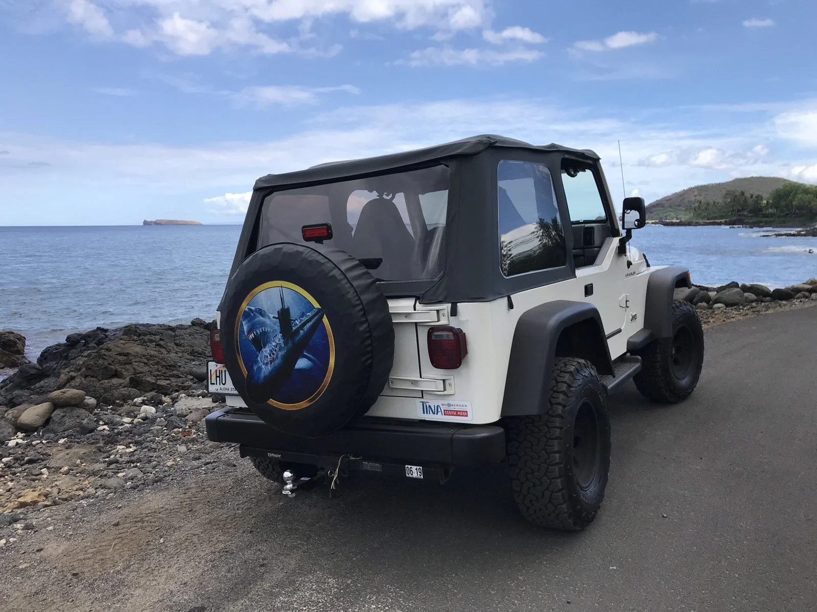

I did my cooling system, all of it except the heater core which I will do when I install A/C. I also had to do my front axle u joints. I did my front wheel bearings, all my brakes, interior carpet (ok, not really vital but it looks nice.)
It’s nice that it’s all pretty simple stuff and this forum provides the fast track to answers when you need them.
I also put a top on it and a new sound system.
