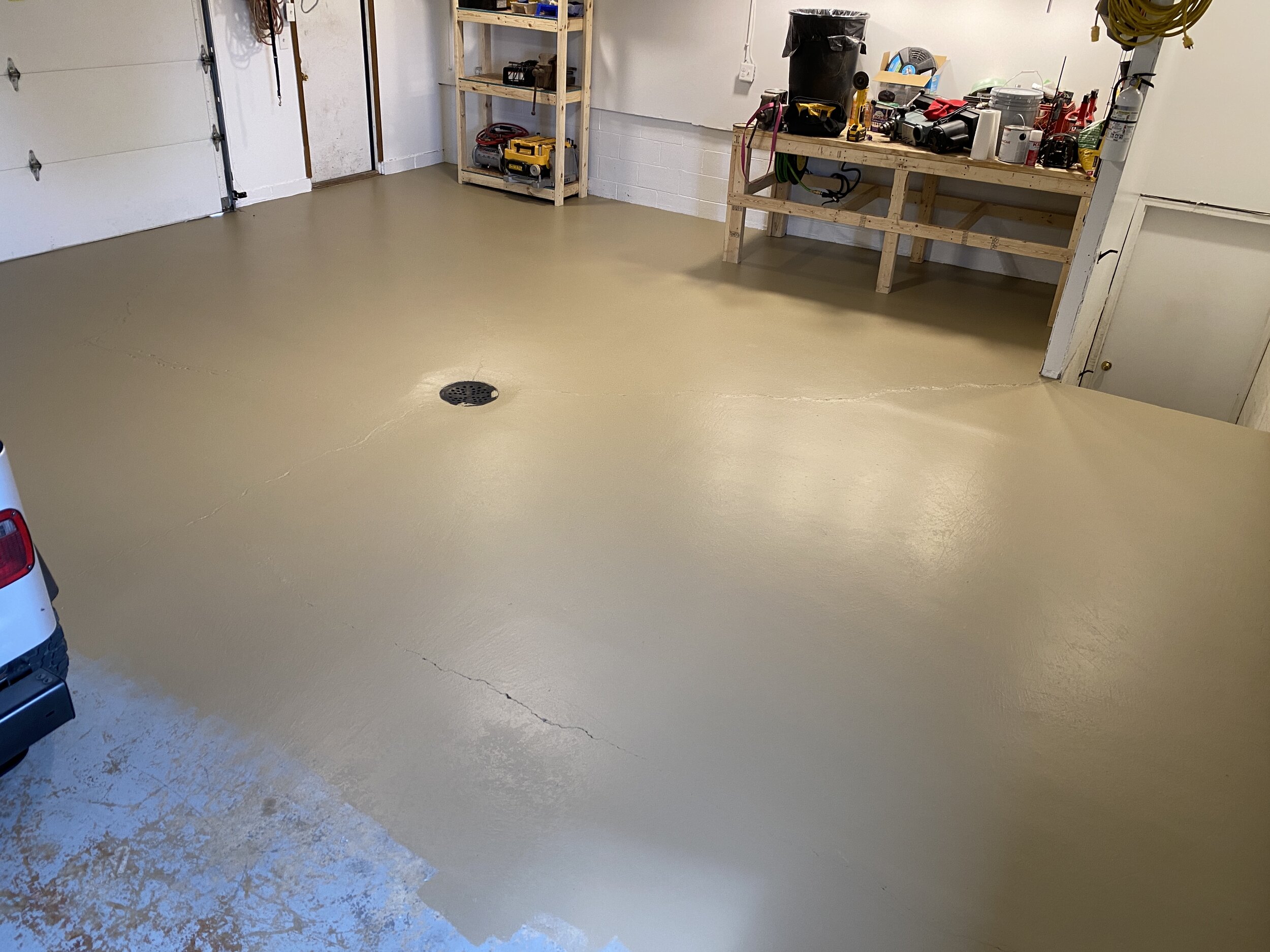

Sunday afternoon I degreased the floor and used a surface cleaner attachment for my pressure washer. Worked out really nice, got alot more up off the floor than I expected to be there as well as tons of old loose floor paint. Dehumidifiers been running since Sunday night so I can get the floor paint rolled on soon.

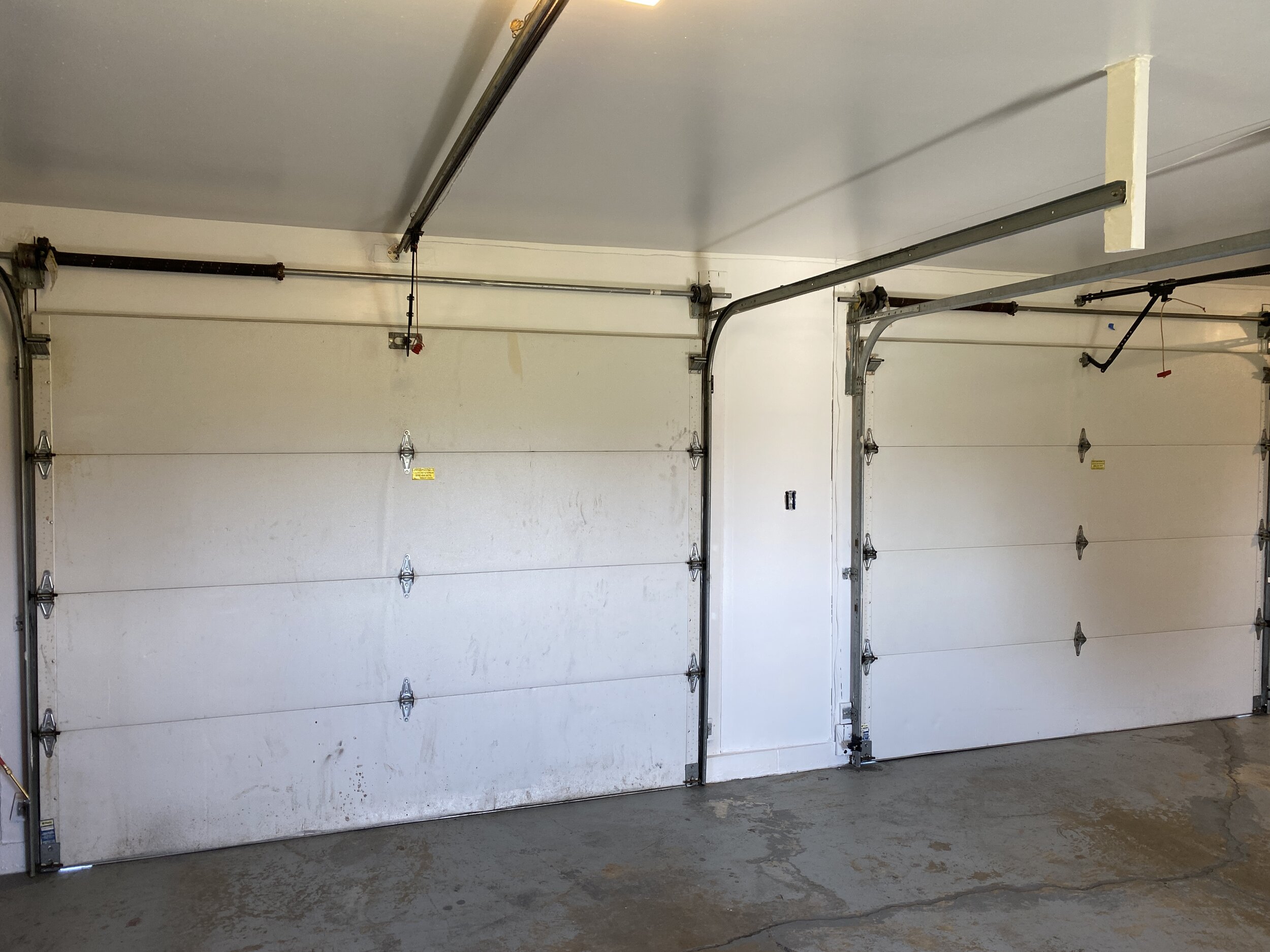

After work today I degreased and hand washed the interior side of the garage doors. left side is not cleaned and right side is clean in the photo below. Looks much much better in person.

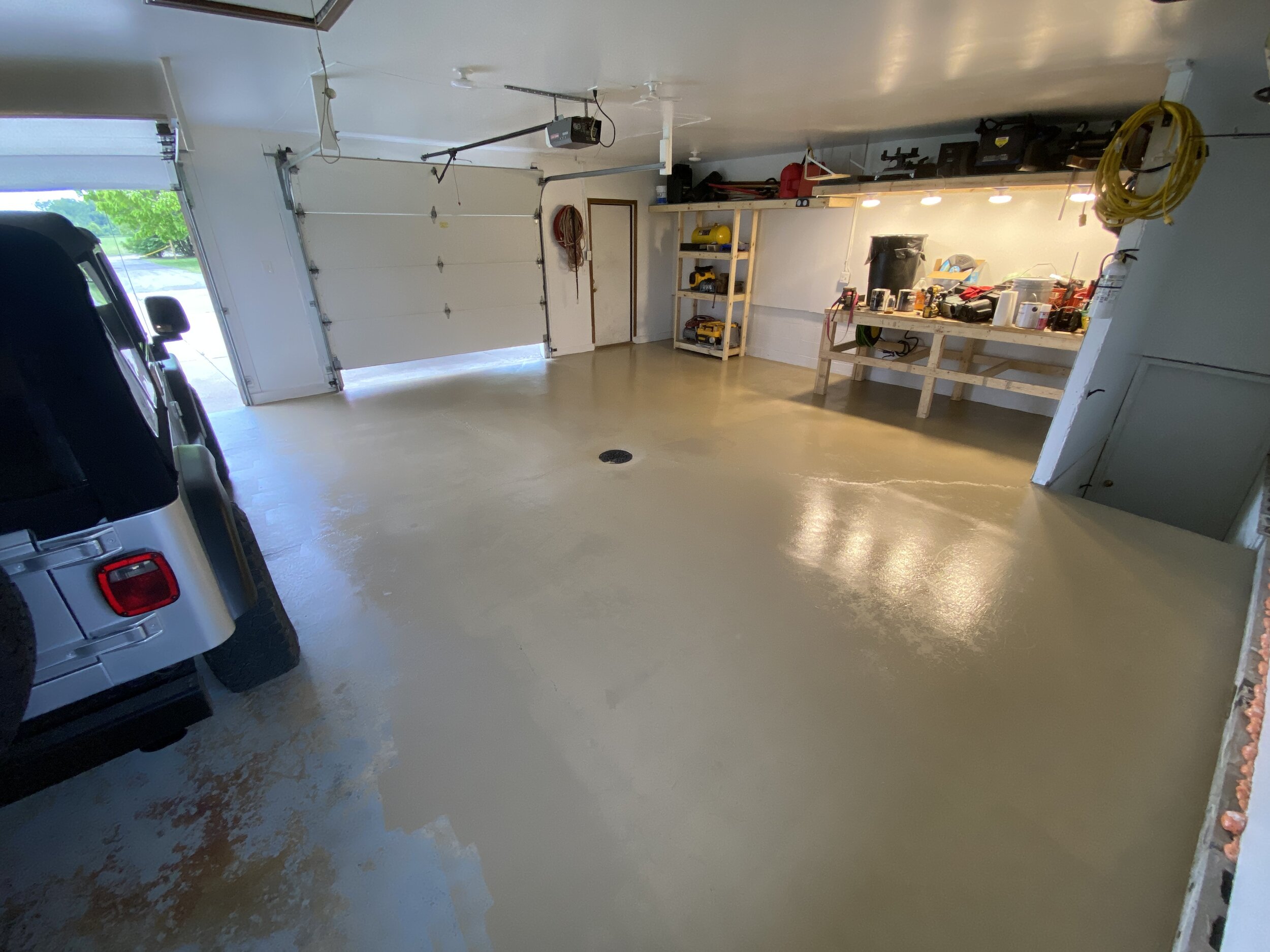

Cut in and rolled a 1st coat after work. Not my first choice for a garage color... but this particular color is the cheapest compared to the other colors for some reason but it looks better than it was before. Would have liked to do it all at once but dont want to disassemble and move the toolboxes to the basement. Next week I can do the other side.
Applied a second coat to the floor yesterday.

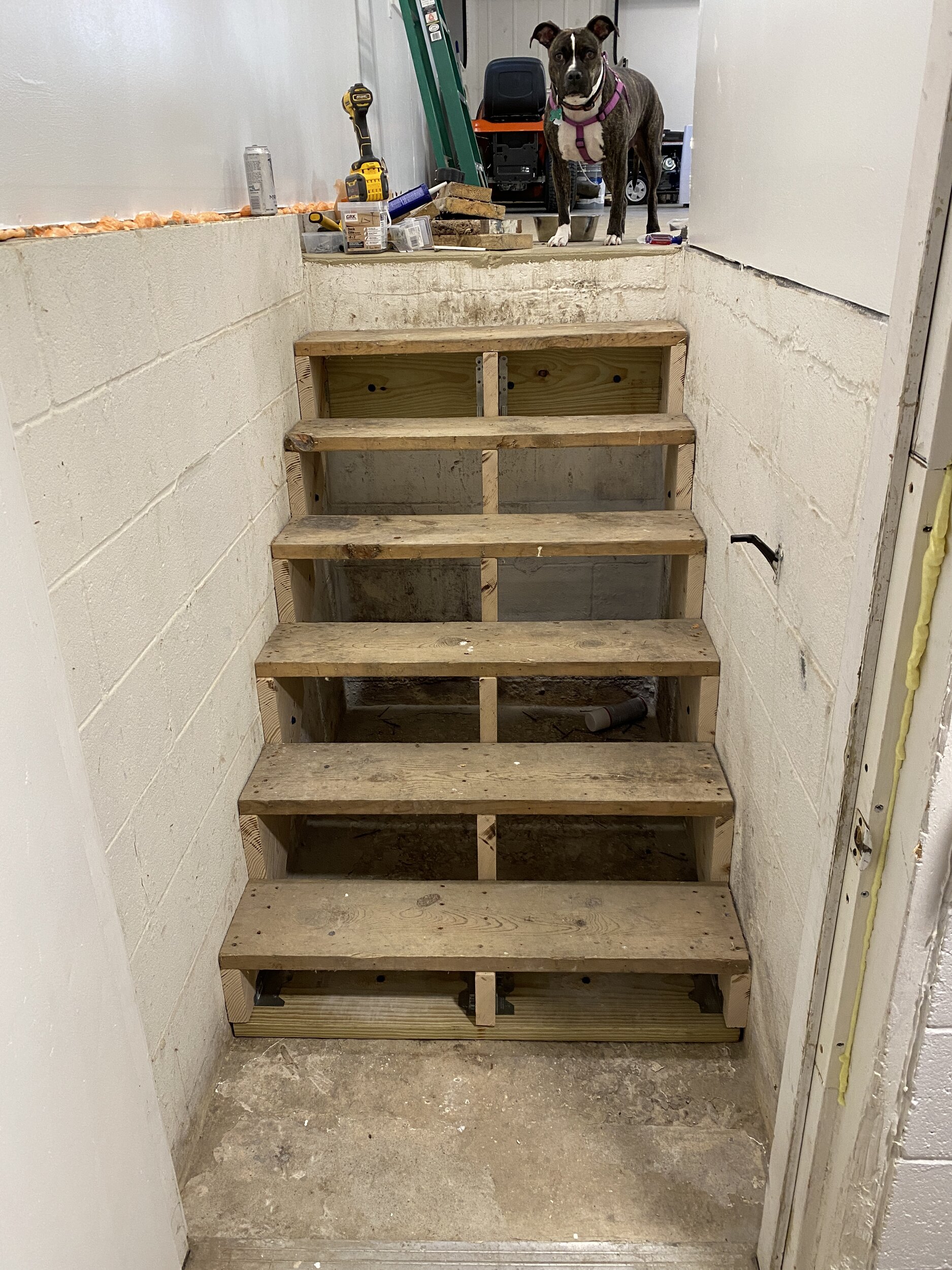

While waiting for floor paint to cure being that im not really able to do much else, I decided to disassemble the steps leading to the basement tonight to clean up this area and resolve the goofy stair stringers. Whomever built them built them from scrap, the top step was about 1.5" longer than the others. I need do some calculations now to bump the stringer back about 1.5" & up a hair. The steps were originally were boxed in but I kept snagging my boot on the frayed plywood risers which were nailed to the face of the treads as the plywood wasn't cut flush.
I actually really like that color. Looks good! What paint are you using?
Coating my garage floor is on my list of things to do someday.
It is Drylok Bamboo Beige latex concrete floor paint. I am not sure of the durability though, Its cheap @ about $40/gallon. Seems to be holding up well in the basement so far though I have read it tends to turn into a maintenance thing with tire pickup when used in a garage.

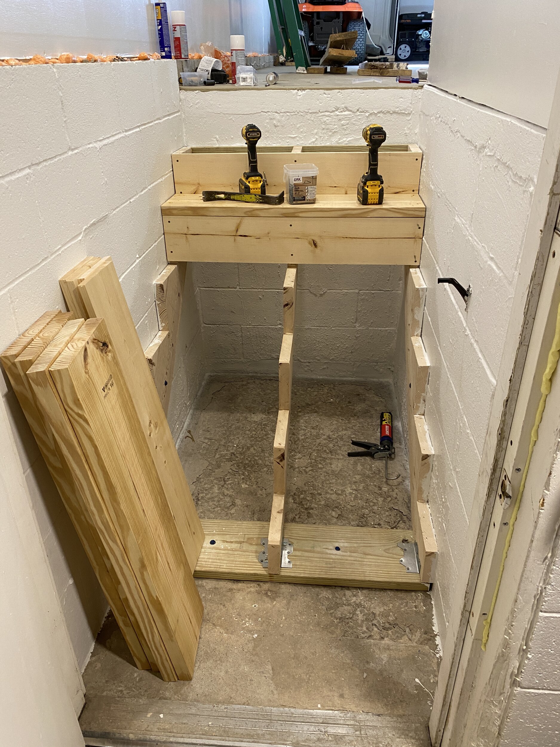

Removed the old stringers tonight and cut new ones.
Briefly attempted trying to figure a way to reuse the existing stringers but after measuring them I found the runs and rises all varied... they all should be the same. one of the rises was 1.5" higher than the rest of them. It's really important to have them all consistent.

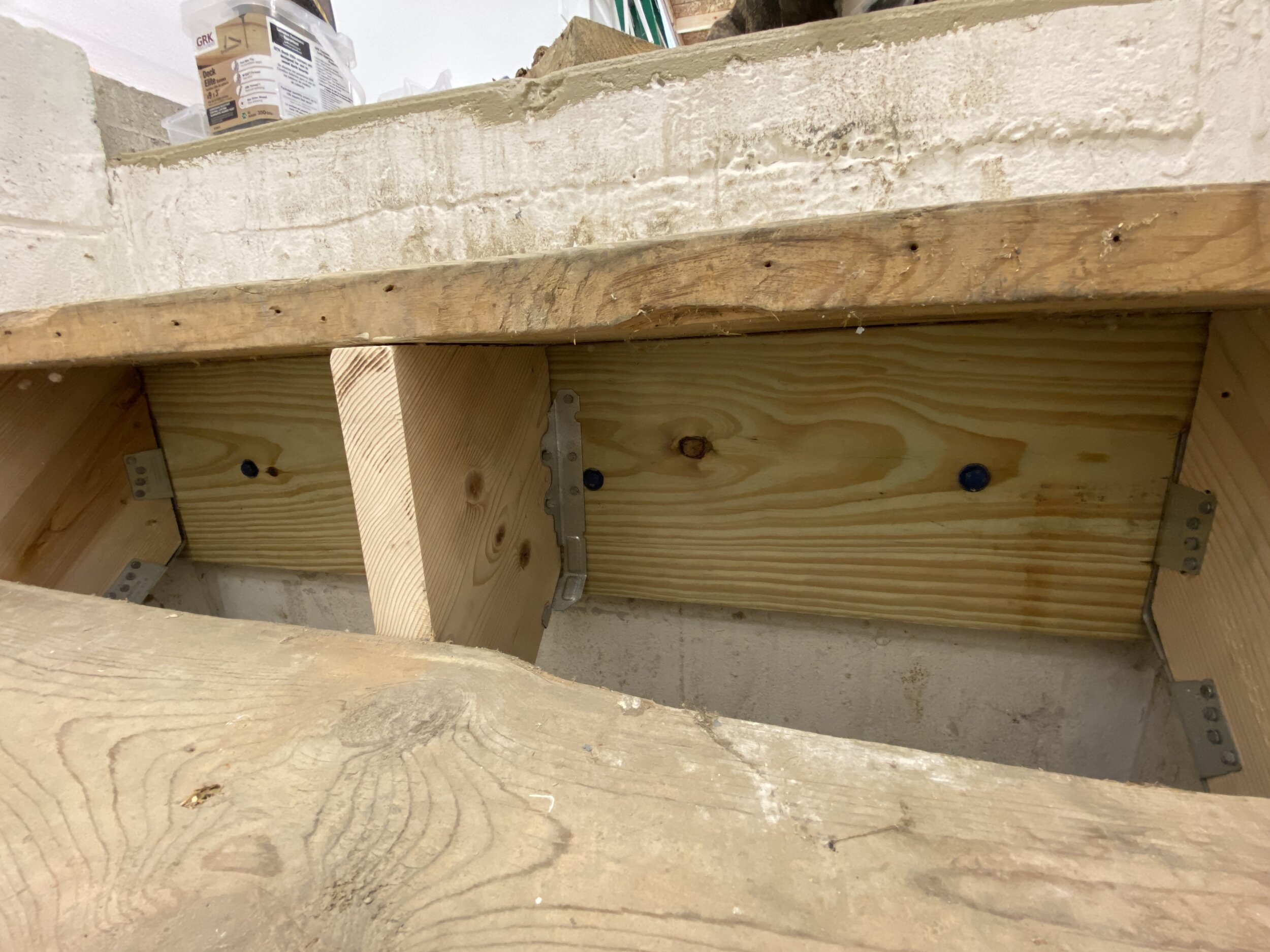

Admittedly I really have no idea how to fasten the stringers to the wall plate but I bought some various Simpson plates/hangers and I think I did pretty good for what it is.
steps are now functional for now. Probably gonna prime and paint the walls next then I'll finish up the job by cutting and install stair risers to box in the steps.
New risers, wall and floor plate.
Revised stringer Simpson bracket supports.
Temporary accomplishment.

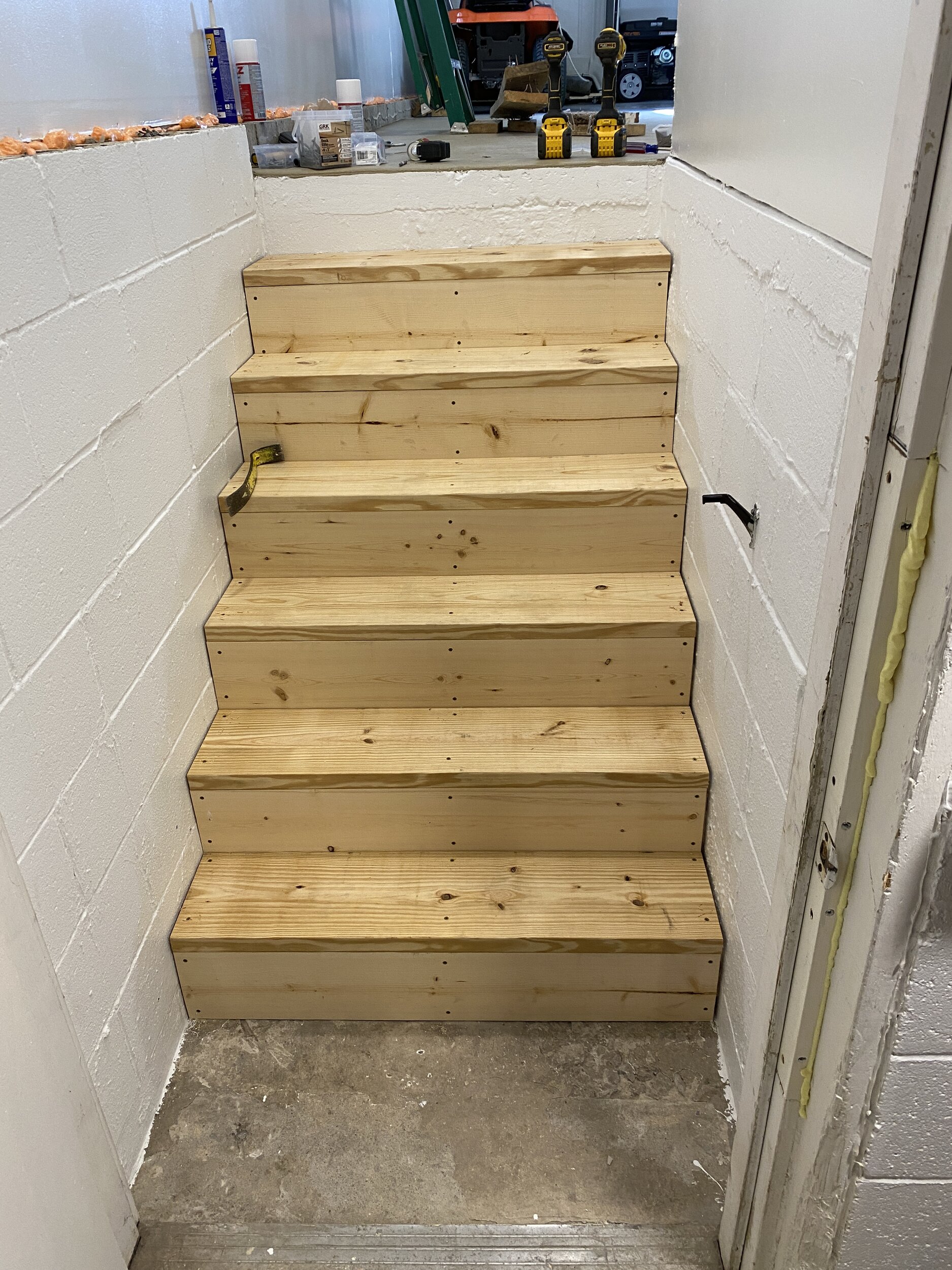

Primed the walls and cut in around the stringers with the same semi gloss white ive been using everywhere else this morning. Picked up some lumber this afternoon and cut out new treads and risers. Everything is glued with Poly adhesive and screwed. Jobs about 95% done, just got to paint out the block with semigloss... then I need to find something else to work on.
