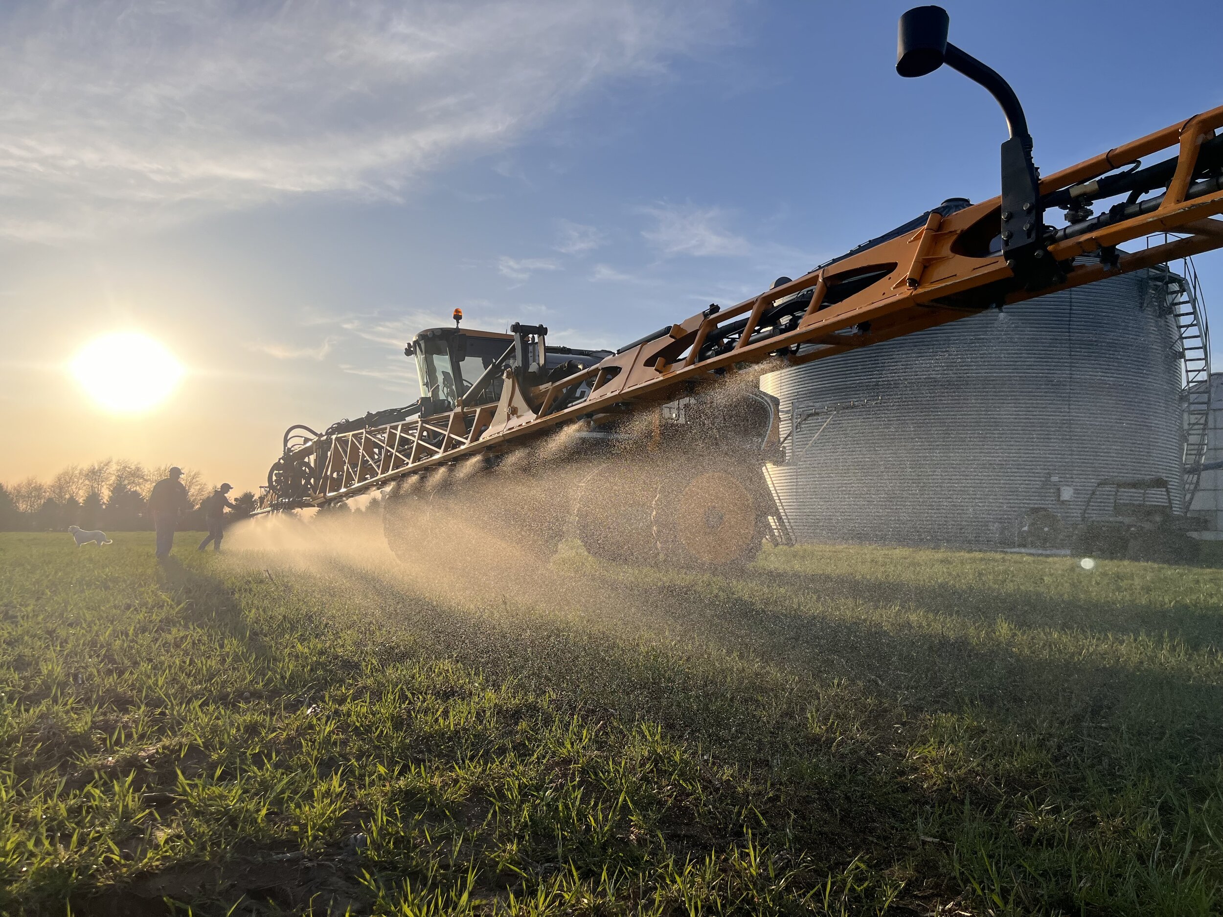

We spray with a Hagie. We put a PWM nozzle system on it which shuts off nozzle by nozzle (15” spacing) when spraying angles or coming up to the ends.
Also speeds up the rate the outside boom and slows down the inside when you spray curves. It’s a great addition.
Here we’re function testing with water:

Did they have those in the late 70's early 80's? All I ever saw or fooled with were the Big A's.

I think Hagie has been around for quite awhile.
Not sure when the single tank configuration came around, late 90’s maybe.
I got tired of the bullshit (it’s a timeliness issue) aerial applicators for corn fungicide was one of the main reasons I bought it.

You’re a pilot did you consider a sprayer plane?
How fast can that thing go? I ask because over the last month I've gotten behind two sprayers (IH maybe, they were both red) running down the road at 45-50 mph. :oops: I was shocked at how fast they could move. I'm used to 30ish, but damn those things blew my doors off.
Top road speed is around 33. Spray around 11-12 mph. Trying not to kick up dust. co-op goes faster....but that's why we bought our own. That and they never show up on a calm day!
