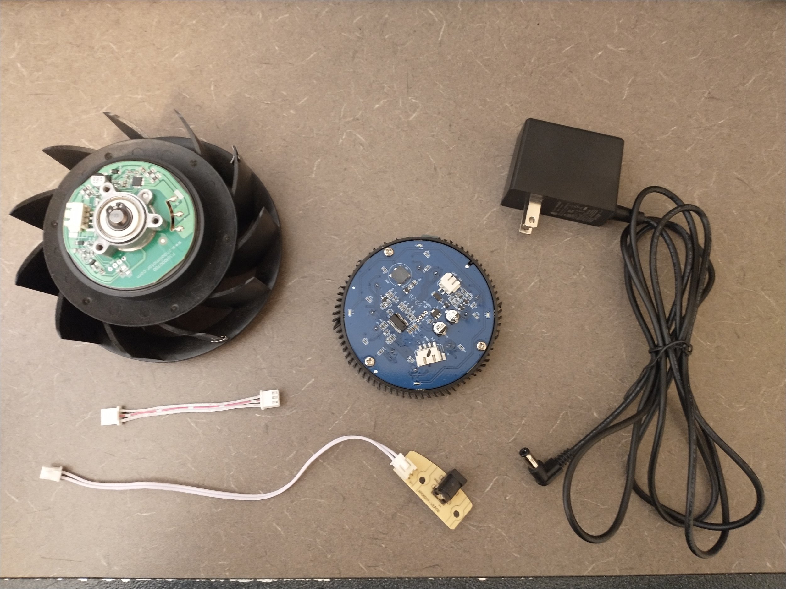

The bits I'm starting with, the aforementioned destruction/deconstruction....
Suffice it to say this will never function as an air purifier again, no matter what happens from this point forward. Currently working the booth design in CAD, more to follow...unless I get electrocuted or something catches fire in the interim... 🤪

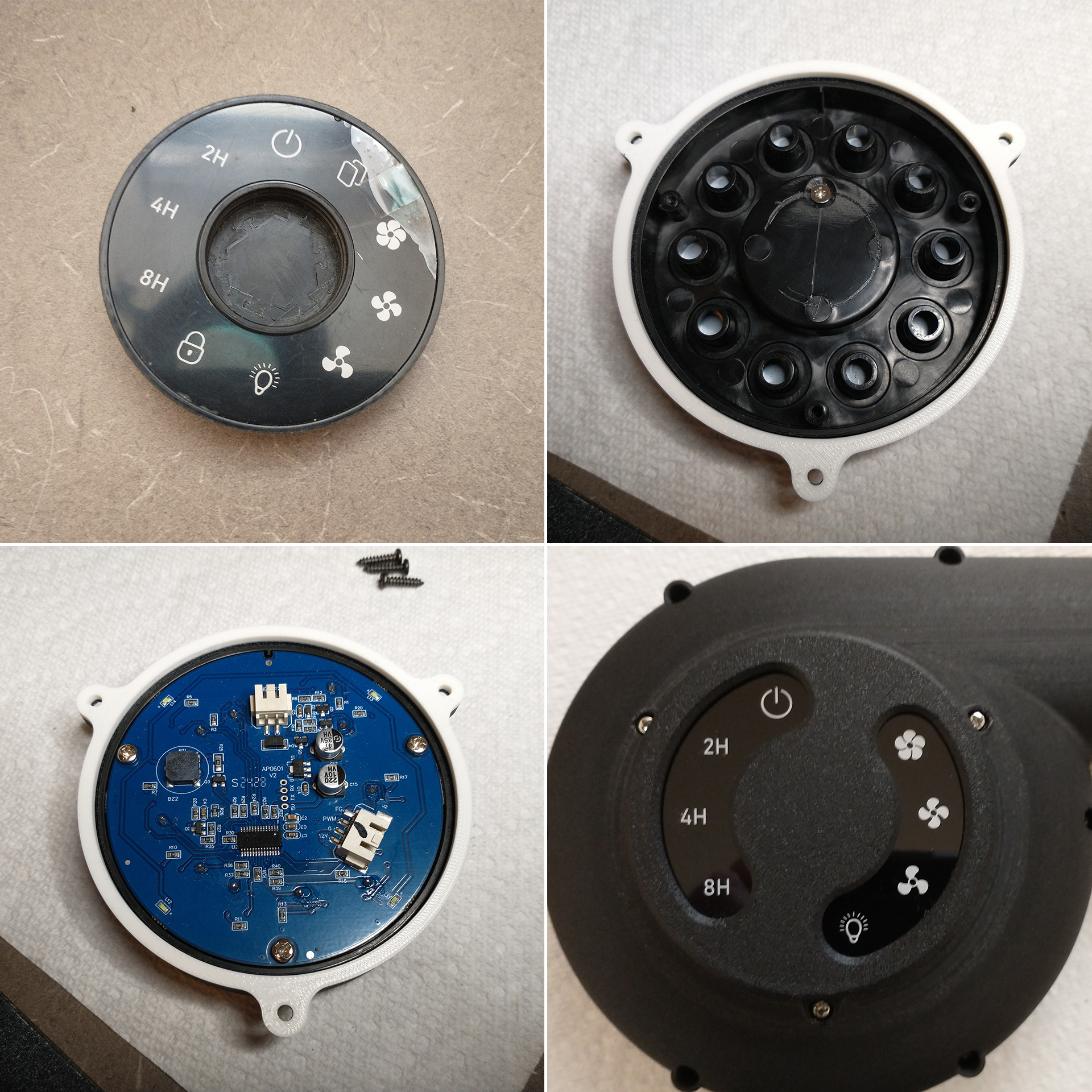

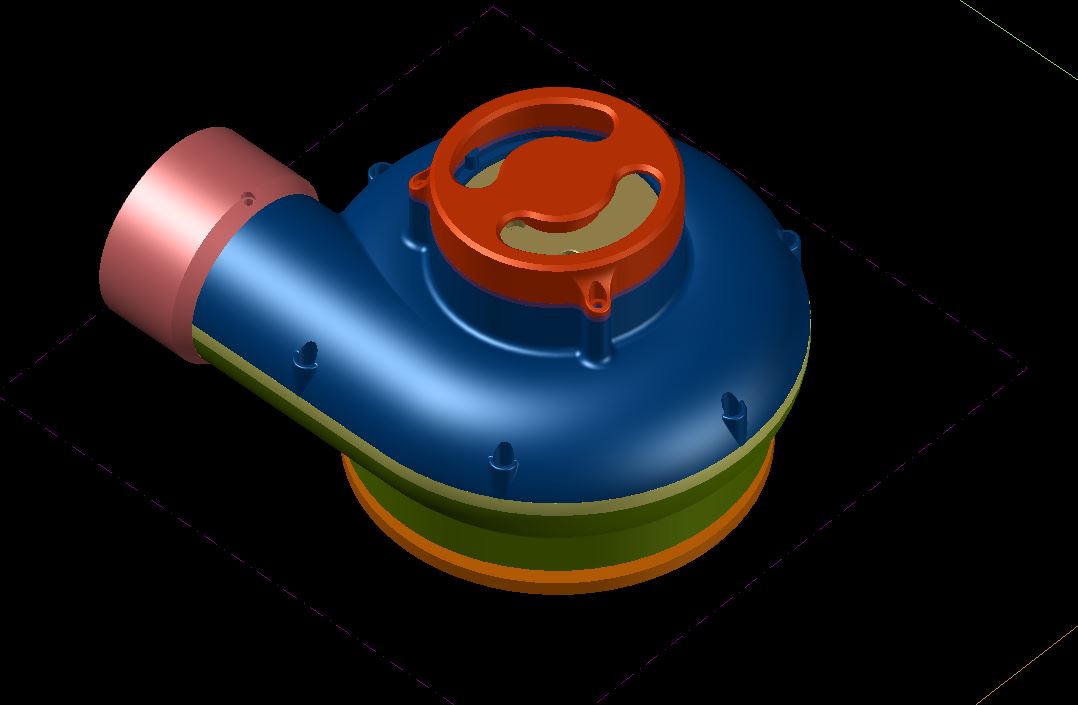

Progress. Magic'd up a suitable housing design in CAD, sliced it and printed in ABS-GF.

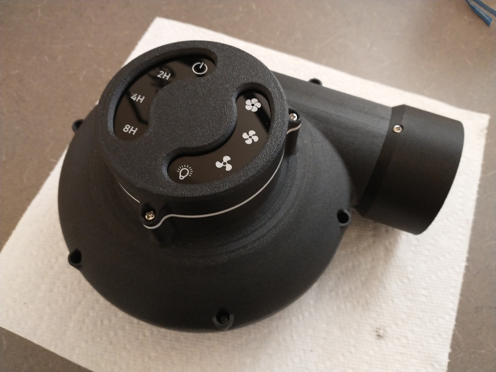

Chucked up a sanding drum in the drill press and cleaned off the fin remnants and unified the size. Controls mounted in new faceplate, the white part of the print was supposed to glow with backlighting on the control board, but it seems the BL white ABS has a bit higher solids content so it barely illuminates. Oh well, it was just a last minute trick thing I threw in the design.

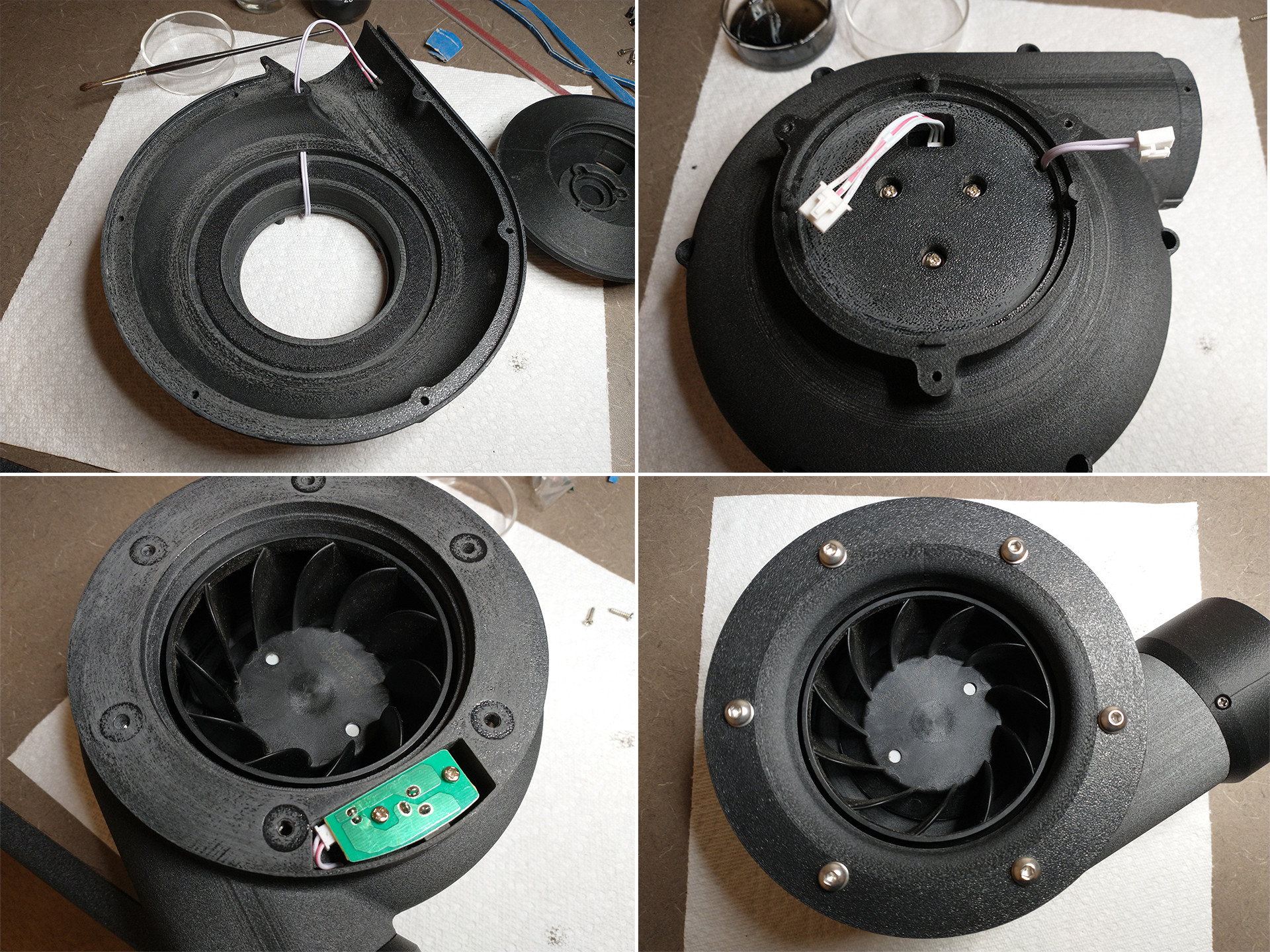

Proceeded to bond the housing parts using ABS glue and acetone, fishing the power wires before doing so. Once dry, set the fan motor, bonded in the captive nuts for the mounting collar, installed the power jack and fitted the collar to check clearances.
Not too bad for a few hours work. Appears to be fully functional and moves air.

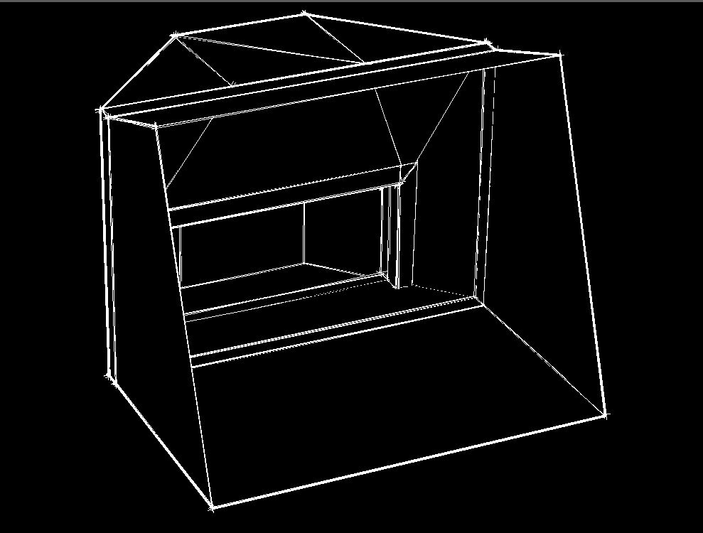

Next, finalized the basic booth design and dimensions. Currently working on developing this into 3D parts for laser cutting.
Chucked up a sanding drum in the drill press and cleaned off the fin remnants and unified the size. Controls mounted in new faceplate, the white part of the print was supposed to glow with backlighting on the control board, but it seem the BL white ABS has a bit higher solids content so it barely illuminates. Oh well, it as just a last minute trick thing I threw in the design.
You only made 1/2 of a turbo????? Just think how much air it could make with the other half.... 🤣 🤣 🤣
Funny you say that, I was going to write it up as something like "This thing blows! Dumbass makes plastic turbo for Jeep"... :ROFLMAO:
My volute design does involve a fair bit of guesstimation, if I'm honest. :geek:

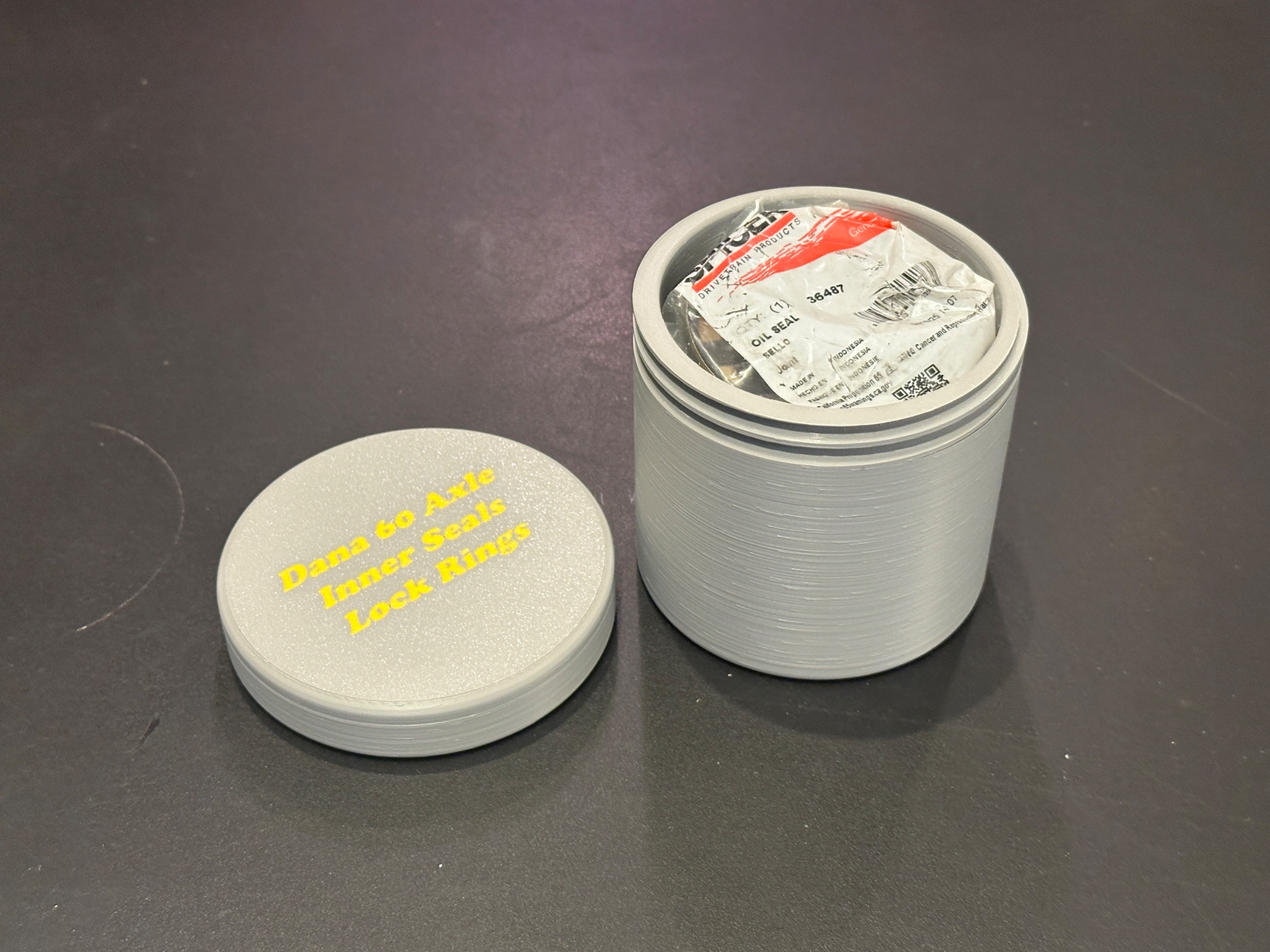

Meanwhile, in my shop I’m thrilled that I was able to design a jar to store axle seals…

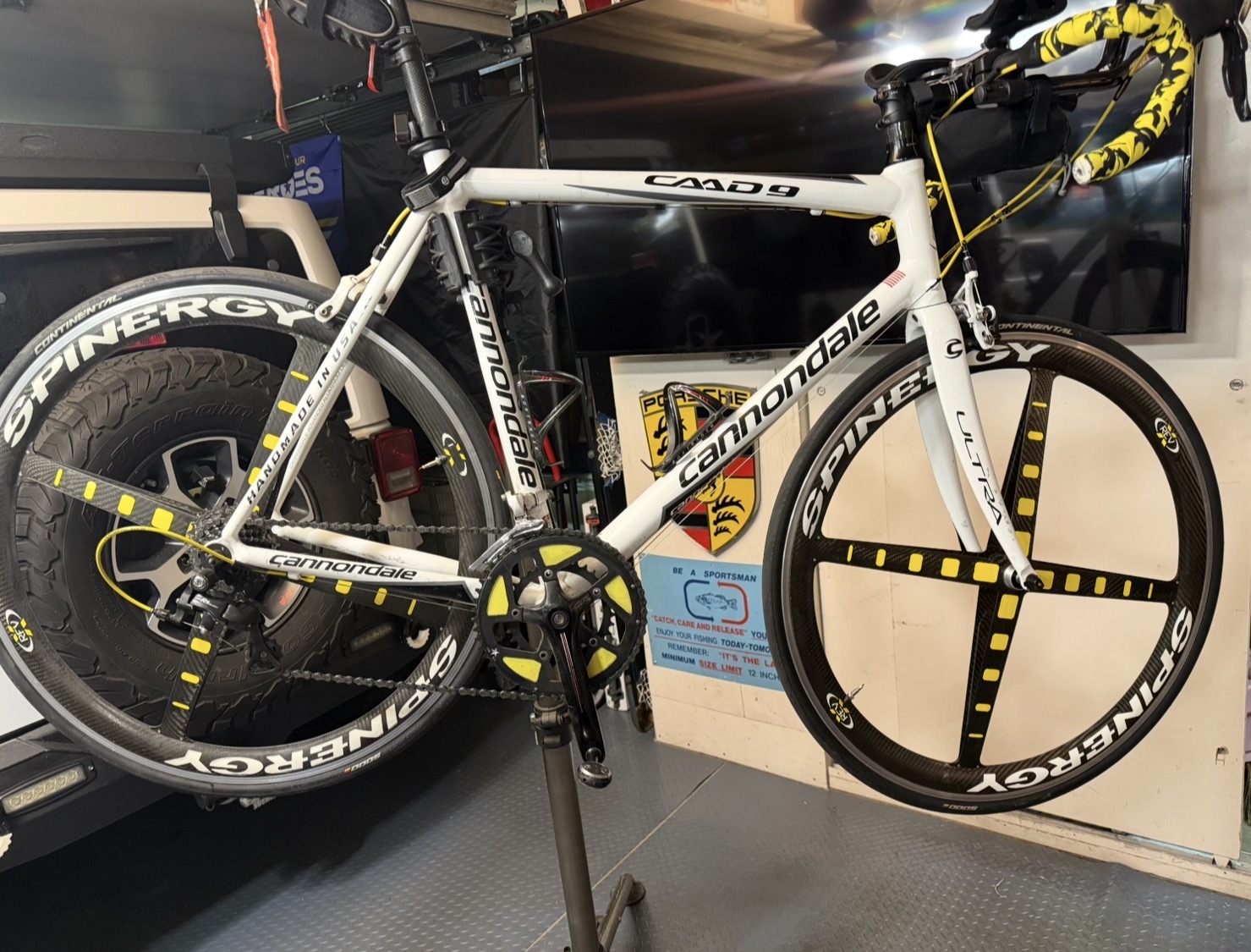

Worked on the road bike a bit last night. Tuned up the drivetrain, cleaned the cogs, & lubed the chain, etc.
Almost ready for another new set of tires…
Not too bad for being 15 years old!
CAD aluminum frame with some spinergy…I raced in college and a while after. love it.
