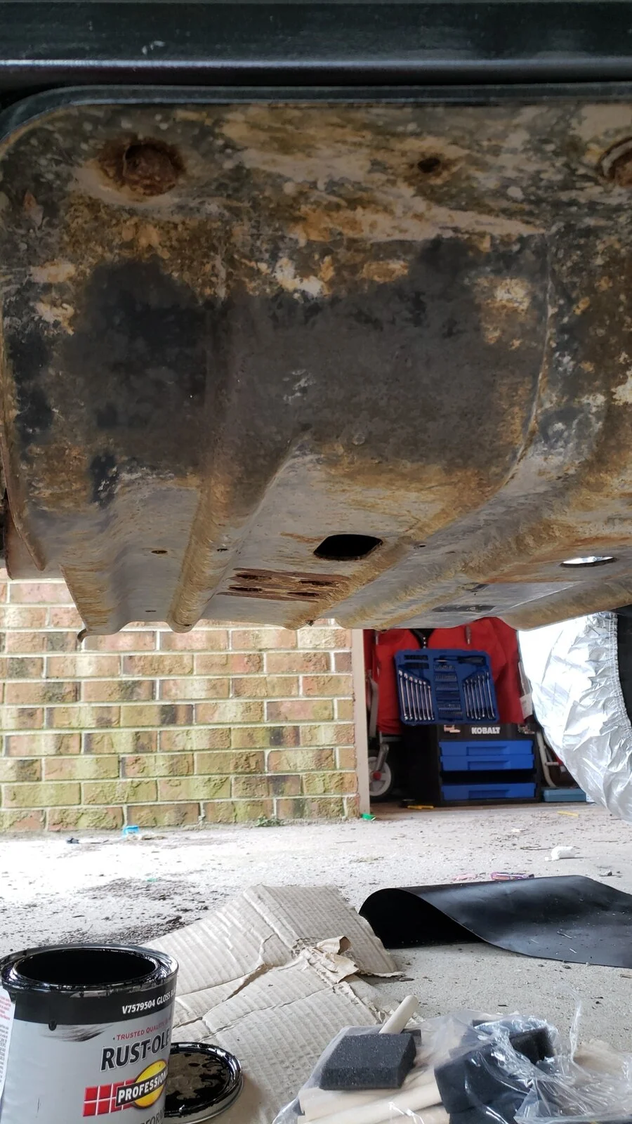

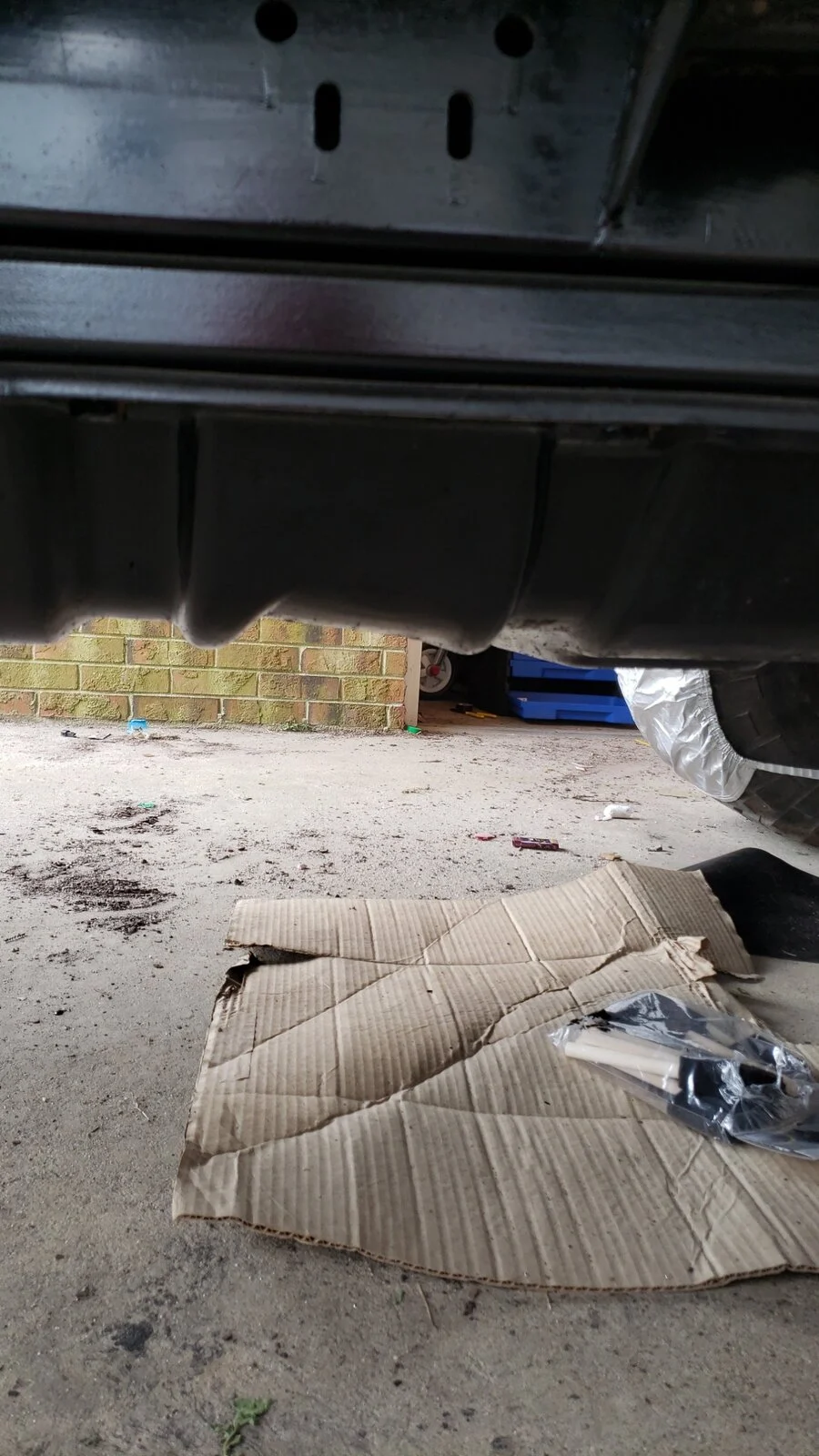

Cleaned and painted (most of) frame and skid plate. Not real concerned with the rust on the plate, this will be updated eventually as the build continues. The paint was cheap so I figured I would give it a go. This is on a 2004, gave it a brand new look and didn't take much time.

Next you gotta get rid of that TC drop. :)

Very nice job. Give me your location and I will drop my Jeep off so you can do mine. I will pay you.

Lol I'm just excited "TheBoogieman" responded to one of my post! I'm in eastern NC not real far from the coast so the rust struggle is real but I was impressed with this paint, time will tell how it holds up.

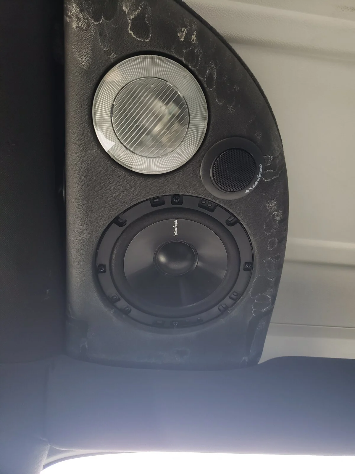

I've been tinkering with the stereo in my 2004 kermit. About 6 months ago I purchased some MTX terminator 4x6 up front and 5.25s for the rear. I blew the rears already! Lack of bass and shrill highs made me adjust the bass too high on my head unit and kill the surrounds.
Last week I ordered some prime 6.5" RF components, fiber fill and closed cell foam baffles for the rear speaker pods. View attachment 234365

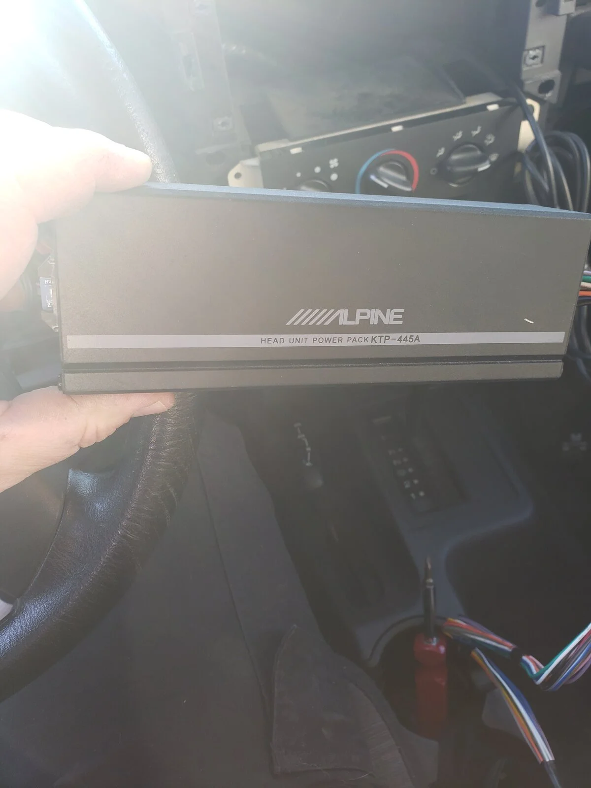

I apologize for the condensation as spring time in PA has it raining in my jeep with condensation! Anyways, I then wanted to make sure the speakers weren't working against themselves so I then pulled the head unit (installed by previous owner) to check polarity. I found a surprise! Behind the alpine head unit was hiding a little gem of a unit.View attachment 234366
That is a nice little 4 channel amplifier designed to boost the output of the amplifier. I'm wondering if the over excursion of the rear speakers was due to too much powa! I cleaned up the wiring harness and re-installed it on top of the left vent tube under the steering wheel. hopefully this fixes the random rattles behind my dash as the previous owner used double sided tape which doesnt exactly stick anymore. I chose zip ties to attach it to the top side of the vent tube. Next week will be a good week for further improving the TJ's interior. Im adding storage and a little sound deadener (by design) to the rear cargo area.
I had one of those in my JKU and it was great for the overhead speakers. I left the Alpine booster at a flat level, and used the head unit for the sound tweaking. Match your polarity correctly and you should be good.

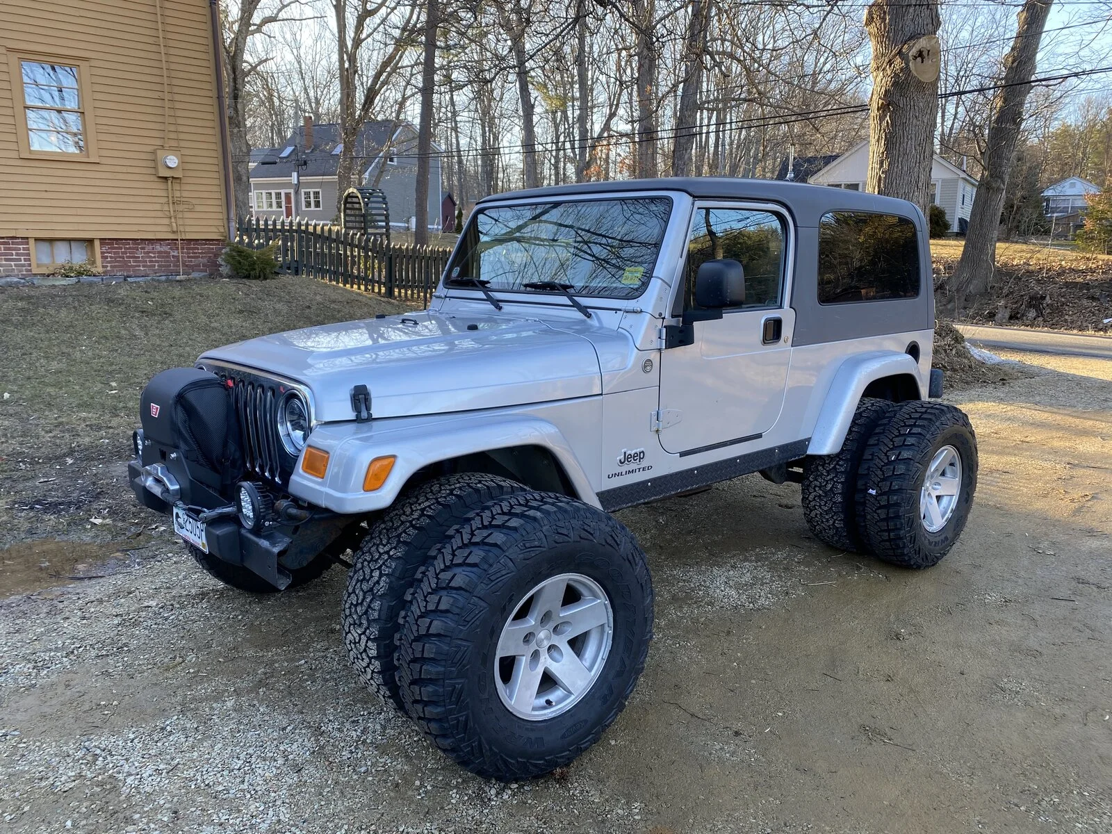

My first look at this picture and I thought "wow, someone is doing dually on a Jeep. That's weird, but COOL!"
If you ever watch Dirt Every Day on Motor Trend, they tried to make their TJ Tub Sock float by adding tons of tires to each side. Not the best episode, but it was still pretty funny. It immediately came to mind when I did this.
