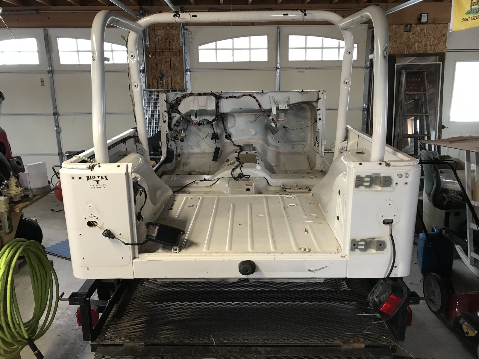

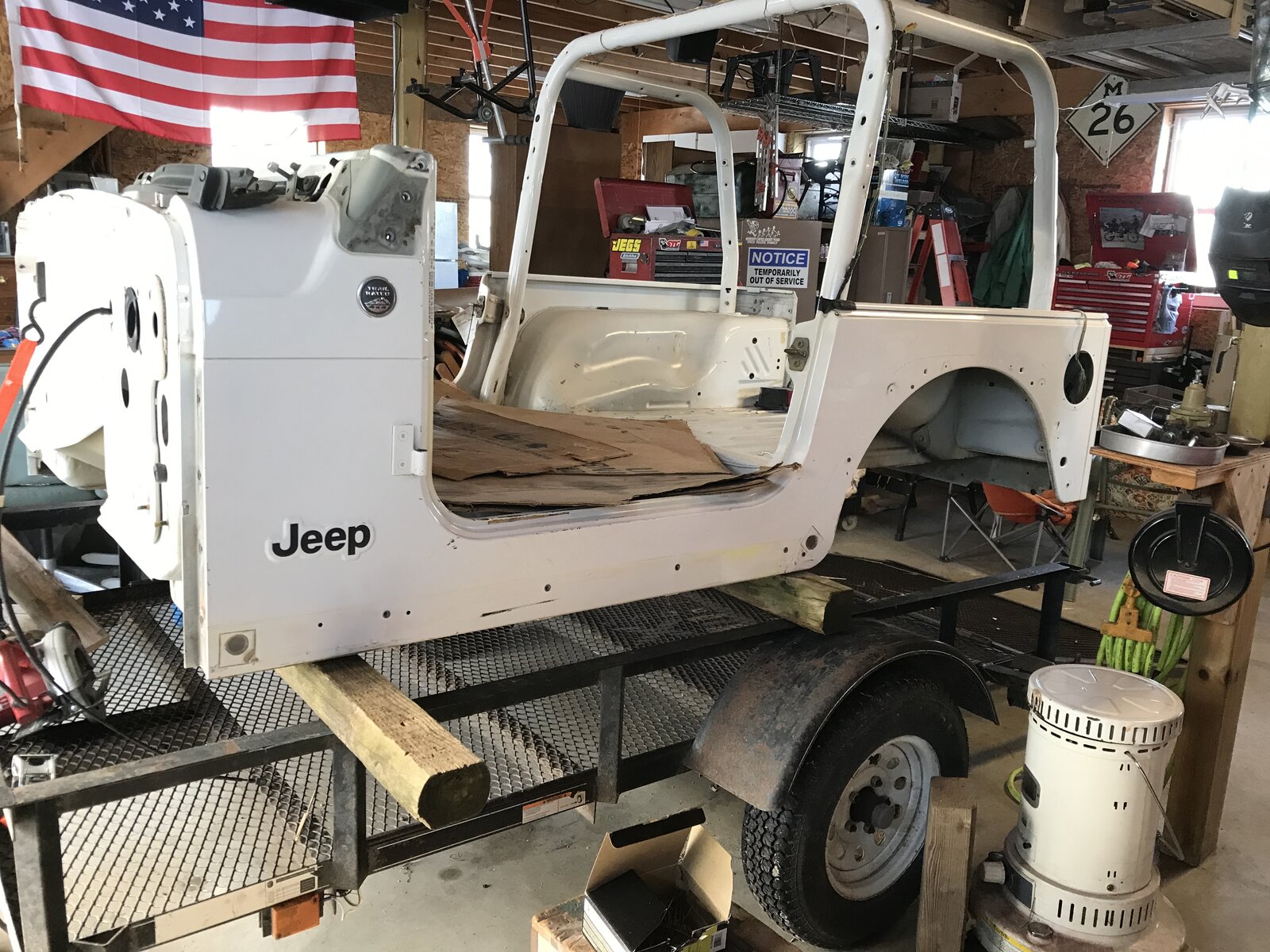

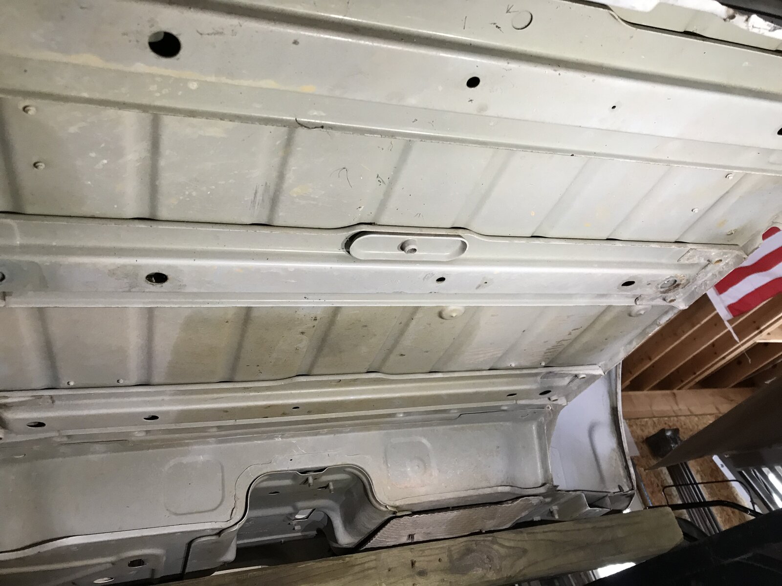

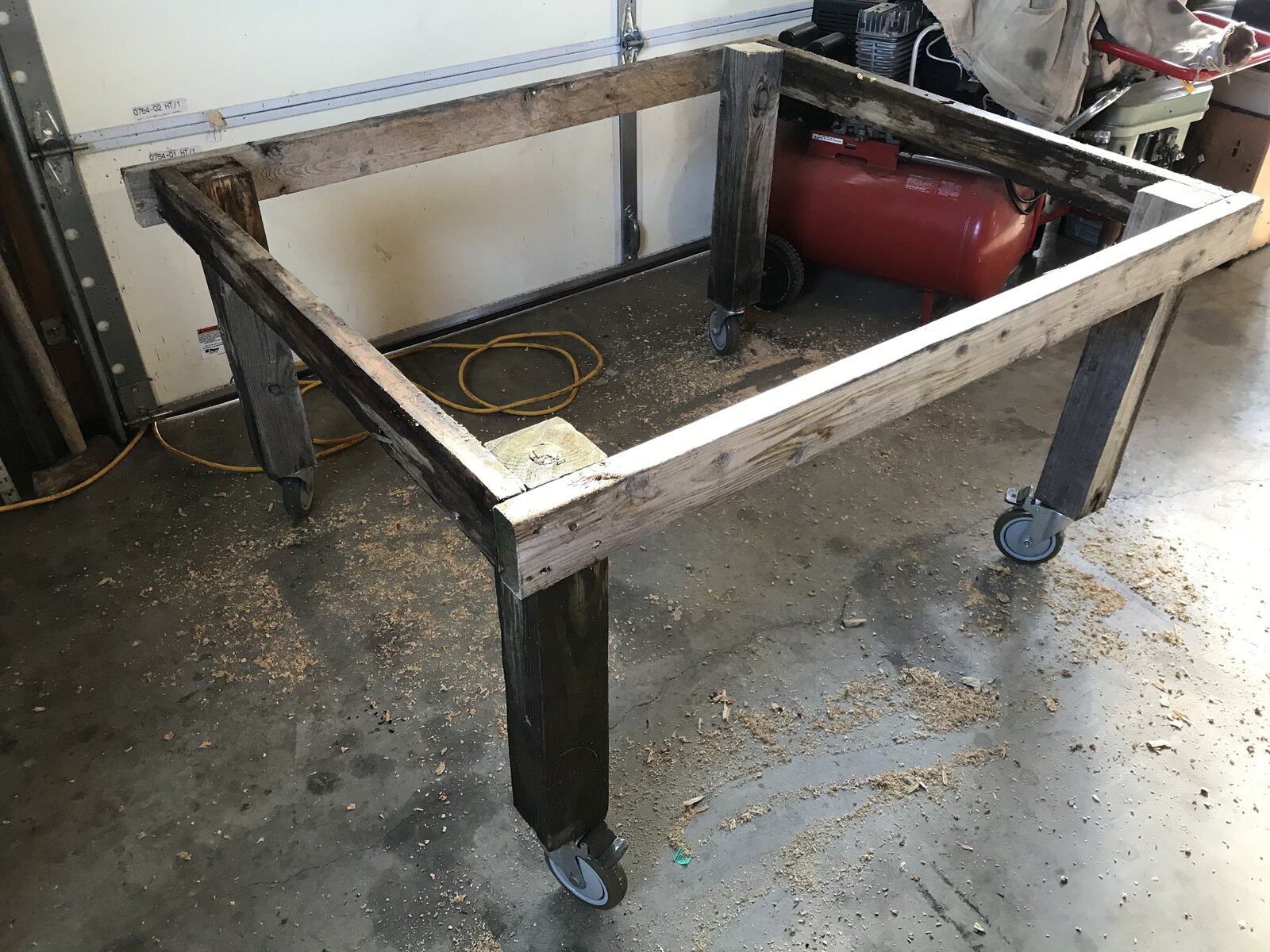

Finished up the body mounts and looked over TFBs new tub.. some comparison pics. And I made a dolly(?) for the new tub…need to add some braces. Fuck rust.
When you said you made ‘a dolly’ …..I thought, wow you must be lonely 😂
Doesn’t look like there was much rust on it !!

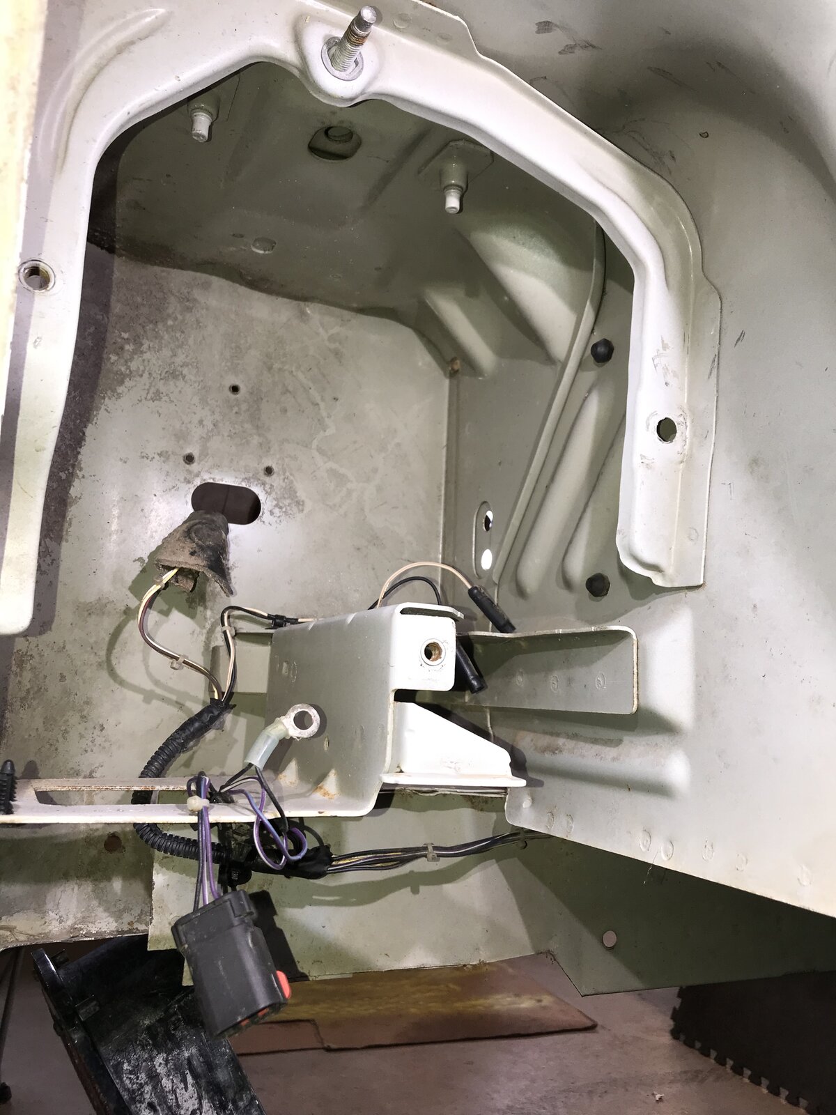

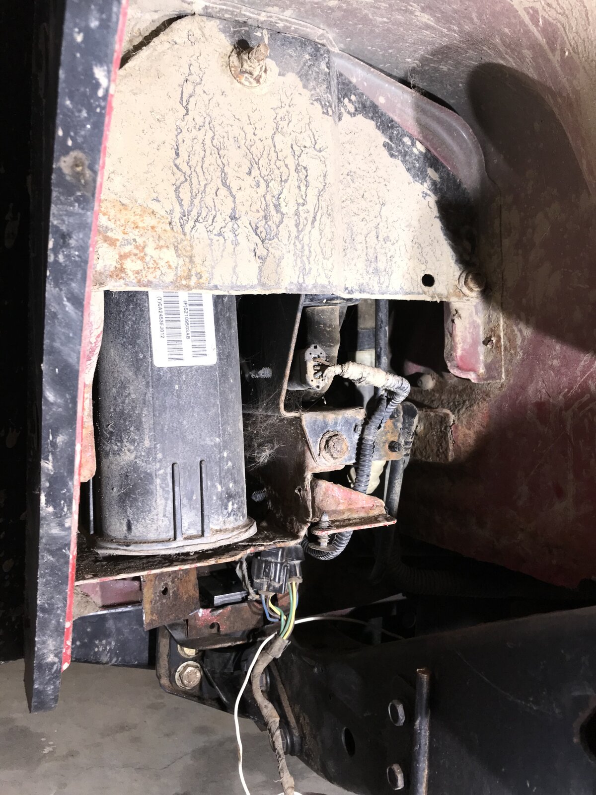

Look closely at the third pic. Though I have seen much worse I don’t even want to try to fix that when shit starts falling apart, hence the new tub. Which is going to be a LOT of work to paint and swap
Reactions: RINC and Kiwi TJ
Are you going to treat the new tub with something to rust resistant it. Like a galvanized paint.
We spec'd industrial paint for water and seawater systems. I don't think you can buy it locally. But if I had a body off frame, I'd do multiple coats of galvinized paint on the bottom.
https://www.valspar-store.com/valspar-anti-rust-galvanized-metal-primer-white-1-qt/
I’ll look into that. I’ve been thinking about what to do underneath, I was gonna clean out and fluid film the inside of the torque box and the rear cross support box(?) and was wondering what else to do. The problem is prepping the bottom for paint. I was gonna let it go as I don’t drive it in the winter.
Reactions: Kiwi TJ

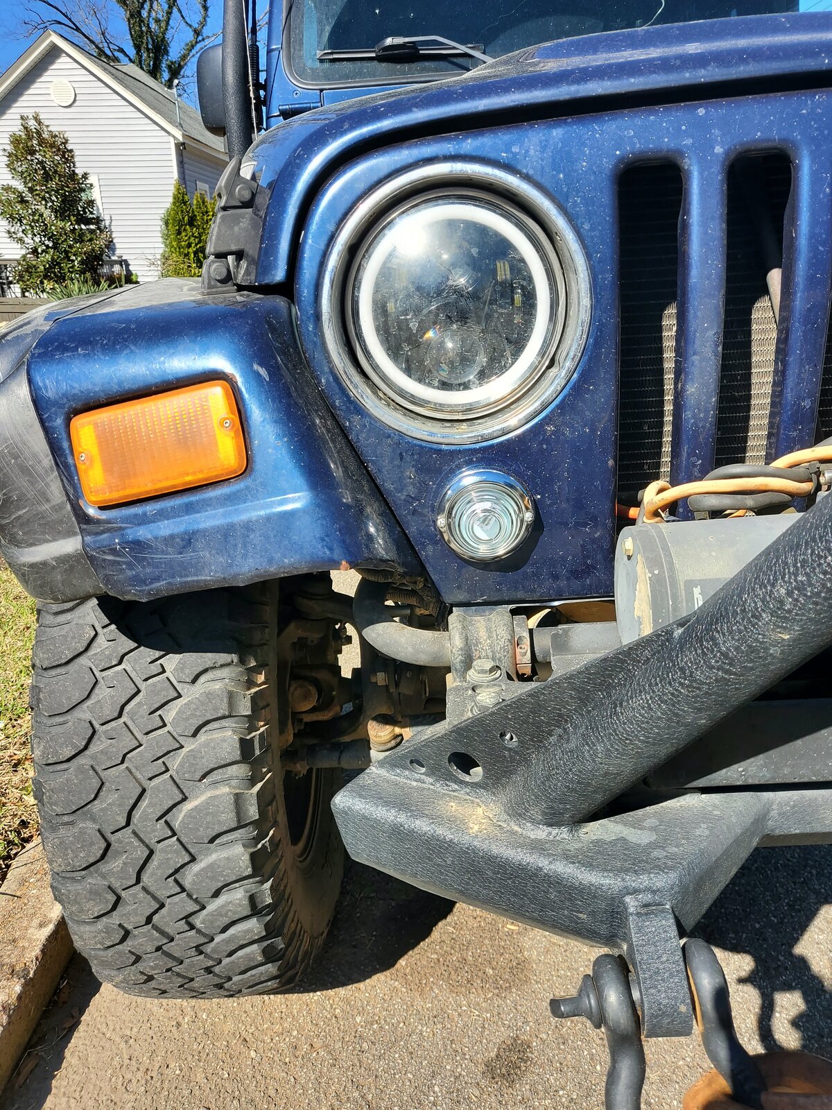

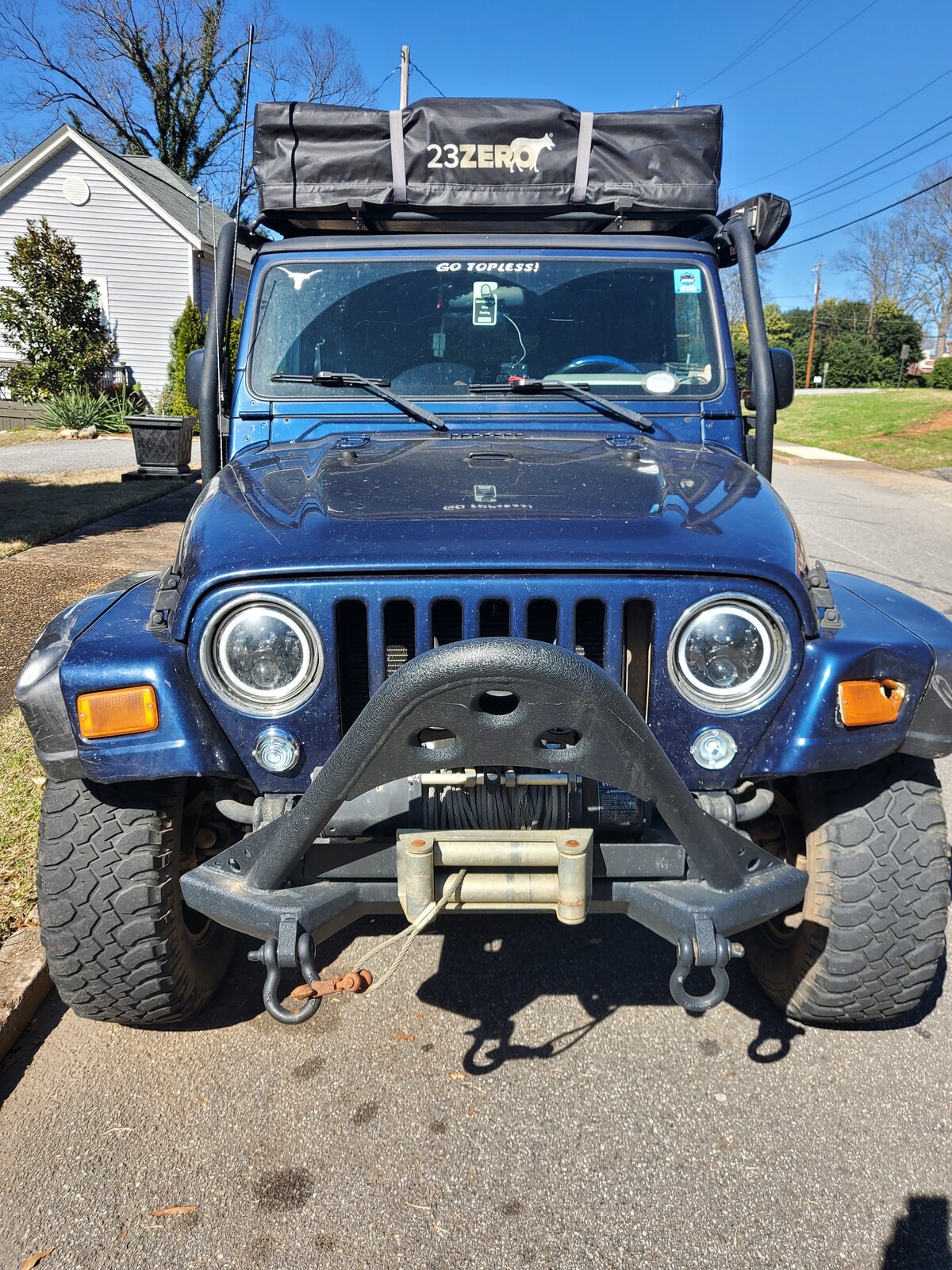

I installed some Willy's blinkers in my grill ahead of my flat fender install. Slow but successful until the very last step. I was buttoning up everything and dropped the glass lens and it shattered. Now I have to wait for a replacement. Good news is that I got my internal winch controls wired up correctly. Take the good with the bad.
