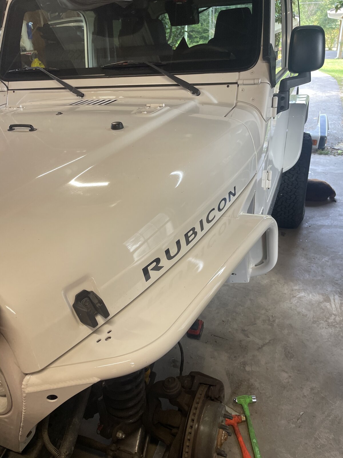

Fenders dry fit
Then we wire brushed at any seams and cleaned and gound/deburred edges-
Then POR 15 on all bare metal
Next we will strategically use urethane as we assemble to reduce noise, mud and at the same time allow water to egress where needed-
Then wire in the lights and plug in the led relay, then put on the 12.5 x 33” wheels and beadlocks
Then front bedrug after the tub is cleaned
Love those fenders ever since I saw pictures of Plumber1’s Jeep!
Exactly- he inspired this. I even have a pic saved as a reference -
He killed it and wheeled it.
Just always seemed he had vision, and I respect accomplished tradesmen immensely.

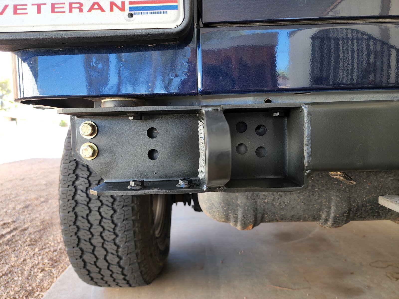

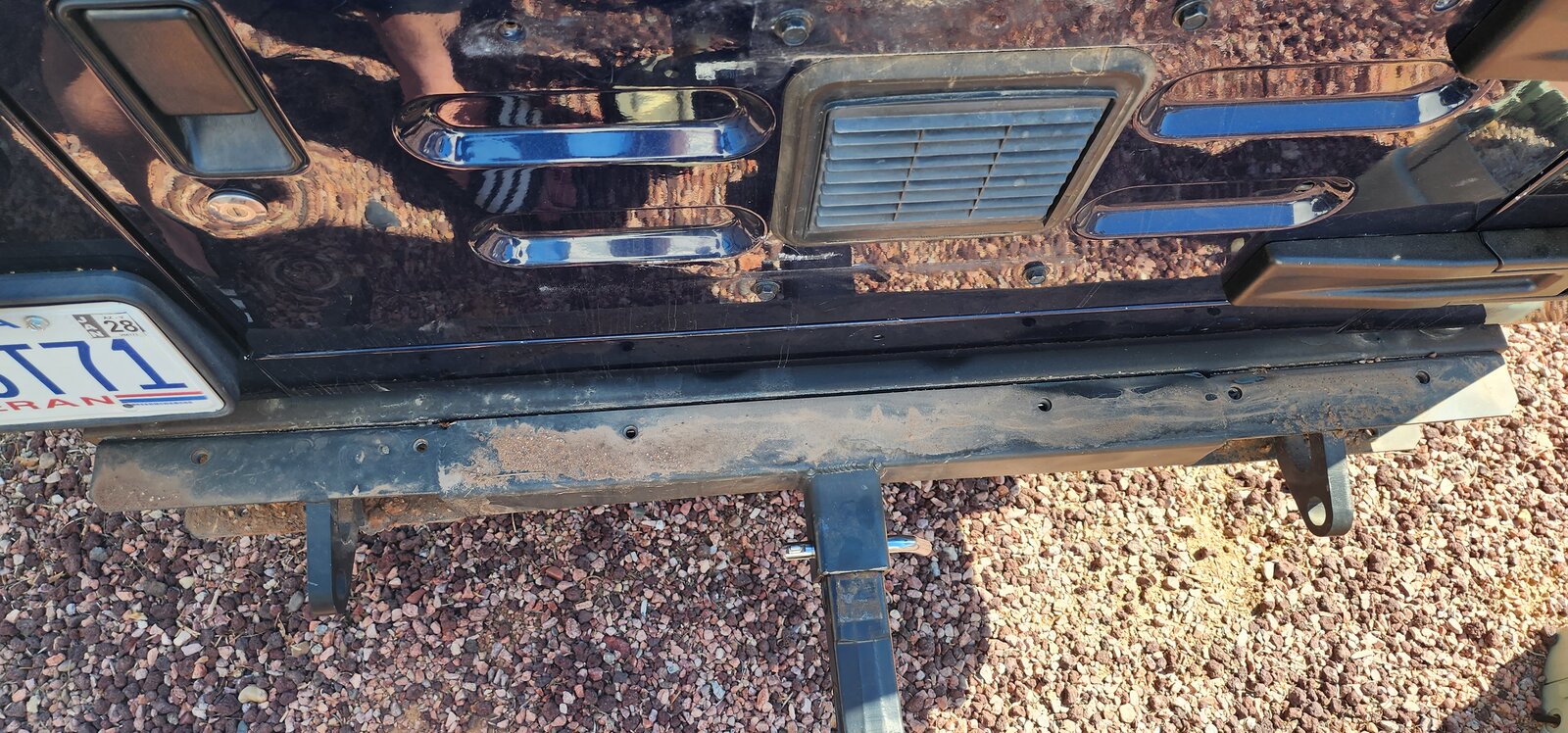

Lowered my small travel trailer onto my hitch and noticed I almost tore my bumper clean off.
When installing the UCF aluminum bumper, I inquired about why the holes on the rear crossmember don't seem to line up, and that 4 of them need to be drilled through. I was told that most just drill them through, and that I ought to if the bumper would be used for any serious duty, ie recovery or towing. I decided that was another days work and just mounted the bumper with 4 outside bolts, slapped on the aluminum guard and called it a day.
Fast forward a year, and I've moved into a new house with a tricky RV gate blocked by a green internet box. "I can squeeze that in with the TJ" Art says, confident he's not an idiot. Alas...
Luckily I opted to remove the aluminum guard for clearance around the cities pesky green box. I might not have noticed the bend! I think another issue is the extended shank I have on my weight distribution hitch paired with the shallow receiver was putting a particular wrenching on the entire assembly.
Unfortunately it looks like I'll be drilling my crossmember this weekend! Lol

Be sure to use frame tie in brackets for more strength. That thin crossmember you bolted into won't hold up on its own.

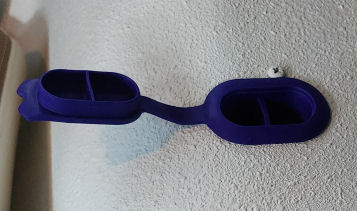

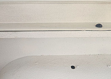

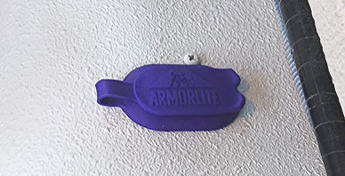

So, I had white bedliner installed in my Jeep a while ago. The plugs above the wheel wells were pretty much rotted out after all these years of having my '97 Wrangler, so I removed them, leaving an unsightly hole in my Wheel Well. Insects started crawling in through there, so I needed a solution. So today, I had Armorlite plugs installed in the two wheel holes inside the Jeep. They are purple, my camera just didn't get the color quite right.
