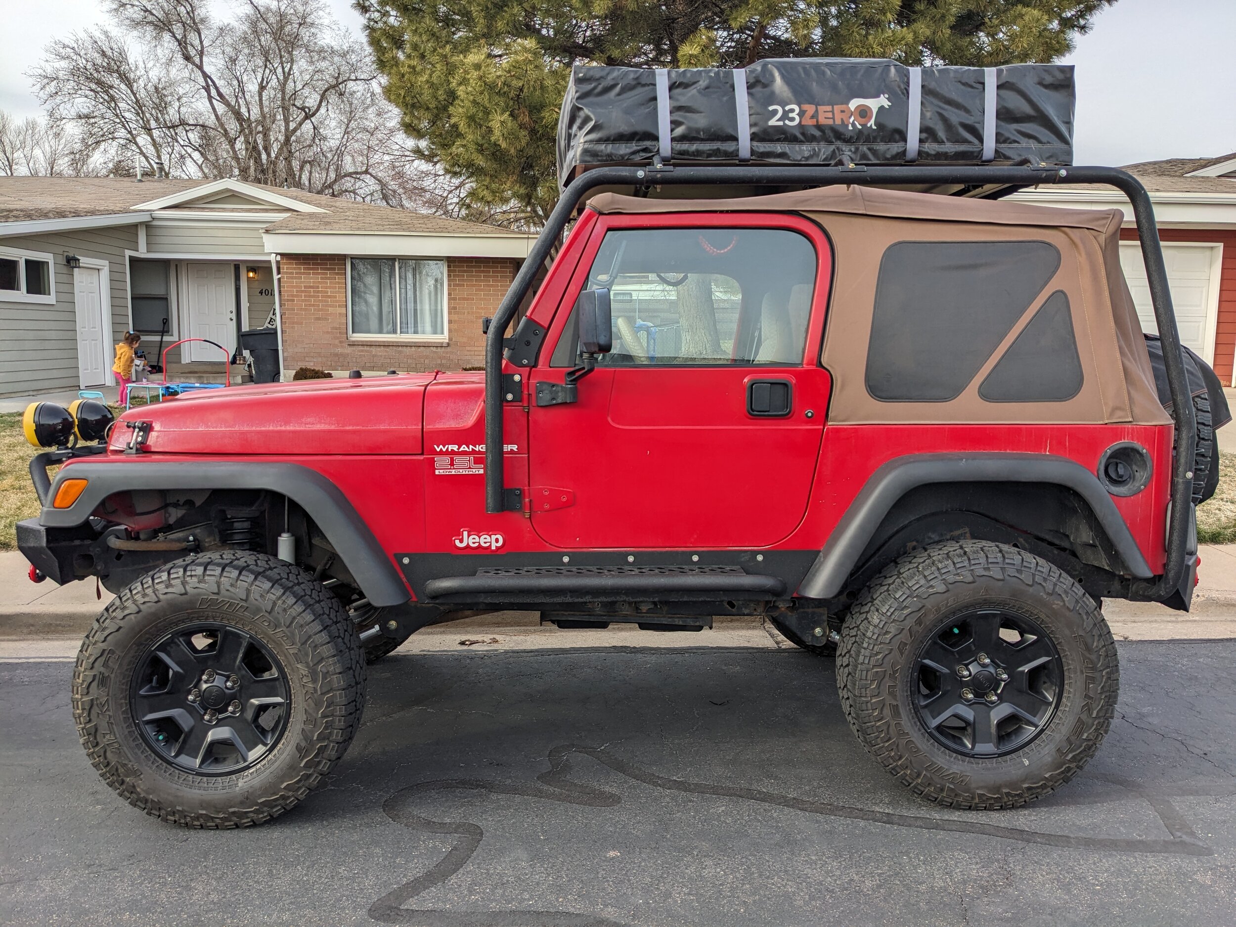

I'll try and be as polite as I can.....
Cough, cough (clears throat) Excuse me, kind sir, some of the members of this fine establishment would really appreciate a well focused 8x4 glossy pic of your new to you acquisition.....otherwise it would seem like this did not take place on said day of your post ......Thanks ever so much.
and welcome to the forum mate ;)
Wow apparently I am a bit rusty at this forum thing and apparently you guys really like pictures to back up statements! I'll get more tomorrow I've been busy unf<]king some things under my LJ.
Played with the rear pinion angle a little and went out to a local ORV park to do some low stress testing. Vibrations on the way there were a bit better, I might raise the angle another .5* or so and see how that does. Made a small sacrifice to the rock pile at the park.
And now I have to go get my tires rebalanced. Might as well do all of them to get the general trail debris out of the bead and get rid of tire caused vibrations.
When I had half doors I wanted full doors… Now that I have full doors I wish I had my half doors back… good looking rig!
I’ve got both and a set of full soft doors now. Traded an extra set of lower half’s that I got with some other stuff from a guy parting a jeep out.
Thanks, it’s slowly getting there.
