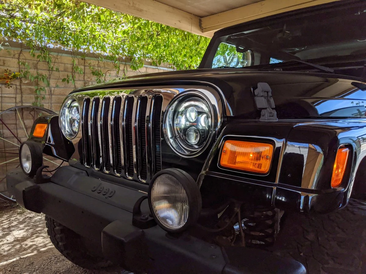

Swapped out the sealed beams for JW Speakers.

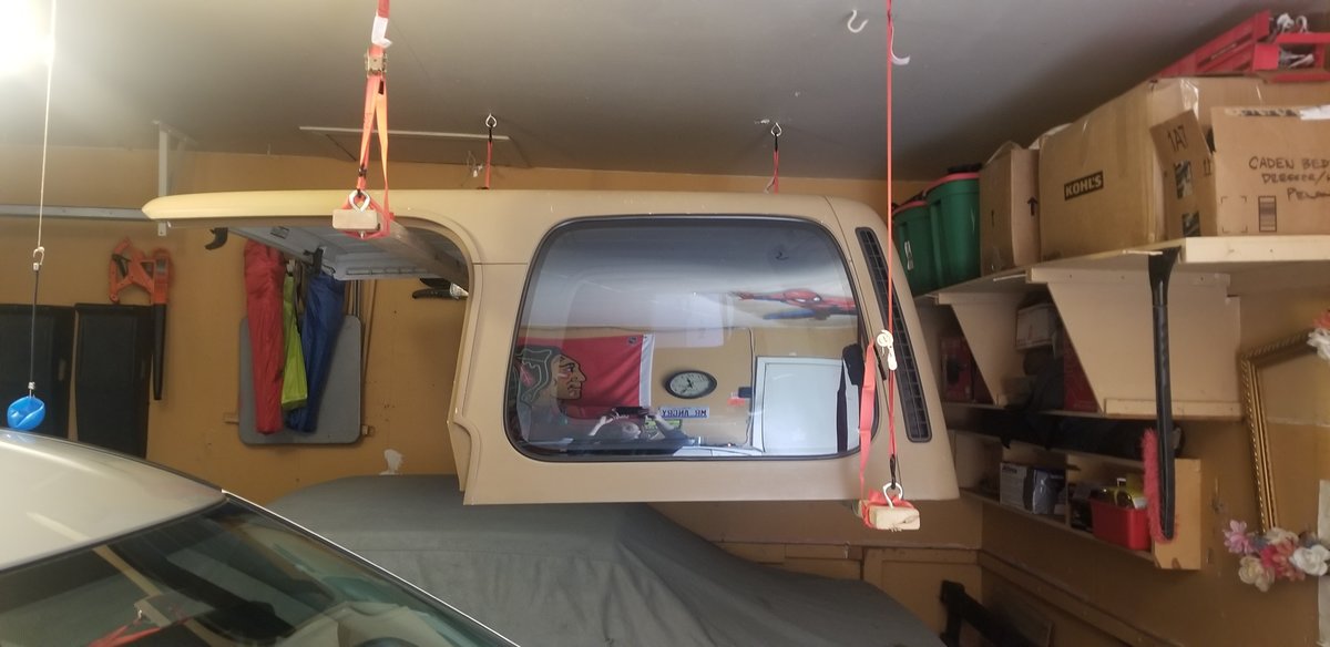

My daughter and I were taking the hard top off, I stumbled, fell, and shattered the rear window. Doh!
So now I'm thinking I may just go with a soft top. Rampage makes a frameless top thats about the same price as replacing the back glass (which I'll do before fall anyway).
I'm debating which way to go at the moment.

I would decide based on the winter where I lived and whether or not I DD it

To bad you're not in California. I have a back glass for a hard top.

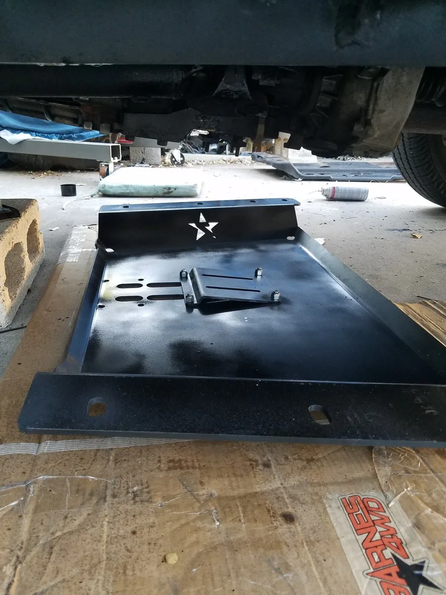

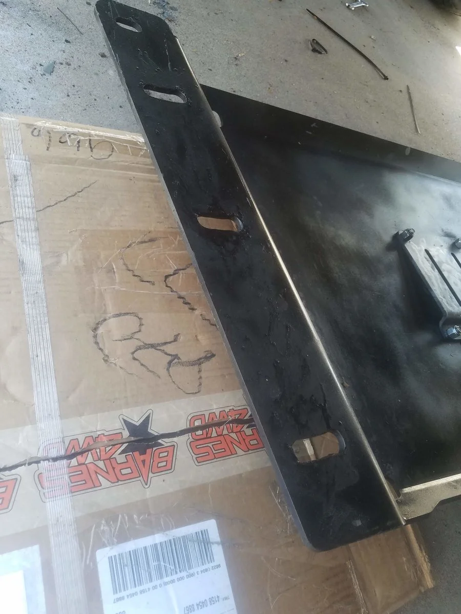

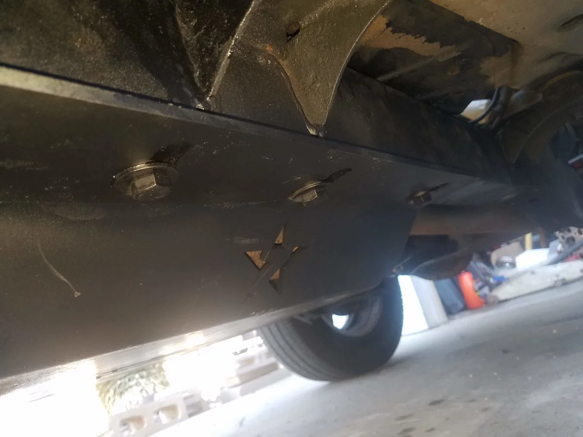

Yes, you noticed that. The PO did the frame repair kit and the holes wouldn't line up, so he welded it on one side. I ordered a Barns4wd.com replacement with elongated holes. That will be next weeks post, or the next, whenever it gets here. I got this jeep pretty cheap at $4700, so I knew some issues were waiting. So far I'm still ahead...for now.
My skid plate came in but the longer holes weren't long enough. I had to add 5/8" more. Then it bolted up just fine. I also noticed that it lifted the transmission up an inch or so. Now I have a vibration at idle. This forum says to get a new trans mount. Ordered the Mopar rubber mount today. The rubber engine mounts seem fine. I hope that's the cause and not the slight tummy tuck.
There is an article online that addresses vibrations caused by the Belly Up Tummy Tuck and Brown Dog Off Road sells a set of 1" engine mounts that are supposed to alleviate the problem.
