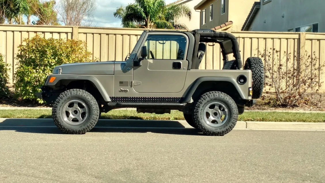

Just fyi, the BDS springs will have about 1" or a touch more rear rake. I used a .75" spacer in front and now it sits about 1/2" high in the rear. Here's a pic for reference...

Rake is the height front to rear, or rear to front, in reference to how the vehicle sits. So, mine is 1/2-5/8" higher in rear than front, measured at frame points to the ground, unloaded. Most seem to like their Jeep level but for me, I load it down when I take it hunting so I like to keep the rear from squatting too much.
Tires are Goodyear Duratac, 31x10.50 15 on a 15x7 wheel with 4" backspace.
