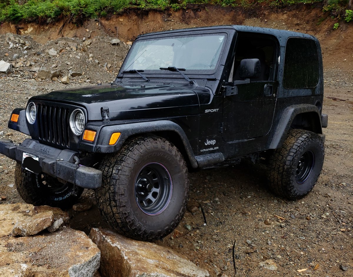

Hi. First time post on the TJ forum, so, thanks for having me and sorry for the long post. I bought my 03 sport back in May and have been lurking here ever since. It is great to have this community as a resource. So, much thanks and much love, as always, to the Jeep community. Previously, I spent most of my time on the KJ forums but rarely posted there as most of the questions I have had, have been asked once or many times before.
I am soliciting some opinions here so any input would be much appreciated. I am having a bit of "well, while you're there…" syndrome in regards to some of the decisions I want to make.
My goal for my TJ is 'highly capable trail' more than rock crawler, I think. I already feel like my TJ is pretty capable. Extremely capable. (I even feel that way with the KJ). I love the TJ.
The TJ seems pretty stock. It has, what looks like, a cheaper, spacer based lift and is running 33's. The only things I have done to it are fluid changes all around and I replaced the LED headlights with some KC H4's. I also added a CB so I could talk to the group out on the trails.

Suspension later. And long term, I have been dreaming of a TDI or 2BT diesel swap. The 4.0l has 195k on it and has been very well taken care of from what I can see. There was one other owner and it looks like this TJ was towed most of it's life. I have an optimistic perception based on what I see that I can probably get another 100k out of this engine. The NV3550 was replaced at 150k, according to the previous owner and it does indeed look newer than the engine and NP231.
I have been hung up on sliders for a while. I have been wishy washy on drilling the body and realized that, because I am not really attacking boulder fields as much as narrow, tree lined trails, I can get away with the Quadratec QRC Rocker Guards, if for nothing else, to push and pivot around those trees.
The decision on the rocker guard/slider has allowed me to start planning the locker upgrade. Originally, I had put Dana 44 on my priority list to replace the Dana 30. I am not sure that is a priority anymore based on what I have read here and what I really want to do. Maybe one day, the TJ will see a Dana 60 front and back upgrade sometime after the diesel, but who knows. Anyway, after some very challenging but convincing trail rides here in the Washington and British Columbia cascades, combined with the aforementioned reading on this forum, I think the Dana 30 is a well enough platform for me to build up to support all future adventures.
