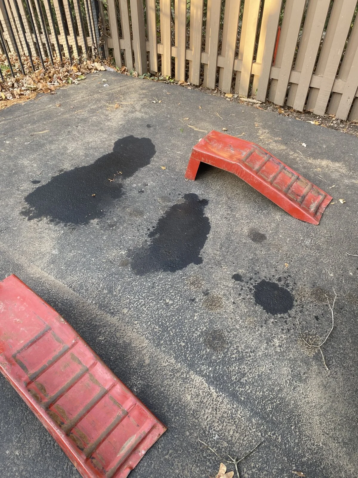

Anywho, not a huge fan of it, so I picked up a new Flowmaster cat-back package. Really looking forward to bolting it on, but figured that while the old one is out and before the new one goes in, it might be an opportunity to do some other fun irresponsible stuff. For example, now that it's getting colder on these Northeast nights, rubber bits and gaskets appear to be contracting and the old girl has moved beyond leaking oil to hemorrhaging oil (this Rorschach is after about a week of sitting - surprisingly, oil level looks ok):
So maybe I replace the oil pan gasket? Maybe I crank down on the valve cover? Definitely replacing the OPSU (my oil pressure gauge is flopping around). But what else? I'm open to suggestions and ideas, assuming a moderate level of mechanical competence and a healthy willingness to break things.

I'd diagnose exactly where the oil is leaking from before throwing parts at it. Definitely check the rear main seal area and rear of the valve cover. Those are two common culprits.

I'll have to get underneath and check out where the oil is coming from - the leak seems to be sporadic, so no regular drip, but sometimes nothing, sometimes lots of things. I was able to get in there and replace the OPSU, and didn't see a lot of oil in the vicinity.
