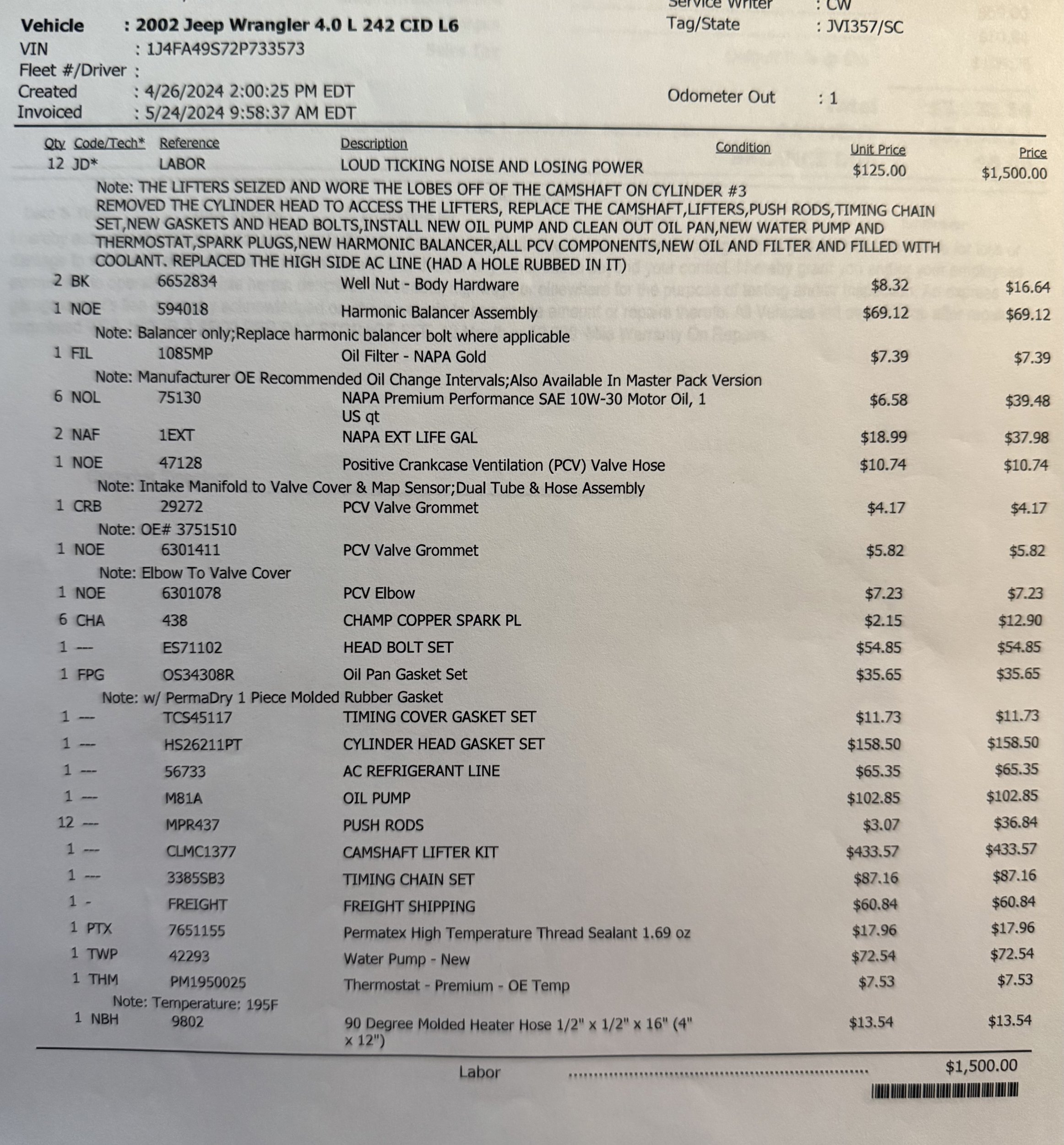

I didn't consider that. The cam on the work order (PO kept all paperwork, so I have a full folder) indicates Melling M-Select CLMC1377 Cam with lifter kit.
Online says it has the same LSA as stock.
I thought the lope might be from bad mounts, so I got a set from Rock auto - nothing special - just the WESTAR ETK100
The link I have for a site with all the stock and aftermarket cam grinds is down, but the LSA and lifts match so I assume duration does as well.
