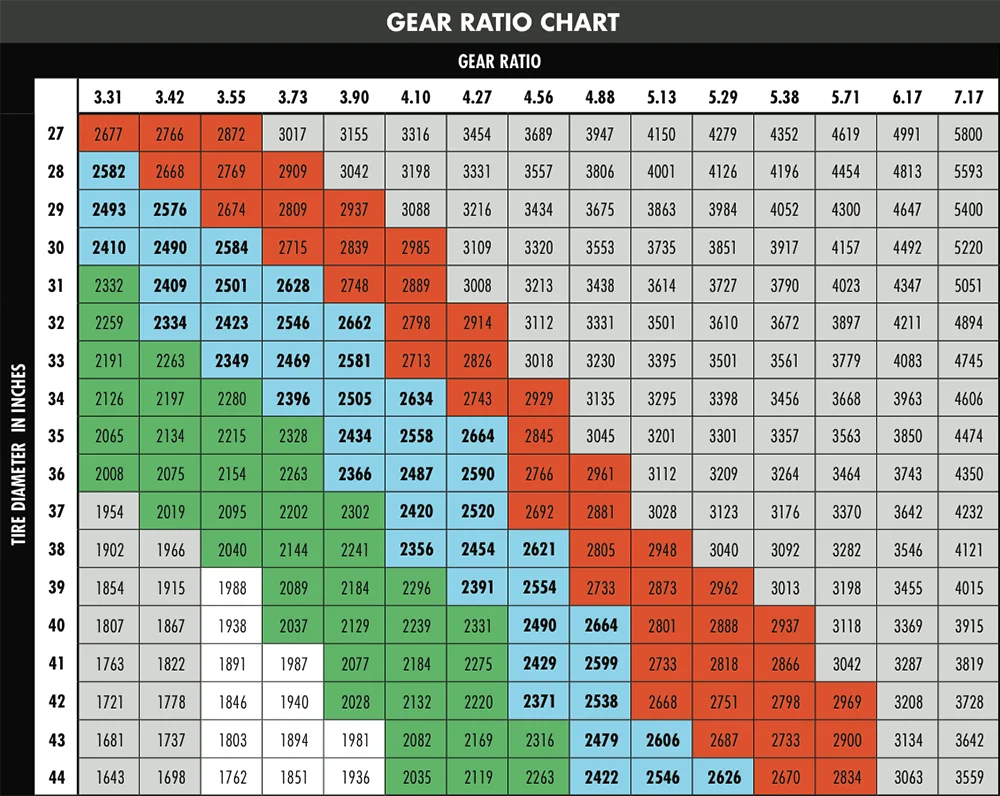

Have you looked at any gear charts? While they're not perfect because they don't factor in terrain and extra tire weight they will accurately show you the factual rpm. That's completely in lieu of terrain and extra weight.
MPH and RPM don't care about terrain and weight.
In your case you're not moving up in tire size so an added tire weight is null.
You are the only one that knows your terrain and if the rpm change will be enough to help you.
The below chart is running at 65 mph. These gear charts are all based on a 1:1 final drive ratio.
Your automatic would mean 3rd gear.
You're running approximately 2546 rpm at 65 mph. Not knowing your exact tire diameter it won't be exactly 2546 rpm but very close.
Again not knowing if you changed your speedo for running 32's over
29"ish stock tires's your speedo will be off a bit.
All that aside the facts remain your 3.73 gears and a true 32" tire will get you 2546 rpm at a true 65 m.p.h. with a 1:1 final drive.
You can just multiply this rpm by .69 and get your rpm in overdrive @65 mph
At present your rpm in overdrive @65 mph will be
at or near 1,750 rpm.
4.56 gears will put your rpm nearly 600 higher at 3112 rpm @65 mph with a 1:1 drive ratio (3rd gear)
In OD youll be at or near
2,148 rpm @65mph
Thats a nice improvement over what you have now.
4.88's in overdrive will get 2298 rpm @65
Weighing all things such as your initial goal here...
I think you'll find a very nice improvement over what you have now in the 4.56. Considering it's a nice upgrade for only $400 per axle.
2,148 rpm @65mph

Using the above gear chart the 42RLE overdrive brings the RPM with 3.73 gearing down to 1813rpm on 31" tires. That's a barely usable gear ratio on flat ground with a tailwind. In 3rd it's a little high 2628rpm but you lose the transmission lockup which hurts fuel economy. Just an inch larger tire 32" tire looks to make the 4th overdrive with lockup mostly unusable. Seems if you care about fuel economy AND performance on 31" tires, 4.56 would be the minimal gearing. Even with the stock 29" tires and 3.73 gearing, rpm at 65 doesn't break through 2,000rpm. Why didn't Jeep use 4.10 gearing with the 42RLE?? That seems the minimum gearing for the dinky stock tires let alone any tire upsize. Looking at the chart now see why people say go all the way to 5.13 if you are thinking of re-gearing with the 42RLE. Appears that stock gearing is designed for the low end grunt of a Diesel not the higher rpm/torque specs. of the 4.0.
