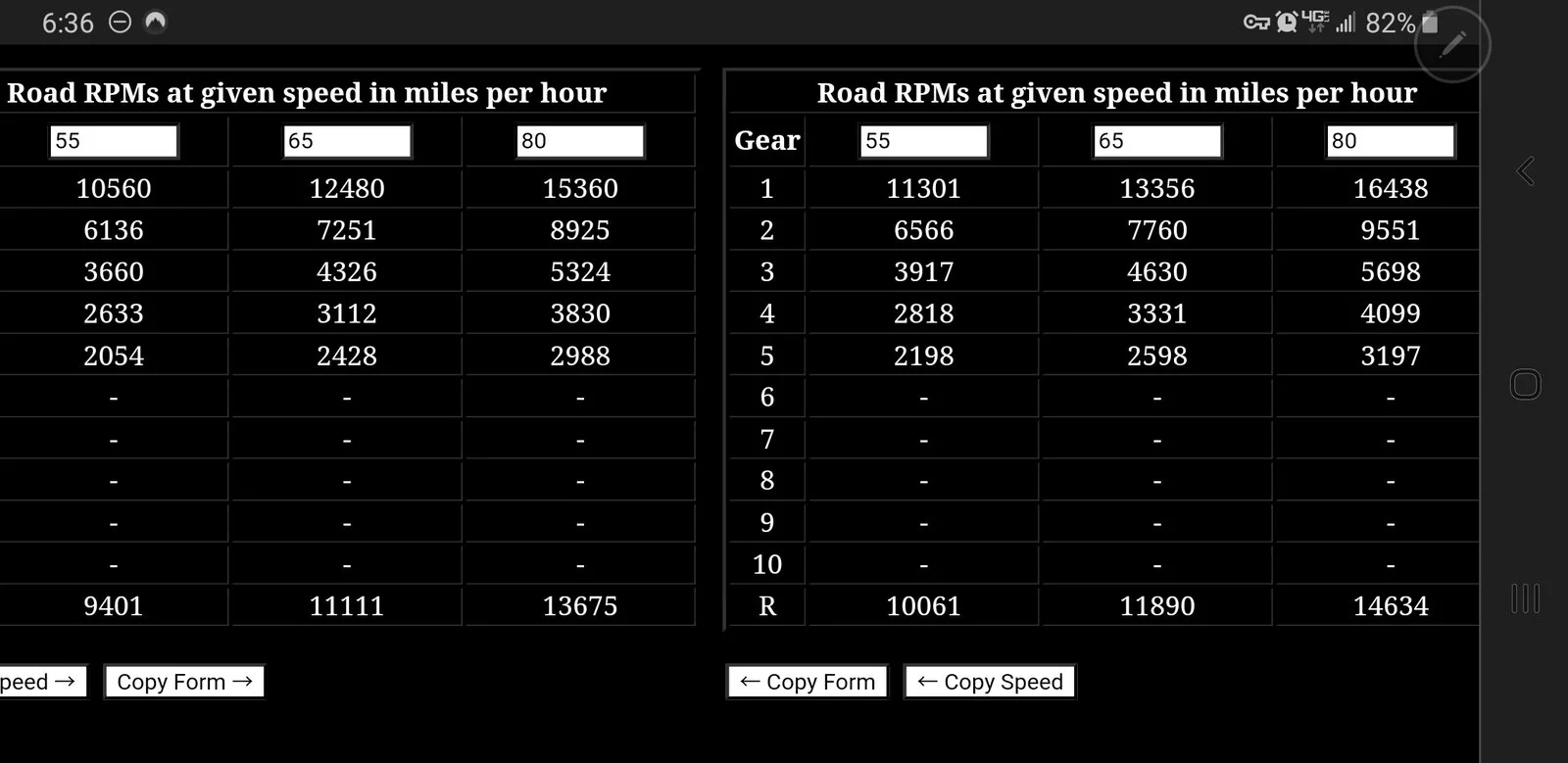

rpm vs mph will be very close to the following:
.............4.56...............................4.88
IMO, 4.56 for flat lands, 4.88 for hills and mountains.
