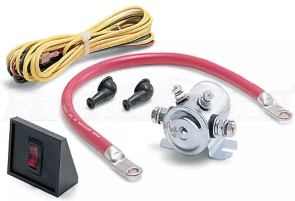

My admittedly un-informed opinion has to do with reliability. A winch is a piece of "emergency gear" and when you need it, its gotta work. That's why I made it very easy to bypass both the solenoid and the fuse on the spot if need be - the best of both worlds. Win-win.

A manual disconnect should be fine as long as its close to the battery and rated for winch current. My M8000 *can* draw up to 450 amps - check yours before speccing parts. I went with the solenoid because I planned an in-cab control panel (subsequently installed), the "arm" toggle turns on the solenoid. If things go to shit, I can bypass the solenoid and/or the fuse (fuse is right ON the battery) and operate with the pigtail remote plugged into the winch directly. If you've ever seen a large gauge wire connected to a low impedance power source shorting out and hopping about, it tends to give you religion! That battery is a very low impedance source, at least for a short time...

This warn kit is what I used-worked out good
