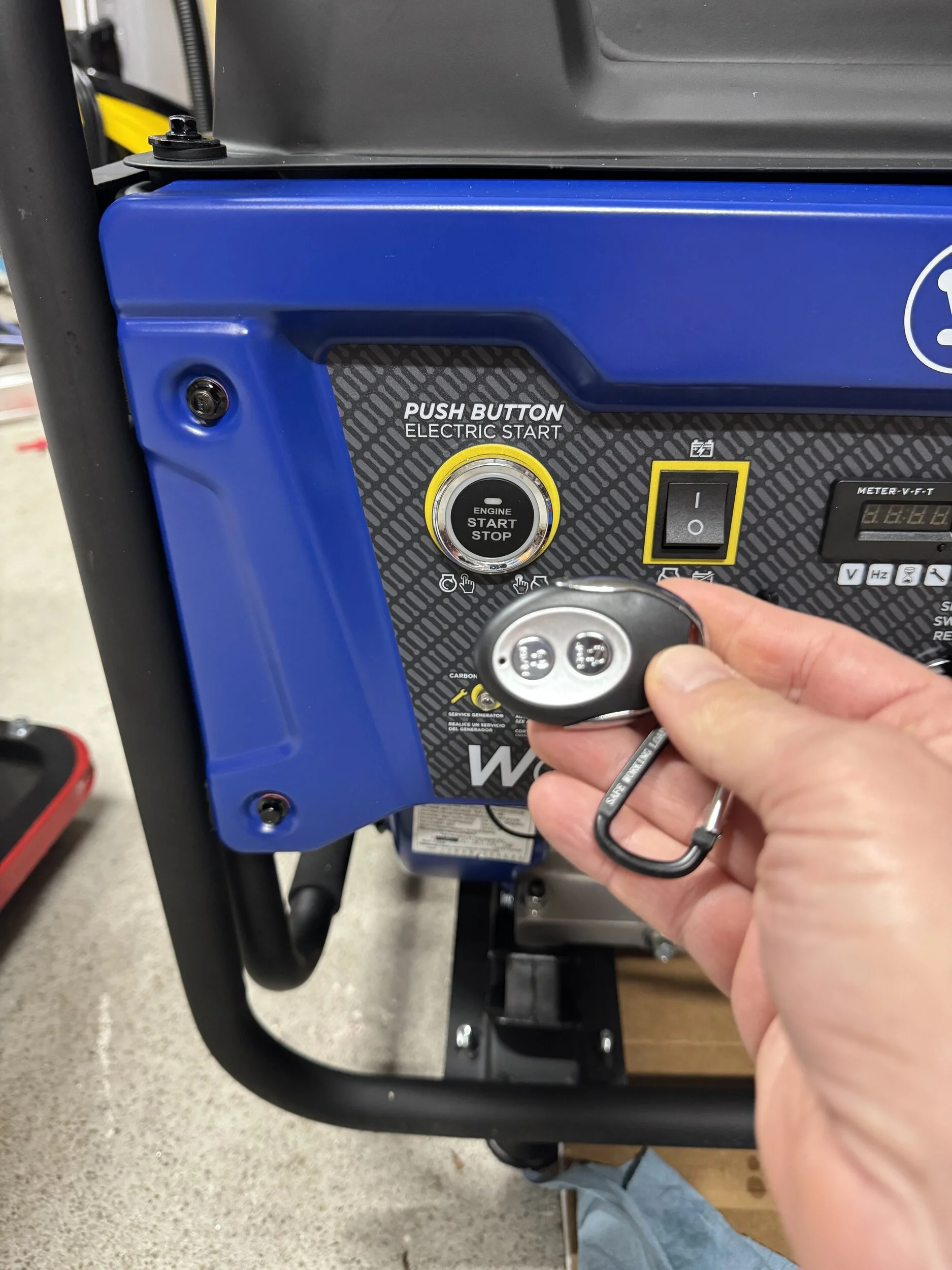

Had some time to spend on my generator project while the kids were on break.
Push start / remote start is nice.

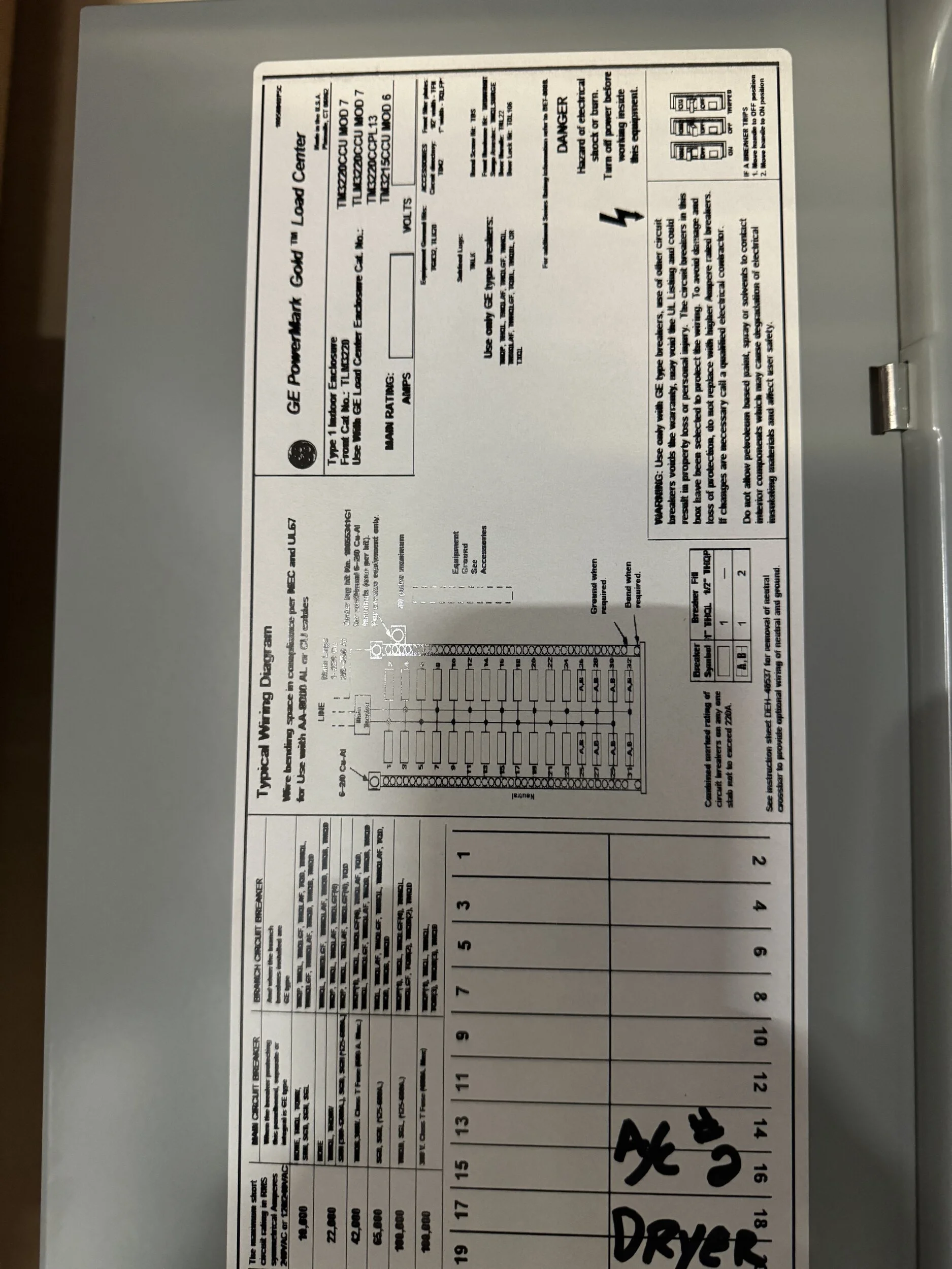

Found the lockout I need for my 150amp panel https://www.amazon.com/dp/B09QKGLYPJ/?tag=wranglerorg-20
And while neither of the two electricians I spoke with can be bothered to put me on their schedule. The last one had what I think is a good idea to save me from needing a transfer switch or sub panel.
Looks like the bottoms 8 breakers have an A/B option
And I can move several low draw loads onto thin breakers GE GIDDS-608007 608007 Single Pole 1/2" Thqp Breaker 20A https://www.amazon.com/dp/B008LYAAUW/?tag=wranglerorg-20
Giving me enough room to move loads down, and free up space for the generator input aligned with the lockout.
Thoughts??

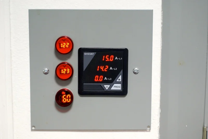

I dunno how I missed this, but here's a pic of my setup:
Fuck any smartphone shit - that's even more amateur hour than this Chinesium crap is. L3 is neutral. There's 3 sense coils that go around the main feeds into the panel which can be glimpsed to the right. Total cost about $50 as I remember. It's "reasonably" accurate as checked with an Amprobe - but for whatever reason, it won't show any currents less than 2.5 amps, hence as seen here the L1/L2 is out of balance by 800 ma, but that doesn't show on the the L3 readout which I'm using for neutral, although I know that's where that current is going.

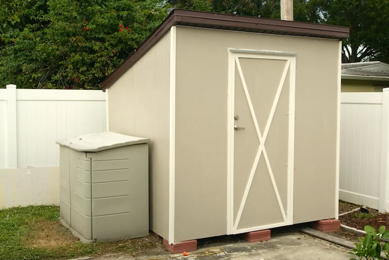

Somewhere earlier in this thread is the shed I built last spring. It sat here all summer without paint or trim, but was otherwise complete as far as the actual building goes. Now that it has FINALLY cooled off, I got the paint, trim, and drip rail on it:
Now I have to just build some shelves inside to call it done-done. Son in law turned me onto some free 1/2 inch OSB for shelves, I went to Homeless Despot to get some 2x4s to frame them up - starting tomorrow.

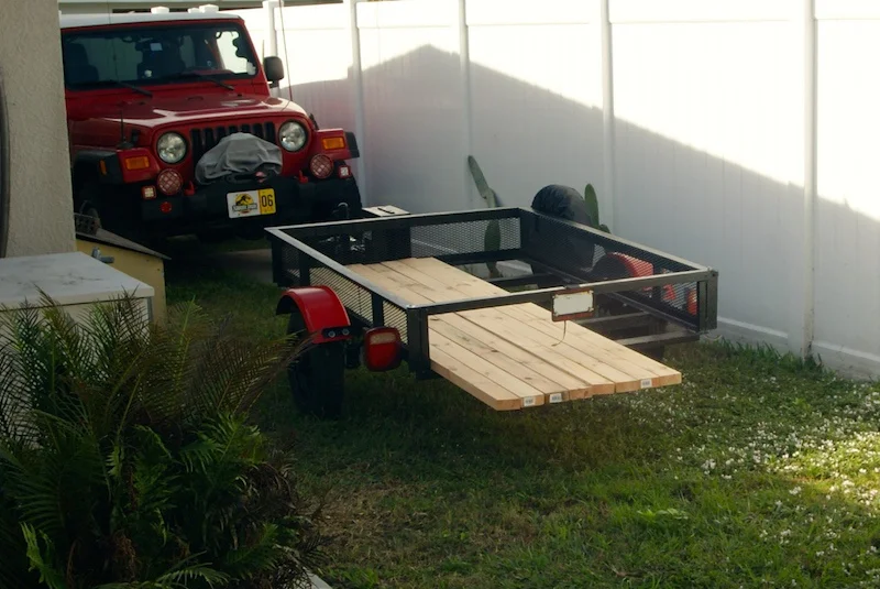

The not quite complete utility trailer makes a good lumber rack for the nonce:

I'm not an electrical engineer so help me understand if possible , since L1 and L2 are different "legs" added together to get 240V at your panel , when would you ever see current on L3 ? Just curious thanks Zorba.
L3 is the neutral. Anything 110v will push current through it. Unless both legs are exactly balanced with 110 volt loads, then no current will go through the neutral - but that's probably TMI.
Reactions: Rickyd and ColoJeep
I get the L3 is a neutral , But since the load on both legs aren't balanced By .8 Amps shouldn't the neutral show a load ?
Maybe 98.4 watts isn't enough load for the Chi - com coils to pick up. Thanks Zorba.
