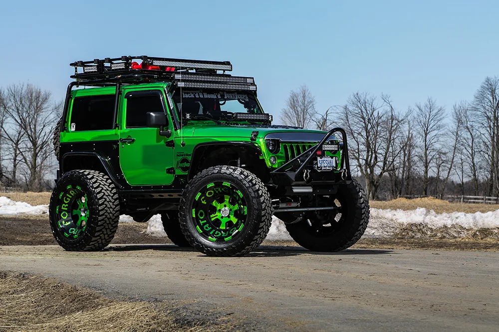

p.s. If you have any extra money, you can get me these for my birthday. 🥳
