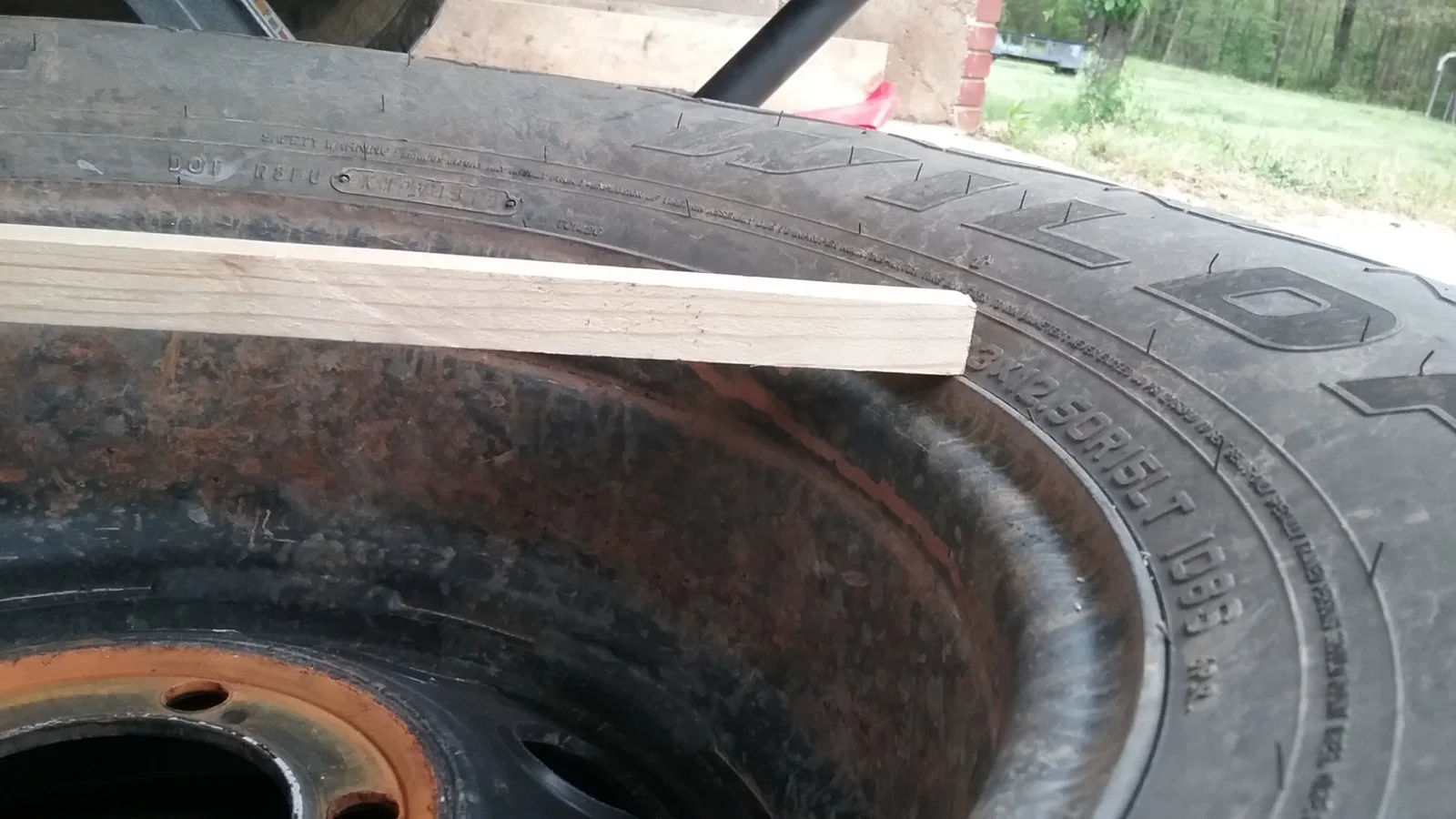

The top. That sounds like a deep groove though. You are measuring from the backside of the rim, right? Just lay a long ruler or piece of wood across the backside of the rim and measure to the center of the wheel, like the earlier posted pic. Grooves and other things unique to various wheels don't count.

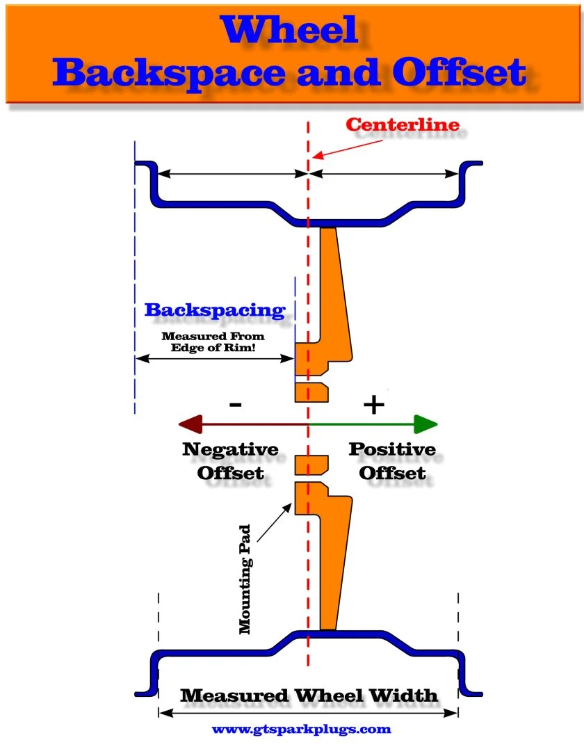

take a look at dimension B and tell me what you think
Yeah, I know, looking at that pic it looks like the groove. But there are lots of pics on the web that differ. I think it's the edge... Might take a look at other pics but this one is clearer...
