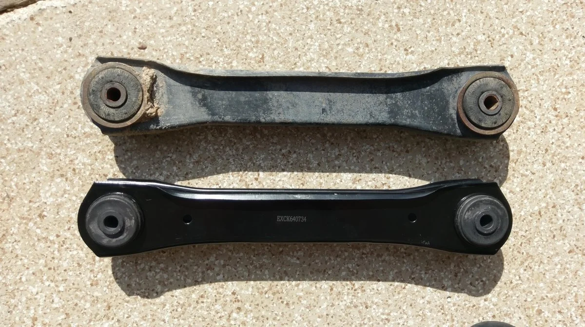

How do I check the control arms to determine if they need replacing?
If the control arm bushings look like the ones on top, they should be replaced. New Moog control arm on the bottom for comparison. (FYI, the Moog control arm is flipped so you're seeing the other side of the bushings.)
Same thing for other bushings, but you can also check if those bushings feel loose by holding them while a friend does some dry steering.
