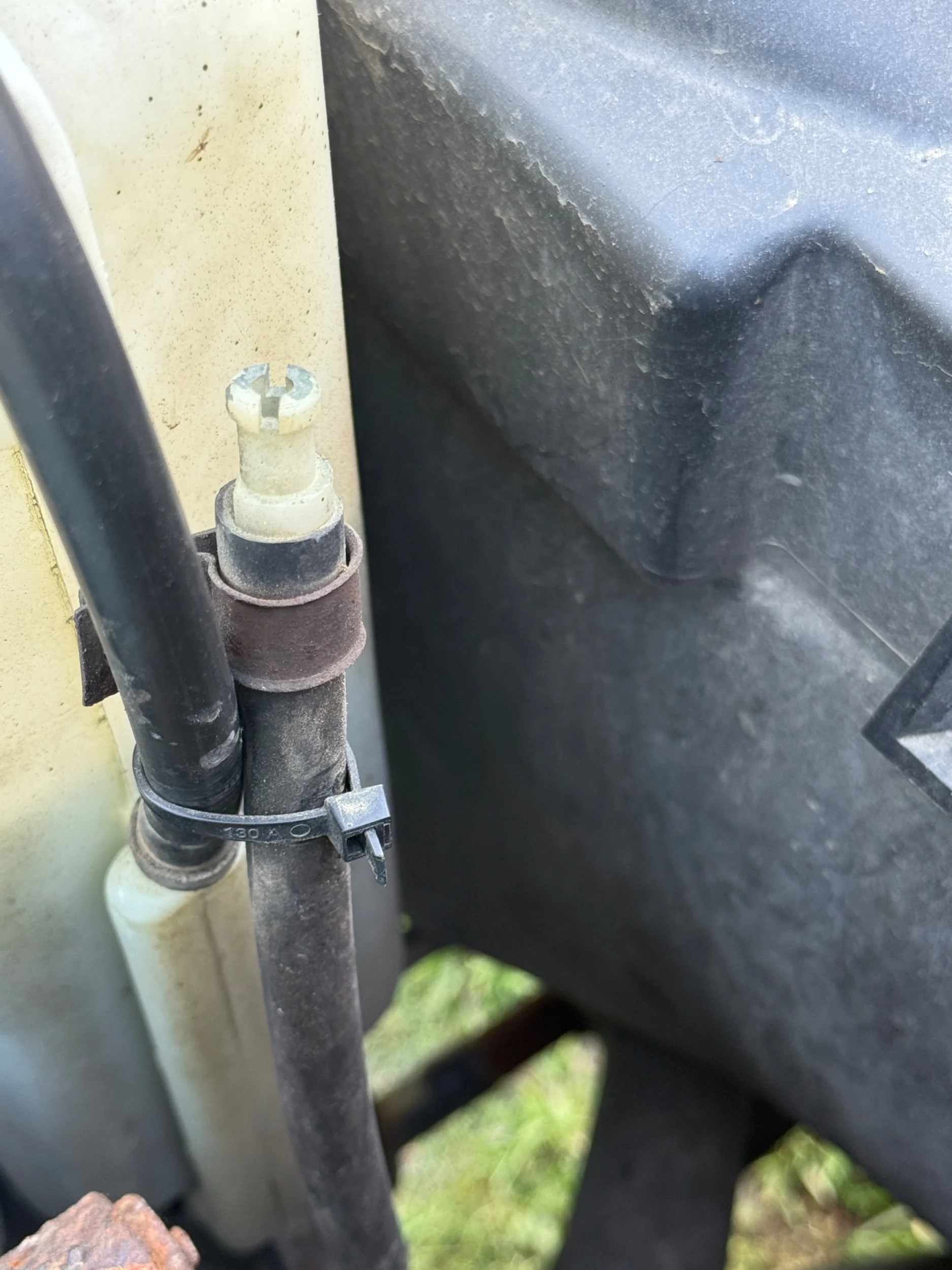

What the heck is this?
Jgedwardsv
Jul 27, 2025
17
Rhode Island
Not sure what it is or where it’s supposed to go, looks like it comes out of the front differential and was zip tied here for some reason.
It's the breather hose coming off your front axle. It's normally clipped to the radiator support. It's up high to help not get water into your axle housing when fording water. If you look at your rear axle you'll find a hose connected that is routed up near the fuel filler hose.
