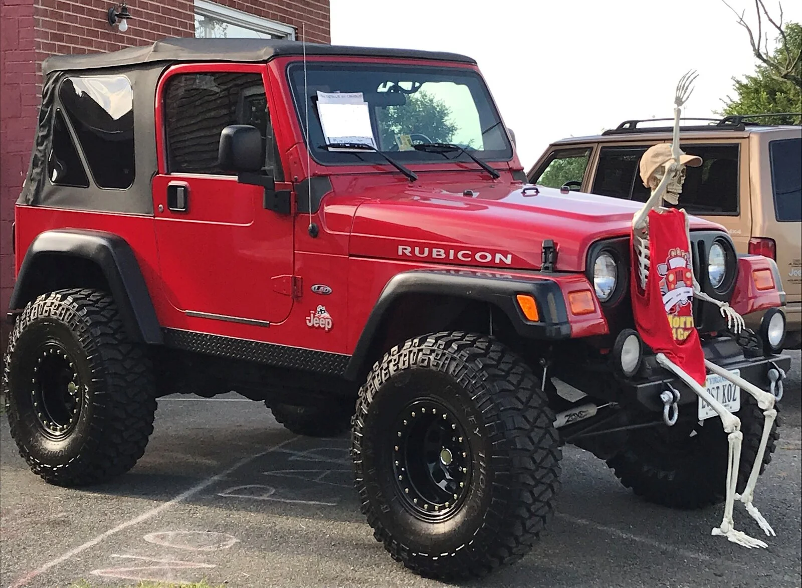

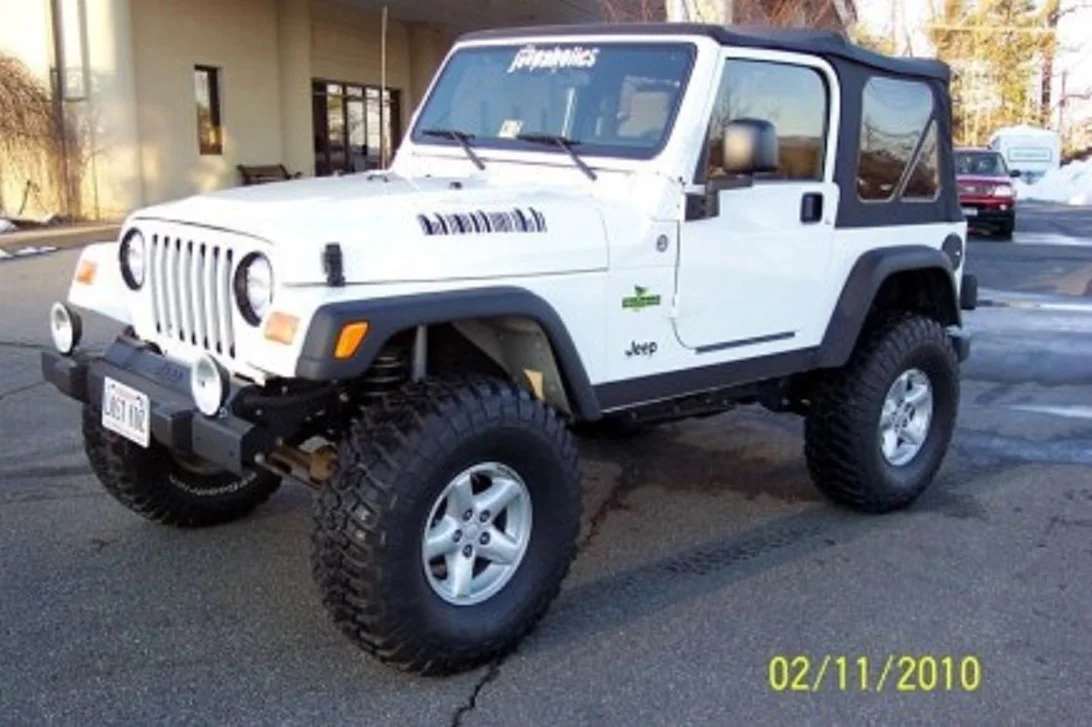

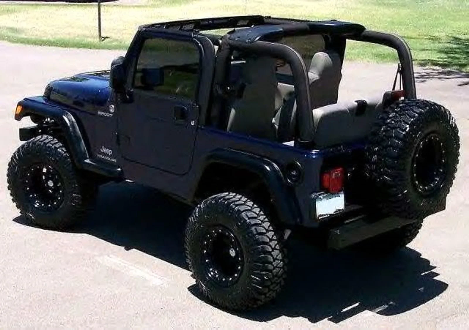

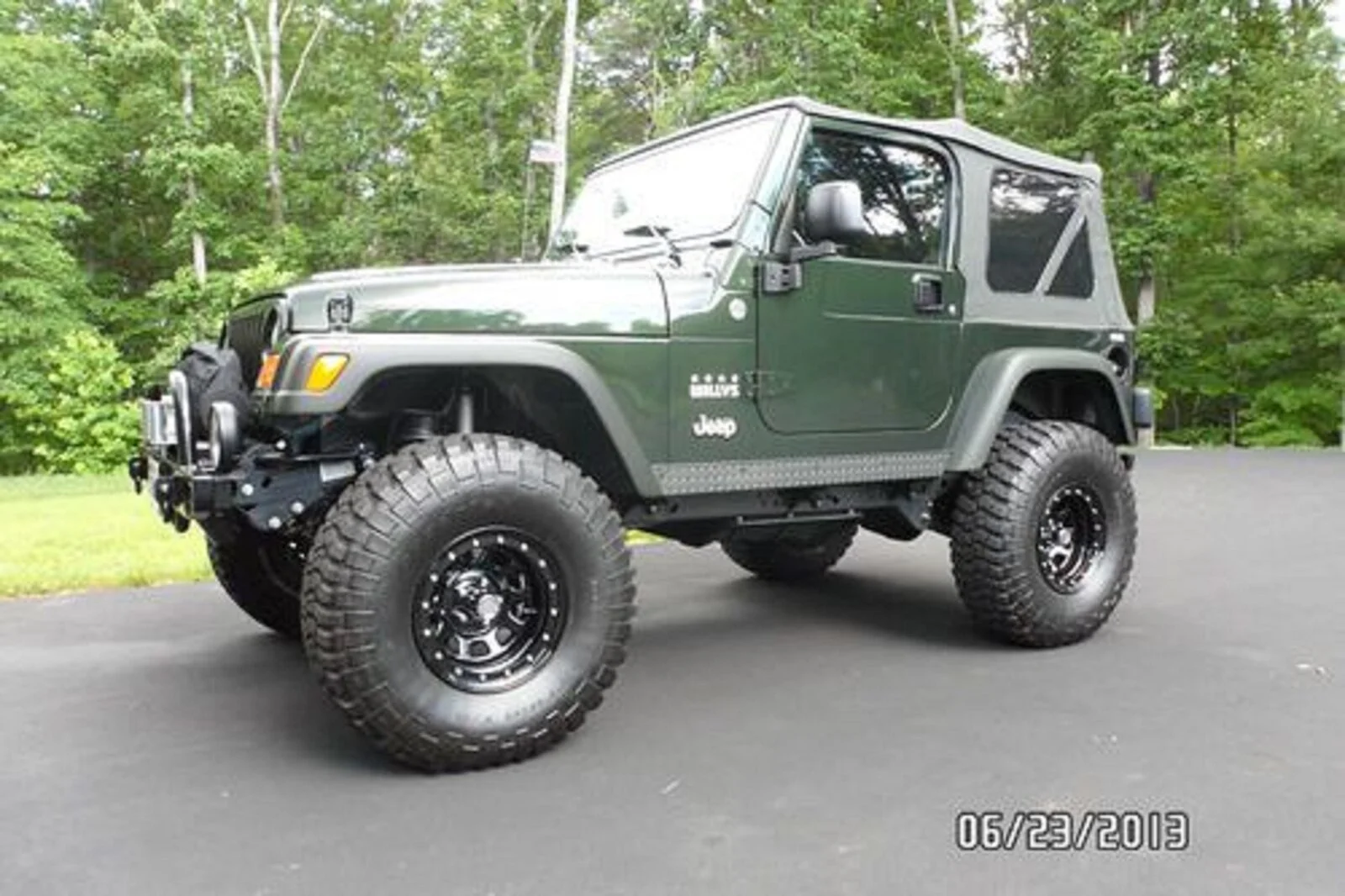

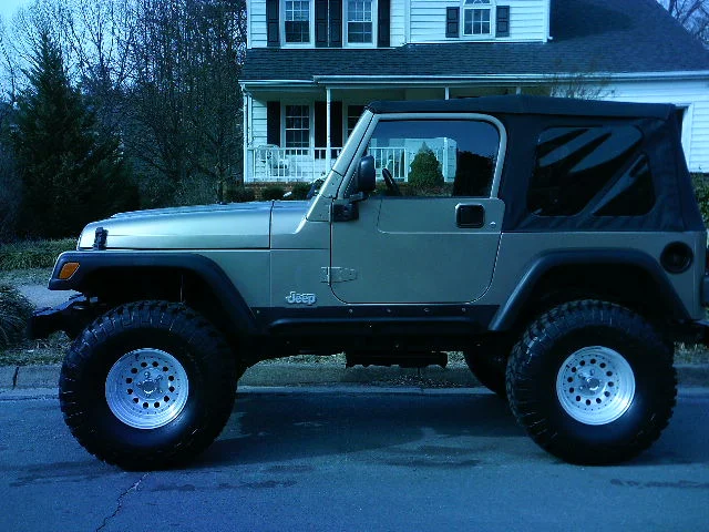

Its NOT my daily driver, I am a weekend warrior like many. I have a 4 inch lift installed with fixed CA and would like to fix vibrations from the lift recently installed. Also recommendations of good wheel/tire combos, going for 33x12.5 tires
For your needs, why not drop down to 3" springs, add a BL and MML and be done with it? Much less expensive and the Jeep will perform the same offroad. I've run that setup on several of my Jeeps, including my Rubicon.
