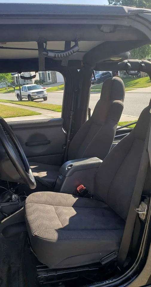

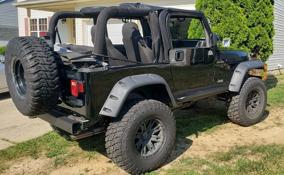

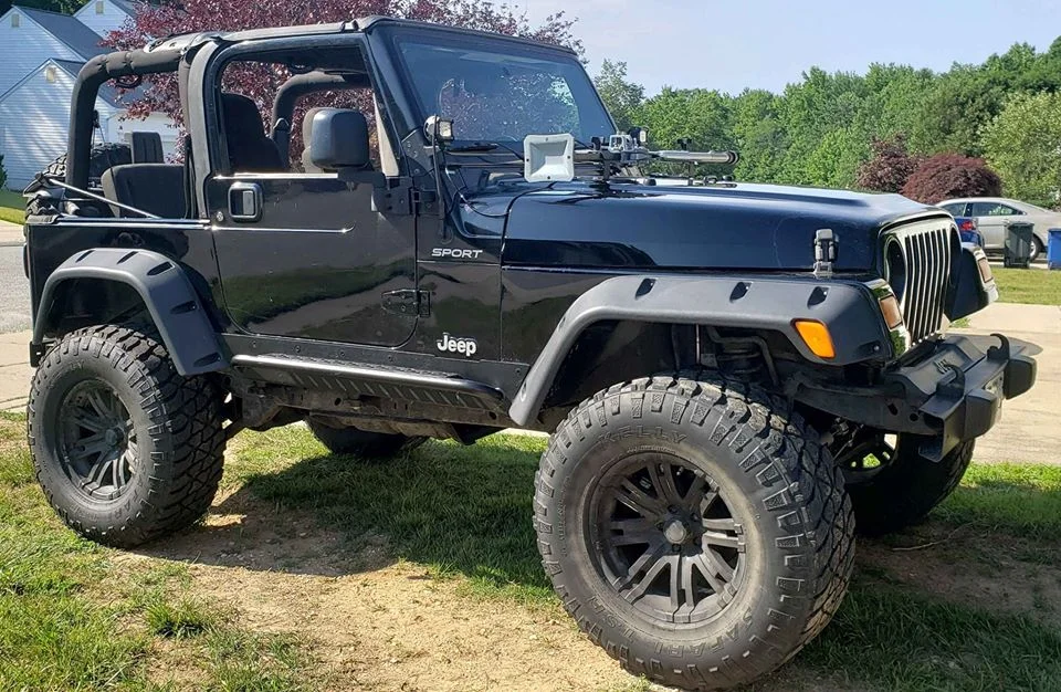

Local TJ for sale, guy wants $7,000. What do you all think? Here is the listing:
Selling my 2005 Jeep Wrangler with 4.0L 6 cylinder engine. Possible open to trades for corvette, truck, rzr, yxz, maybe a boat. -6 speed manual transmission -163xxx miles -4” suspension lift -1.25” body lift -35” tires -1” motor mount lift -SYE -LED headlights -Hi-lift Jack -Kenwood speakers, Tweeters, and subwoofers -Flip up head unit -New transmission floor seal, shift boot and center console -LED pods on windshield pillars -New Y-pipe exhaust from the manifold back -Dynomax cat back exhaust -New spark plugs -New axle seals and bearings in the rear -New Best top bikini top just installed -New in box Trailer hitch receiver Runs great but pops out of 1st gear, you can hold in 1st or start out in 2nd. I am dropping $1500 off for this taking price to $7000 firm. CD player dont work.

Vin number will tell the whole story. @Midtenn raised a good point with the spare tire. It also doesn't have the rubber bumpers on the tailgate so I'd look really close at the tailgate for any cracks.

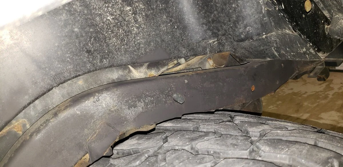

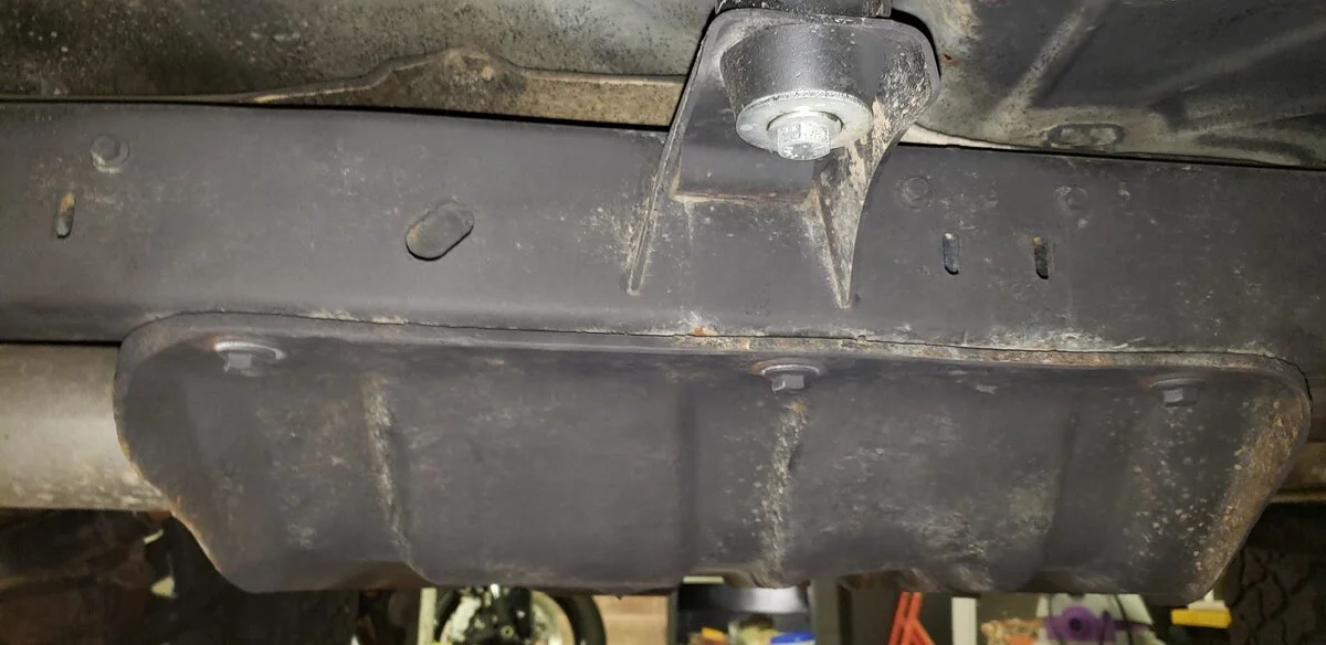

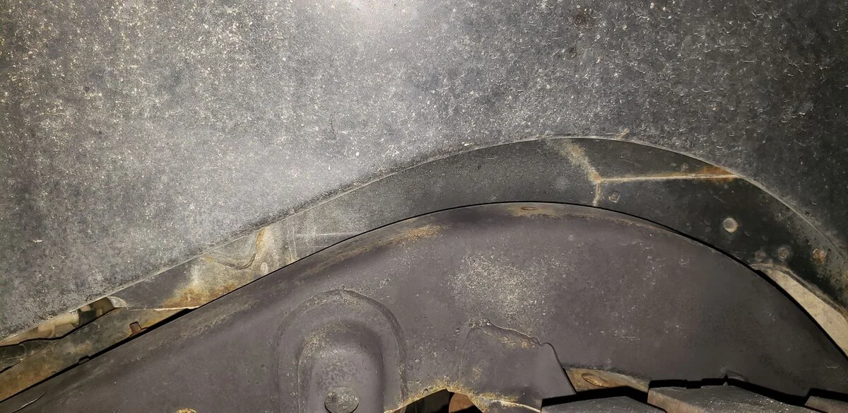

Have you seen it in person? The rust appears to get worse as you get close to the rear bumper. I stand by $7K being a good price but given the option between dealing with rust or buying a new transmission, I'd buying a transmission every day of the week.

Agree, Trans is a fix, Rust is rotten, ha. All can be fixed, but it's just another level to me.

Haven't seen it yet... only about 25 min away, going to drive out there on Friday. Agree with you as well on the rust vs. transmission

I’d say 7 is a bit of a steal, even if you factor in a new trans which will be about 800 if you willing to go AX15, or more if you want the 6 speed, haven’t looked at those. Frame is solid. I would be curious what kind of suspension lift, (Currie teraflex etc) and I’m not to big on those wheels but that’s just me.
